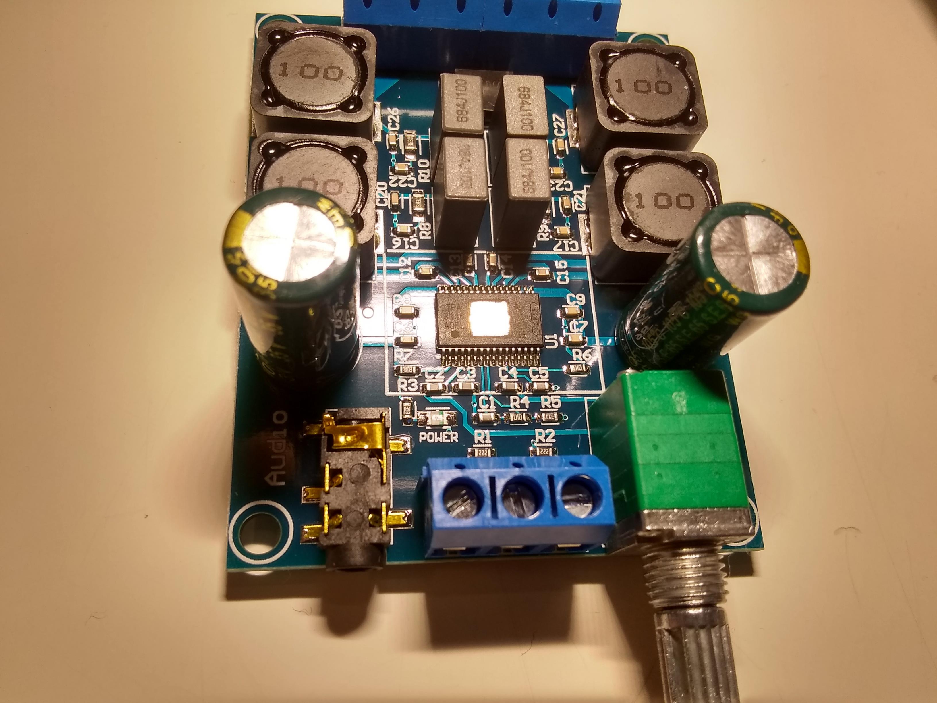

I recently got the board on the left, and I'm also struggling with hissing. I followed the guide on http://www.diybudgetaudio.com/TPA3116.htm . I installed a decoupling cap and two 4.7kOhm resistors over the pot, but I am still experiencing hissing at medium volumes (goes away at full or low volume). Any other things I could try to get rid of the noise?

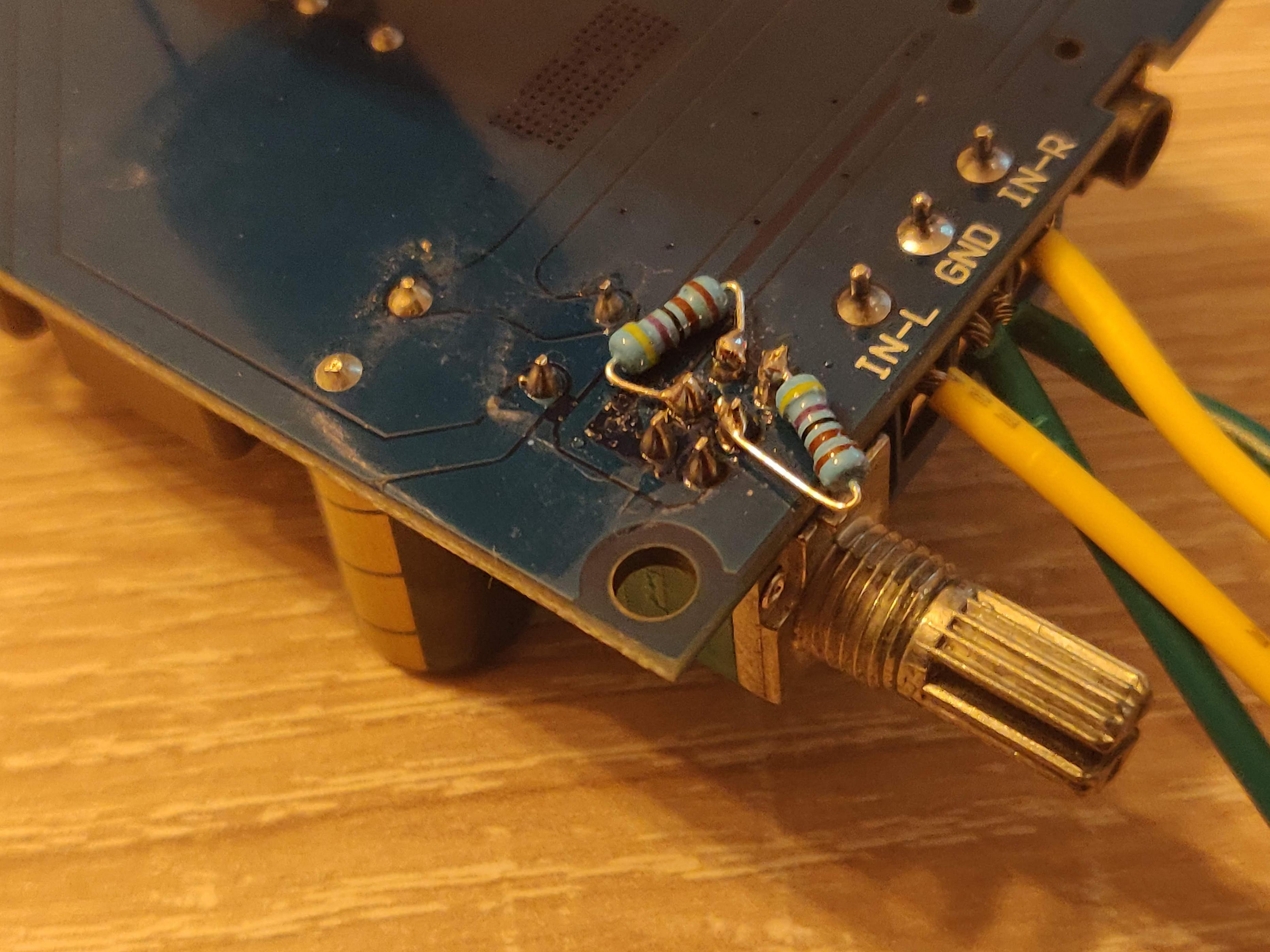

The 4.7KOhm were connected between the potentiometer mid terminals and the potentiometer ground terminals (the one with direct connection to the supply "-")?

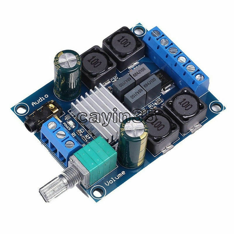

The Ebay site does no longer show the board. Could you please provide us with another photo? Eventually, also a photo of how you installed the 4K7 resistors.
If that does not work, the other modification is to reduce the TPA3116 gain. Often all you need to do is remove one SMD resistor. The problem may be if you can get access to that resistor.

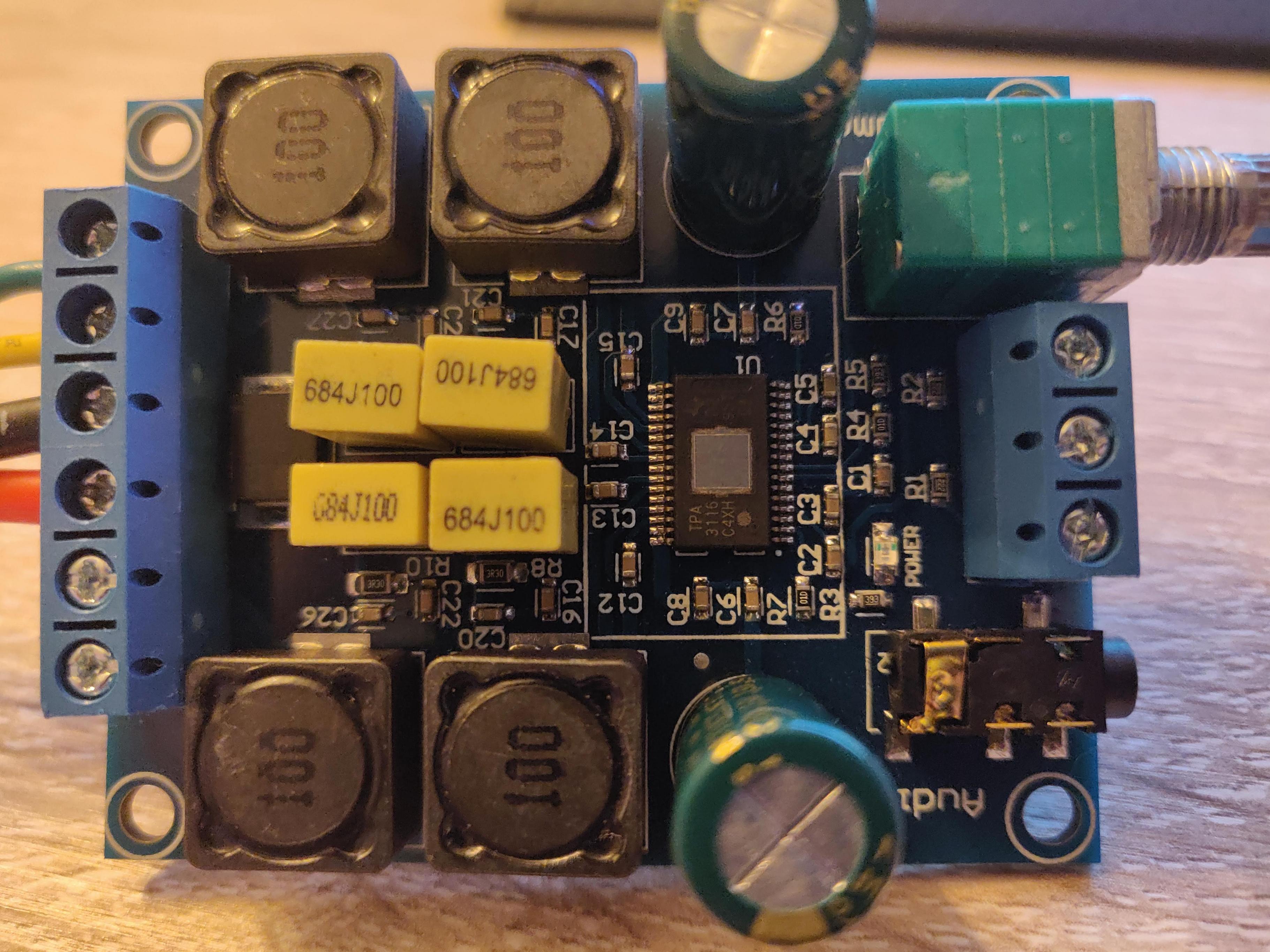

Hi, I've got 2 new XH-542s.
Hooked one up to a 23V supply from a boost converter (checked voltage, ripple and current limiting, no problem with it)running from a 12V Li-Ion battery and it began poping through the speaker (tried swapping it, no luck) at like 1hz as it was being turned on and off continously.
I checked with a cheap oscilloscope the output (MONO output).
It was being pulsed up and after about 200ms down, pulses between roughly +2v -0.5.
Checked output impedeance to vcc, everyting in the Mohm range.
Between pops clean audio comes through and sometimes (rarely) it stabilizes and works without pops.
I tried to power it up directly with the battery but nothing changed.
The same thing happens with the other one.
Is there any hope of getting them working?

There is always room for hope, if it is realistic time will show.
If both channels work occasionally, the output stage is not burned as such. The way to proceed is to use the amplifier in a situation where nothing prevents the chip from functioning correctly. When that works, we make the operational conditions more severe.
Would you have a kind of DC power supply (not batteries as they can be deceptive) with a voltage between 9V and 20V and a current of minimum 1A?
Do you have a small table fan you can use to cool the amplifier?
I included a picture from the ebay listing and the way I installed the resistors:
I have that board. Strange, on my board it worked, on yours not. The heatsink is glued on the chip and unfortunately often difficult to remove. If you cannot remove the heatsink you have little access to the resistors.
Try gently to twist the heatsink (don't pull upwards!) to see if the heatsink can be removed. The danger is that the PCB tracks may get loose.
The 4K7 resistors seem correctly mounted. No improvement on any of the two channels?
I have around 5 of the same board. they all hiss. Which SMD resistor affects gain now?

I'll try with a 12v psu and a fan although the heatsink stays cool.

I tried with a fan and a 12v psu, powered it up: popping. Very low music>popping. Medium music, after a few second>normal and then again popping with no way of recovering.

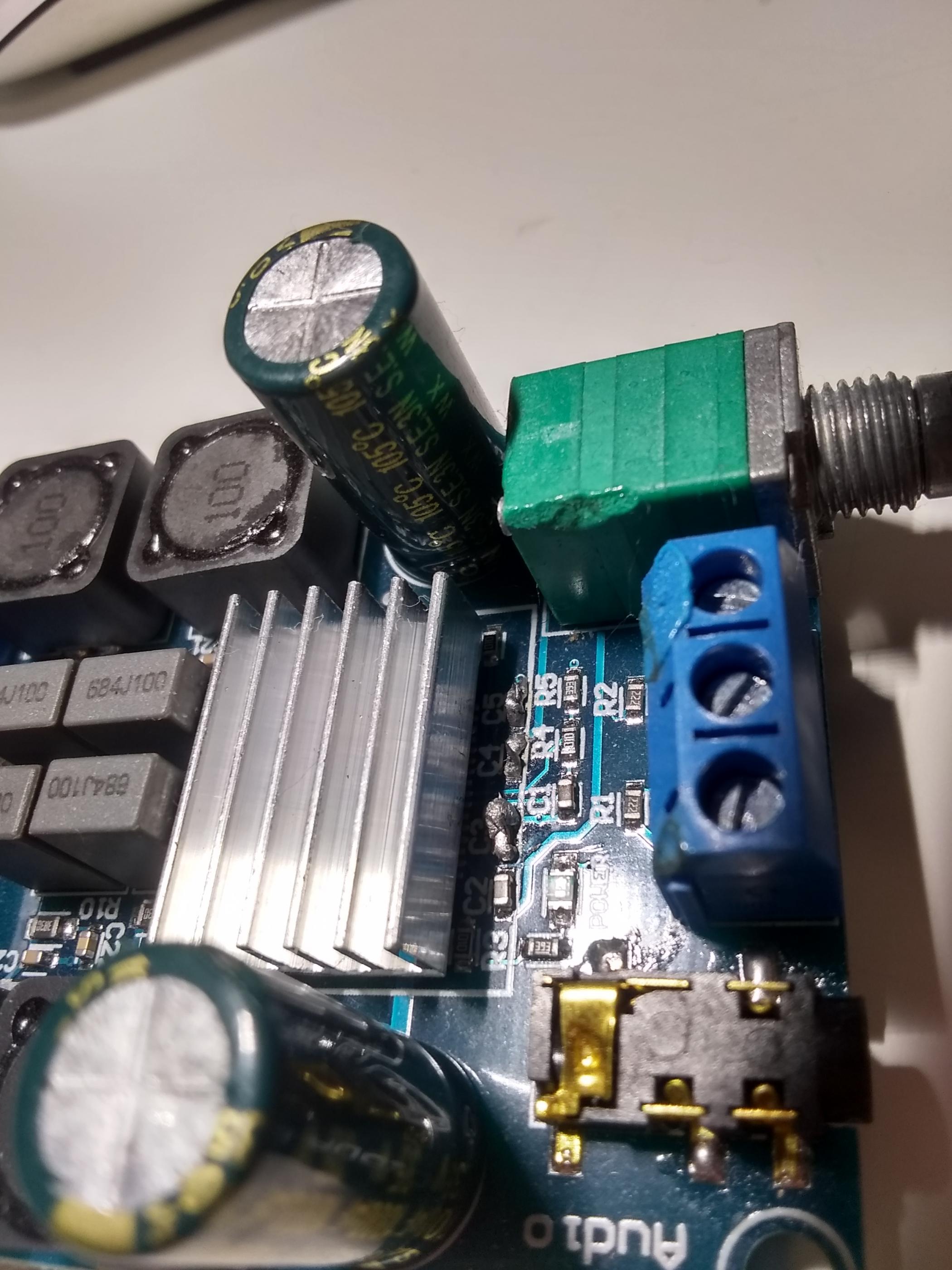

Turns out this cell phone camera sucks compared to last phone.
The amp with heatsink I converted to mono so the caps are shorted. One of the caps had fallen off the board entirely so it is stuck back down poorly as well. The first pic is the last of the 5 or so I have that I had not stuck the heatsink down on. So it looks like the same defect as the other board.
looks like for mine:
R1 222
R2 222
R3 393
R4 010
R5 393
