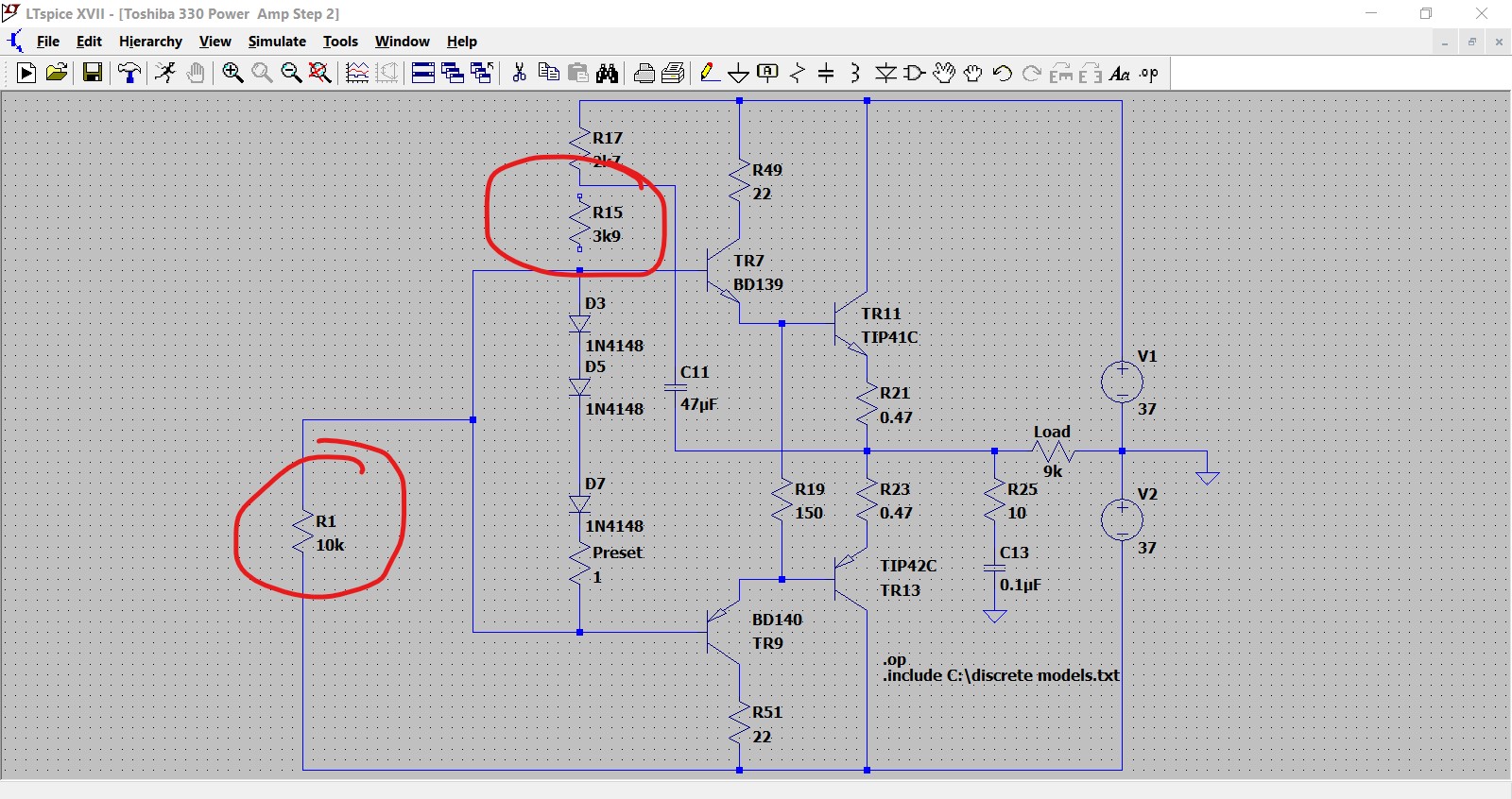

A further test would be to isolate the 3.9k resistor and tag a highish value (say 5k to 47k) as shown from the driver bases to the negative rail. This would bring the lower transistors into play and the output would swing negative. Again, all runs cold.
Is this Further test the "additional tests"? Or are there other things to do first?

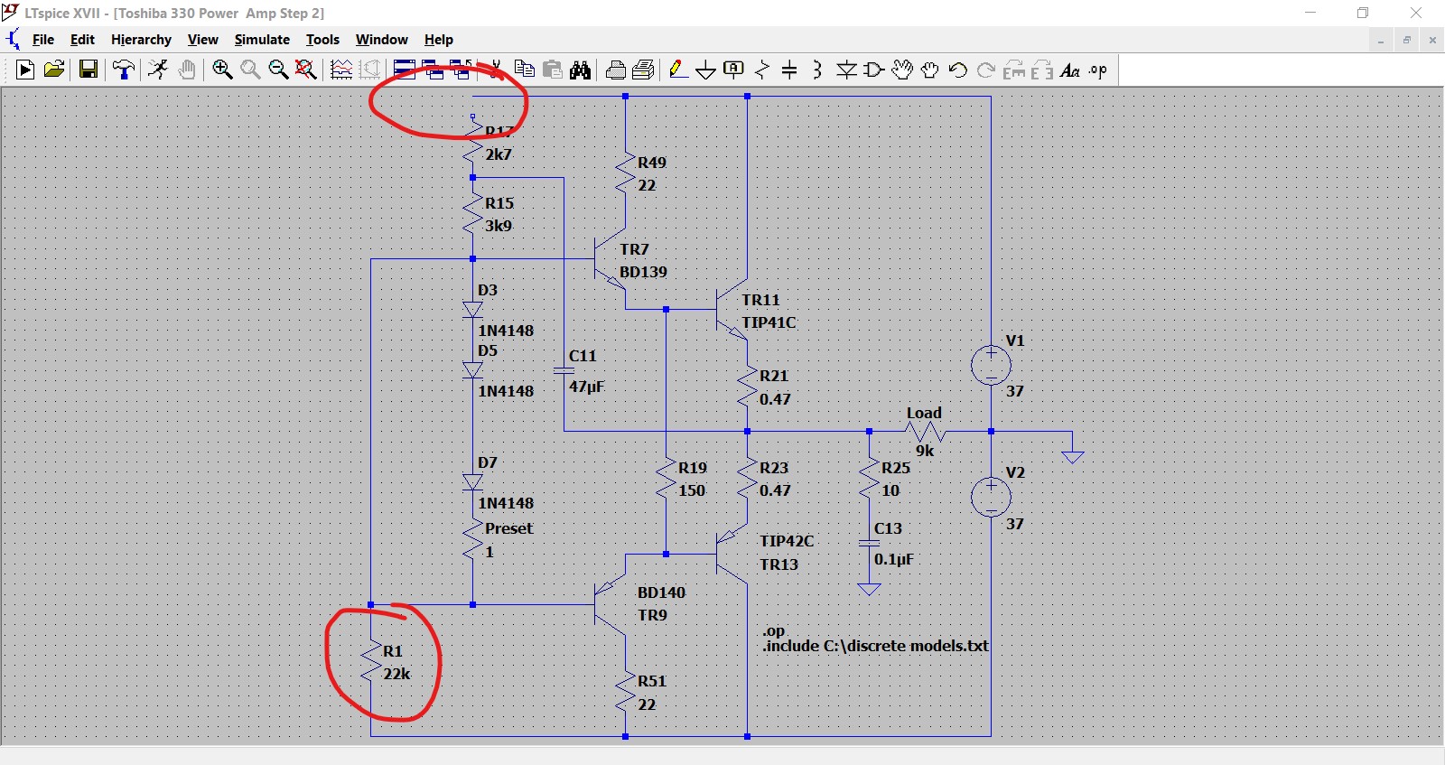

It was just that one test although thinking some more on that there is a potential issue in doing that.
C11 would see the full rail to rail voltage (so 65v or so) if the output does as it should and hits the negative rail. If its voltage rating covers that then fine, if not then isolating R17 rather than R15 would prevent that situation.
See attached image.
Its up to you whether to do this step or or not. Decisions decisions
