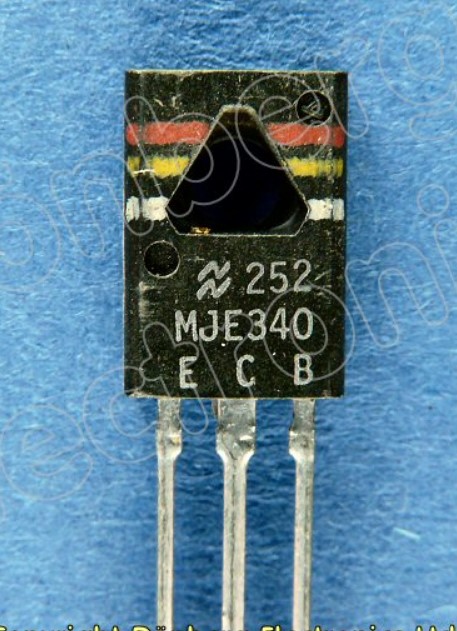

The MJE devices have been around a long time and were favourites that were used by the likes of Doug Self for several of his highly regarded designs.
I've had some odd experiences of what nowadays we would call 'fakes' going back to the 1990's, well before common internet usage and so on.
I had some MSPA devices and their complements and odd ones in the batch were of the opposite polarity NPN,s for PNP's. Really odd as the markings were all identical.
Also had some MJE340/350's that when rubbed with alcohol had BD type numbers revealed underneath.
This was back in the 1990's probably when this kind of thing was just getting going and even suppliers were being caught out by this.

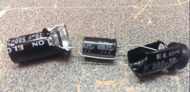

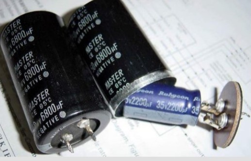

These days even capacitors are being faked. A 6800uF 50v cap with a 2200uF 35v cap inside.

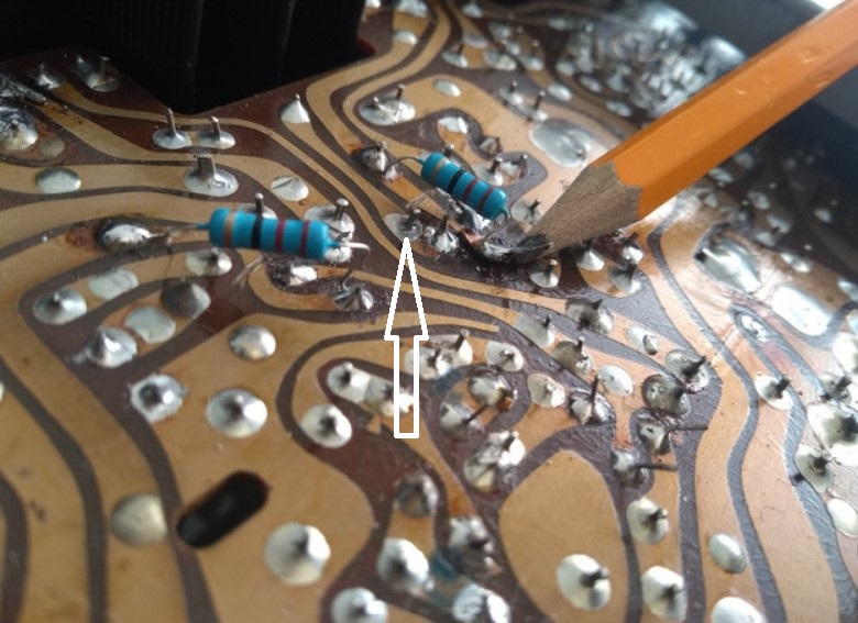

Mooly got slight snag with a listen trace. Don't think it will be too much of an issue but thought I'd let you have a look.
image upload
It it where the collector of TR8 is joins the 22 ohm resistor. As you can see that's all it does because there is a cut in the trace and the 22 ohm resistor bridges the gap to take the current to the TR12 collector.
All the 22 ohms are installed like this with a cut on the trace between the 2 legs of the resistor.
So I think I can just solder the 22ohm to the collector of TR8 and as this is all the trace seems to do as it's cut...?

The cut and the addition of the 22 ohms looks like a production change... which is not that uncommon tbh. Interesting though.
You mean the trace is lifted/broken under the 22 ohm?
I'm assuming the left hand part of the trace is the supply side... so yes, the right hand end of the 22 ohm can connect direct to the collector.
Working from piccies isn't always easy. The right hand end of the 22 ohm looks to be touching another pad. That may be a camera angle thing.
As long as the 22 ohm just goes to the collector of TR8 and nowhere else then that's correct. The other side of the 22 ohm should connect electrically to the collector of TR12
Fine, that's good then. Just thought it was worth checking .
Check this as well. The solder looks dry and crusty... again difficult just from a picture though.
I think I can see the lifted print under the resistor better in this shot.
Mooly I was thinking of very carefully going over all the solder points, even ones I haven't had to touch, with a little dab of flux and then reflowing the solder just to be sure there are no dry joints with then being pretty old. Would that be worth while?
