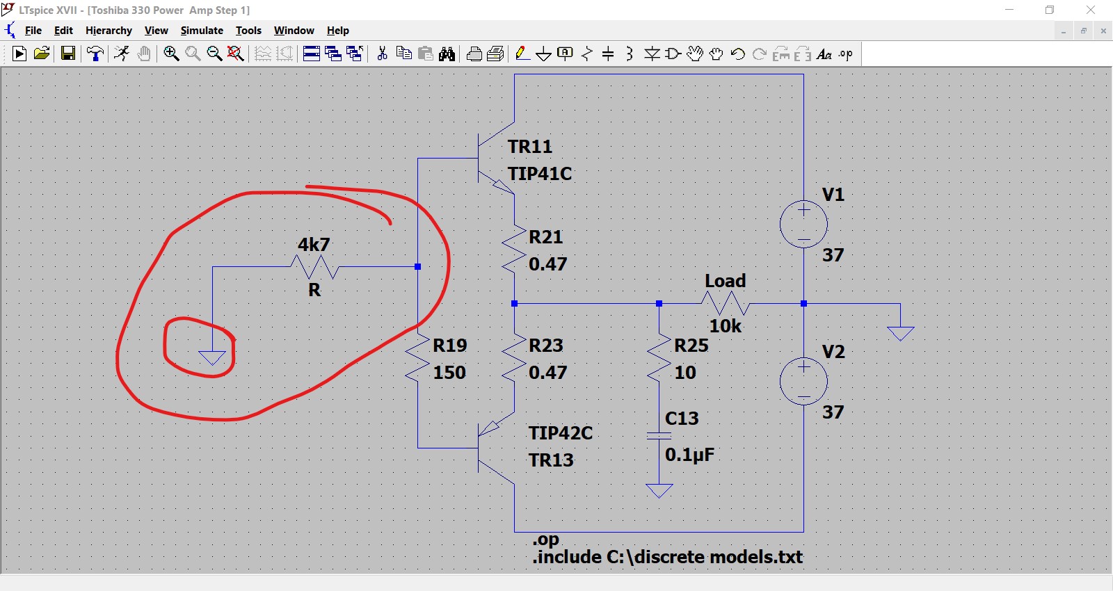

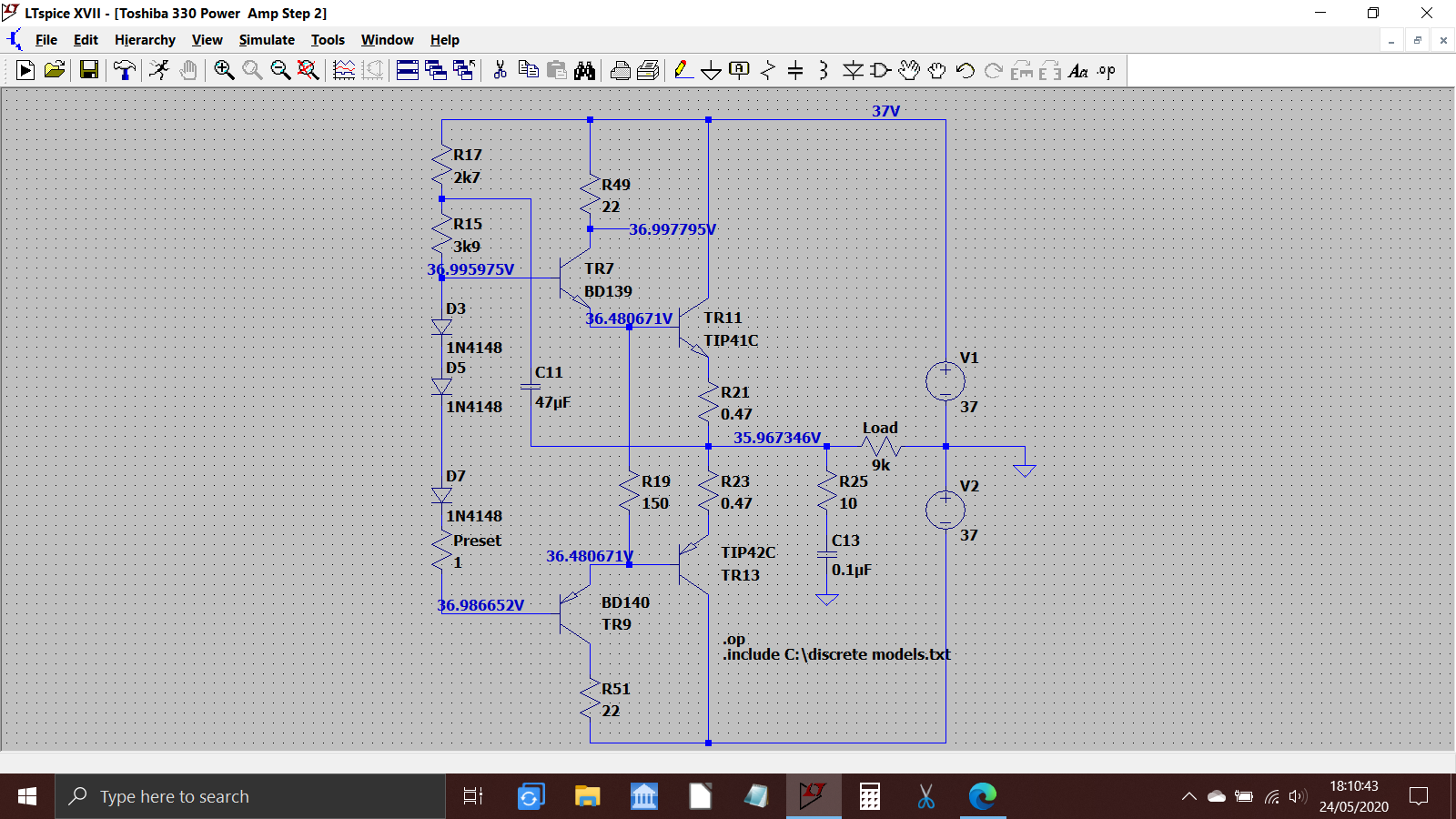

9k is fine. It is just to define a 0 volt DC point at what should be a floating node in this state.

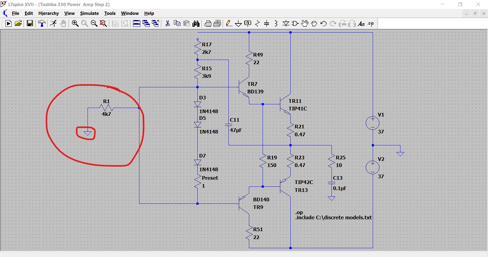

Every part can be in place except for those driver transistors which are TR7,8,9 and 10.
Electrically it is then like the diagram in the attachment with those two removed.
Look at post #160 and the attachment.
You can have everything in place except for the two driver transistors.
So the bulb should be out or very dim.
There should also be very little voltage across the dummy load. If that is not so then we need to do a little quick confirmation check that all is actually OK but check the voltage across the load first.
The 150 ohm is good? I think you checked that earlier but we need to be sure it's OK.
Only if this point is reached and all is OK do we carry on.

So:
1/ Check the 22 ohms are good.
2/ Fit the driver transistors. Be absolutely certain to get the correct polarity device (NPN or PNP) in the correct spot and the pin outs correct.
3/ Link the base of the drivers together with a bit of wire.
4/ Lift R17 to isolate it from the supply.
5/ Remove TR5
The circuit will now be like this electrically. No current should flow anywhere.
The bulb should be out.
The voltage across the load should be close to zero. As in the the earlier step, if it's not then we go on to do a quick little test to see whether there really is a problem or not... just check the voltage first though and we'll cross that bridge if needed only if we have to.

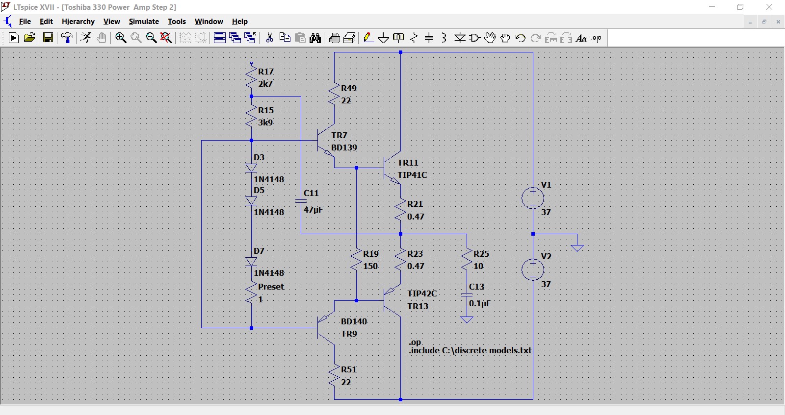

The two quick checks if needed are nothing more than adding a temporary resistor of around 4k7 or higher (it's not critical) to tie the base of the appropriate transistor stage to ground.
Although the speaker output voltage should be close to zero the base of the transistors are 'floating' and could pick up stray noise and leakage that could skew the reading.
Tying the base to ground stops that happening... but it may not be needed. If the voltages and bulb state check out OK then no need to do this.

DC voltage range on your meter for all the rails, not AC 🙂
For now we'll say the 30vdc is OK on the right channel. The positive rail should be a little higher than that value.
Left channel need a bit of old fashioned fault finding. You've built both up identically and so both should perform the same. Perhaps some open print somewhere around the pads of one of the transistors.
Be extremely careful not to short anything when measuring... its easily done.

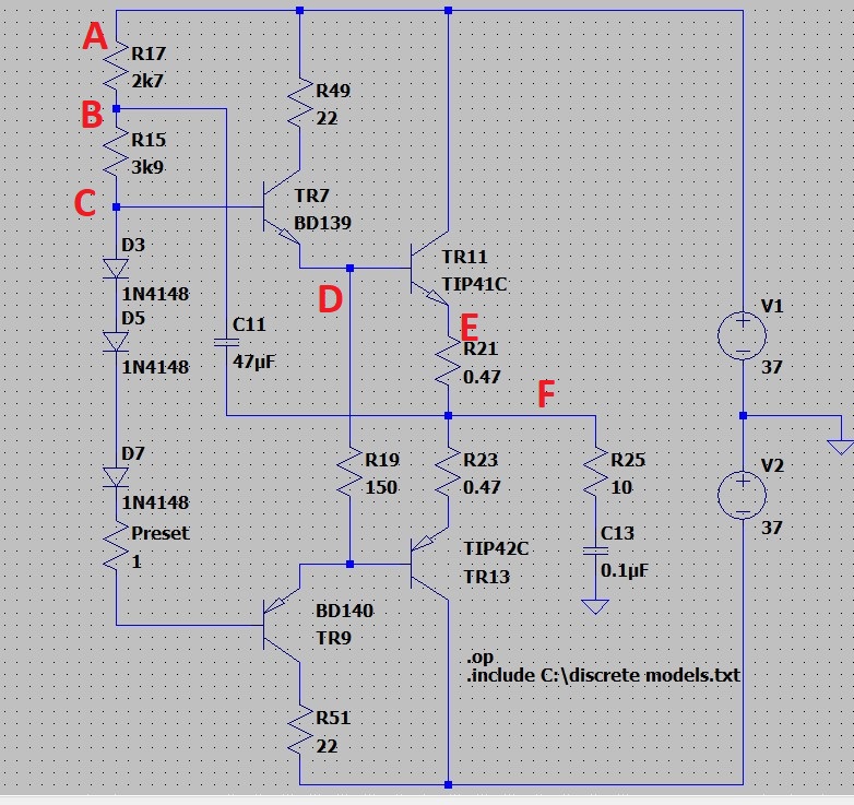

So the left channel... look at the simulation I posted above for voltages. Do you see how nearly the same voltage appears all the way through the circuit in this state. You need to see where yours is missing.
1/ Check you have positive supply voltage on R18 and R16. You should see the voltage carried through to each leg of each resistor.
2/ That same voltage should appear on the 150 ohm less a little bit.
3/ The voltage on the 150 ohm should appear on the emitter of the NPN output transistor TR12
Like this. Begin with 'A' and work through measuring at each point. You should see the same voltage carried through all the way to F.
Would I just test between a leg of the resistor and earth, or actually across both legs of the resistor?
I was measuring the voltage coming off the load side of the transformer before the capacitors 😱 . It's 32V DC after the caps 🙂
That's more like it 🙂
So we'll say your 30v dc at the output is correct... which leaves the other channel.
You are measuring from ground here, so black meter lead to chassis ground for all these and then just measure on those points A through to F with the red lead. The voltage must disappear at one of them.
