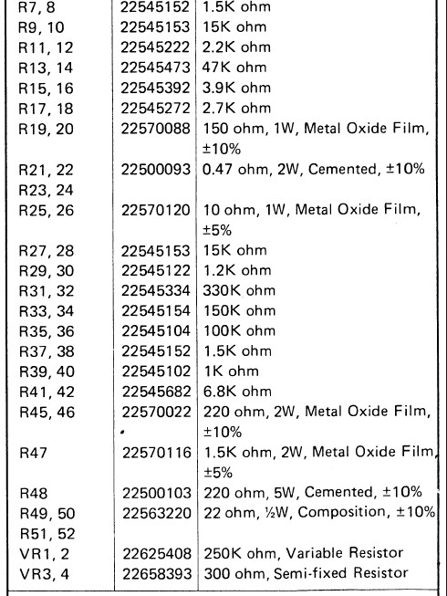

The 22ohm resistors don't stipulate wattage on the Schematic... Not sure what to order for these.
Mooly am I correct in assuming we are rebuilding just the right channel or will it be the whole thing?
That's up to you but if I were doing this I would do both channels the same but concentrate on one channel at a time.
0.5 watt for these. They don't pass much current. The full parts list shows official ratings for all these. Ordinary metal film are fine... don't worry to much over the actual types specified. Often cost is a consideration (these are listed as composition types) and also how well they burn under overload conditions 😀 A little smoke frightens the customers and so parts are sometimes specified as types that minimise this happening such as Metal Oxide types although MO's are also very high temperature rated where that occurs in normal use.

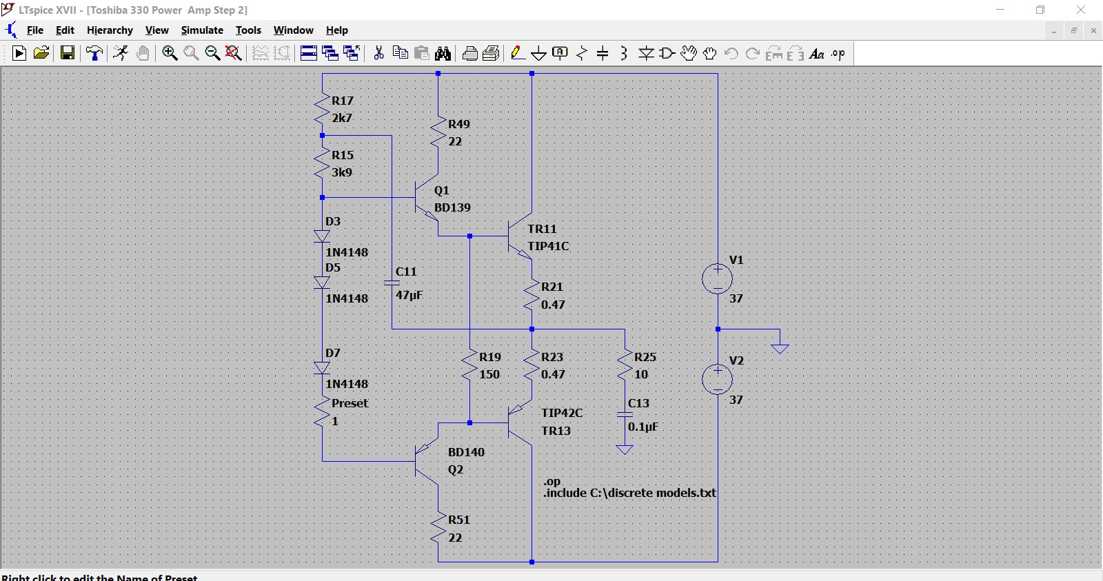

Both driver transistors will be replaced. BD139 and BD140 are pretty decent all rounders.
2N5551's can be used or TR5

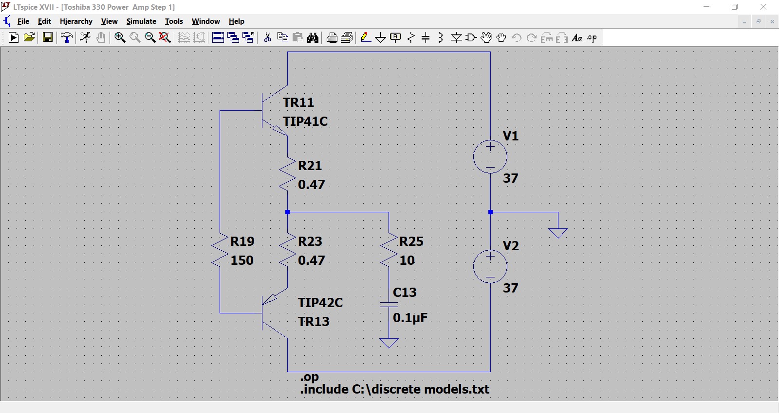

I was just playing around with the design in a simulator and seeing if I could come up with an easy way of you testing it all as it proceeds.
This would be starting point, just the two output devices fitted with no drivers fitted. All the parts stay on the board... just if you're wondering... the removed drivers isolate the stages.
So that would be step one, new outputs and confirmation that no current is drawn.
Then step two would fit the drivers but now with TR5 removed. Again no current flows anywhere.

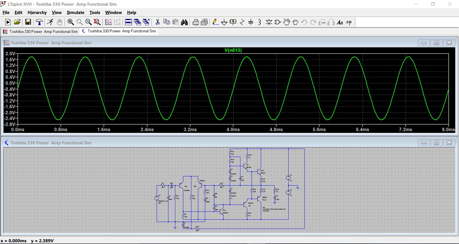

I'm still playing around with it at the moment but it might make things easier to understand like this.
