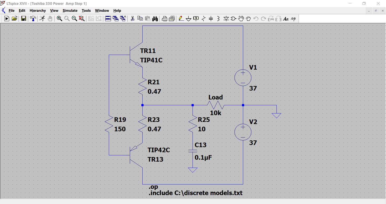

I was just playing around with the design in a simulator and seeing if I could come up with an easy way of you testing it all as it proceeds.
This would be starting point, just the two output devices fitted with no drivers fitted. All the parts stay on the board... just if you're wondering... the removed drivers isolate the stages.
So that would be step one, new outputs and confirmation that no current is drawn.
Then step two would fit the drivers but now with TR5 removed. Again no current flows anywhere.
I'm still playing around with it at the moment but it might make things easier to understand like this.

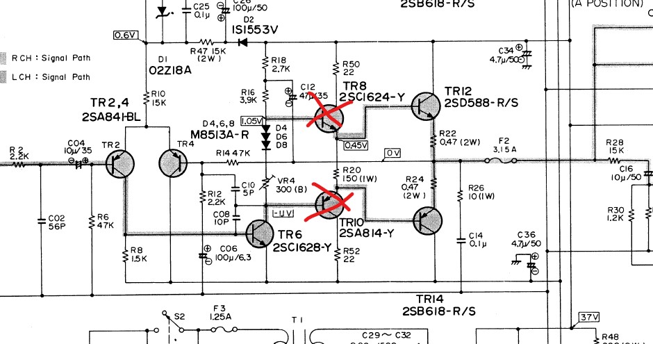

Erm, dumb question but which which are the outputs and which are the drivers? 😕 😱
Thanks!
Also, you mentioned linking out the preset which just for now while we are testing, does this need linking with a resistor or just short it?
The outputs are the ones on the heatsink, the drivers are the ones before which are TR 7, 8, 9 and 10.

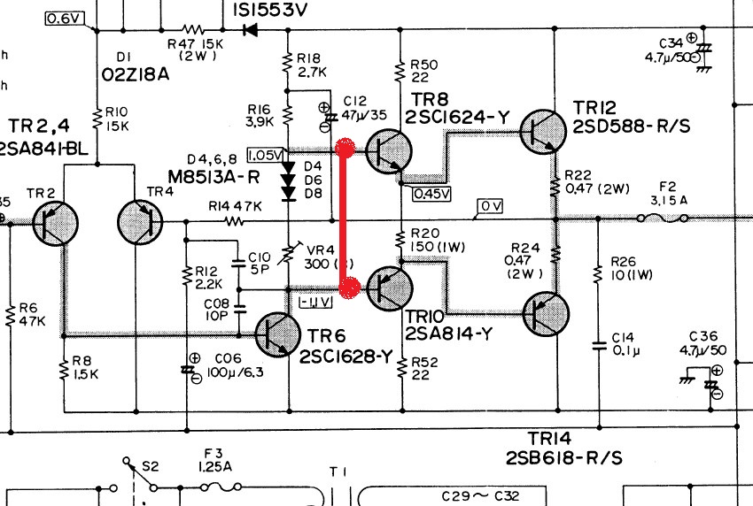

For testing and when we reach that point we link the whole bias chain out which is the preset and diodes. So we link base to base of the drivers like this:

This was the first point to reach, the outputs fitted and the 150 ohm in place but the drivers removed. That will bring the output stage of the circuit electrically to this point.
If you power up like this then the bulb should be off.

With everything exempt for the drivers in circuit for both channels, bulb glows very dimly.
Done. Left left channel as it was before but fitted the drivers to right channel and removed TR5, again bulb lights up for a spilt second and then glows very dim.

You can have everything in place except for the two driver transistors. The bulb should be out or very very dim.
You can also connect a high value resistor (say 10k) to the speaker terminals. This will act as a dummy load and will give more accurate results when checking offset values.
There should be zero or almost zero volts across this resistor.
The bulb being out shows no current is flowing. A low voltage across this dummy load shows that neither of the two output transistors is allowing any current (voltage) to reach the output terminal.
(Everything else is surrounded by high impedance component values and so any faults elsewhere would not cause any damage or significant current to flow.
R16 and R18 may seem hot but that would be normal in this state as they should have the full total rail voltage across them)
