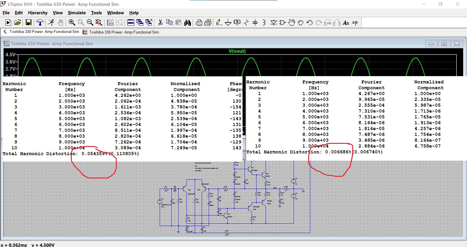

So without any bias current and then with a few tens of milliamps.

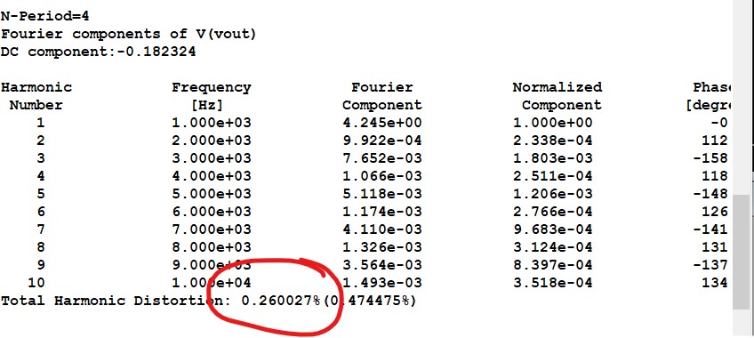

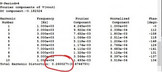

And with the three diodes shorted as we originally had, and where you felt you could hear the distortion.
The real world figures will vary quite a bit but you get the idea.
