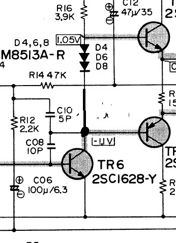

Those look fine. If you need to bend leads then use fine pliers to bend just the lead itself, always try and avoid bending or splaying out leads so that they strain where they come of of the package. Same applies to transistors as well.
The diodes... yes they can be fitted and even tested in circuit.
First thing as these diodes are truly critical is for you to look at the originals and be 100% sure of how they are fitted, both for polarity and for how they mount mechanically. If they stand-up on their leads or are bent over to be near the heat of the output stage then mount the replacements in the same way.
Do one channel at a time and also remove the old preset.
Now we need you to temporarily link out the preset with a bit of wire.
This next bit is really important. The preset has three terminals and depending on the board layout only two may be used or the middle pin of the preset may connect to one of its outer pins.
It doesn't matter how the board is configured, what matters is that you link the preset out so that the base of TR5 or TR6 is in direct electrical connection with D7 or D8.
Electrically it should look like this (attached)
When all that is OK remove the old shorting link connecting the two bases together.
Make sure it all looks like the diagram below.
Do just one channel. The bulb should still be out and all still cool.
Just want to make sure if I've understood this, Mooly. Looking at the pic I would say I am to just use a piece of wire to literally bridge the base of TR5's solder pad to the D7 cathode solder pad...
Then remove VR4 and to the same between TR6 and D8?
