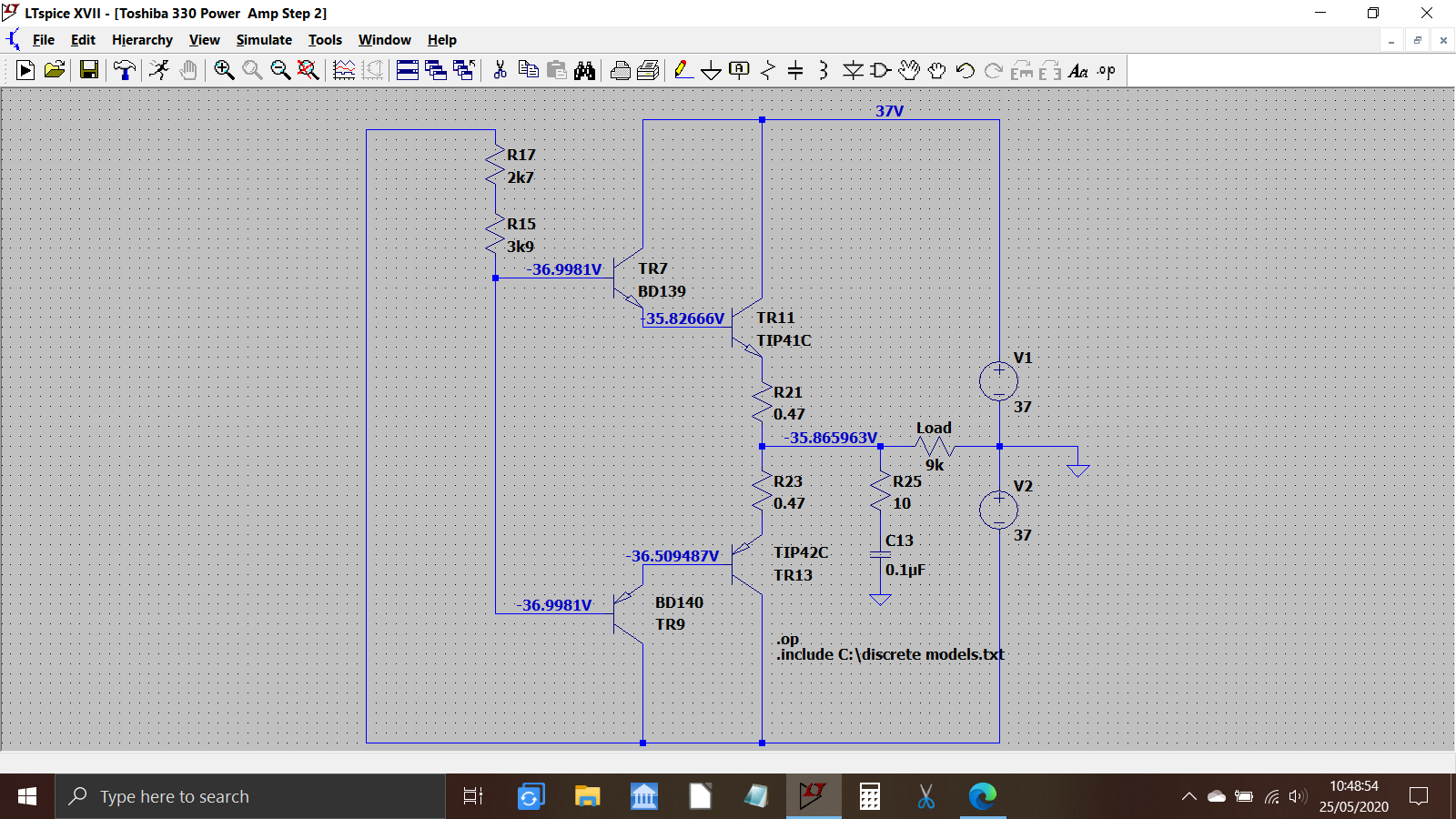

OK, another day... lets try and crack this one by working on just one channel.
The theory is rock solid and sound and so when things aren't as they should be it means there is a definite and real problem.
So lets start with this obvious problem and just go back on the theory of what should happen:

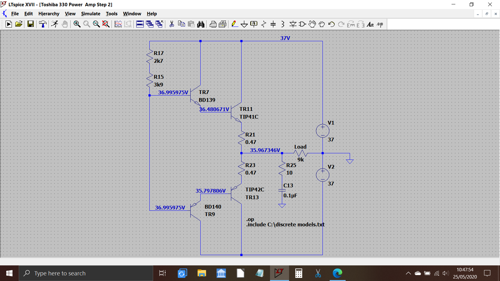

This is the configuration you have (attached). R17 fitted. TR5 removed. TR9 getting hot.
This is what should happen:
R17 and R15 apply the positive rail voltage to the driver transistor base's.
TR7 and TR11 are now biased 'on' but there is nowhere for any current to flow apart from into the load resistor (9k). Because they are 'on' you see almost the full positive rail voltage at the output.
TR9 and TR13 are most definitely 'off' in this state and neither passes any current at all.
So why is TR9 hot?
And this is where fault finding is so interesting it's all about pulling in evidence and looking for reasons why something might be wrong.
We know we have positive supply voltage at the output terminal.
TR13 base will also see that voltage because the E-B junction behaves like a forward biased diode putting this same voltage onto TR9 emitter.
So far so good... but TR9 should definitely be fully off as it is configured. Off means cold.
A bit more evidence is needed to try and piece this part of the puzzle together.
Current flows will leave a trail by means of the volt drop they create across the resistors.
Other possibilities to check/confirm:
1/ Were the driver transistors new and unused and from a reputable source?
2/ Check by measurement (continuity test with amp off) that the actual Base, Emitter and Collector of each driver goes where it is supposed to on the board. Although unlikely it can happen that board markings are wrong.
So look at the data sheet for the BD140 and make sure that the middle lead connects to R51 and that the 150 ohm connects to the emitter.
Now make sure that the base of the BD140 itself connects to the base of the BD139 (it should do as they are linked by wire).
Above all don't lose sight of the fact that the problem at this point in this channel has to be around those transistors or a problem with them.
The attached image shows the configuration we should be in. You should have no voltage across (measured now across) either of those 22 ohm resistors and also no voltage across the 150 ohm.

You've got it, they stay in circuit and connected to R15/17.

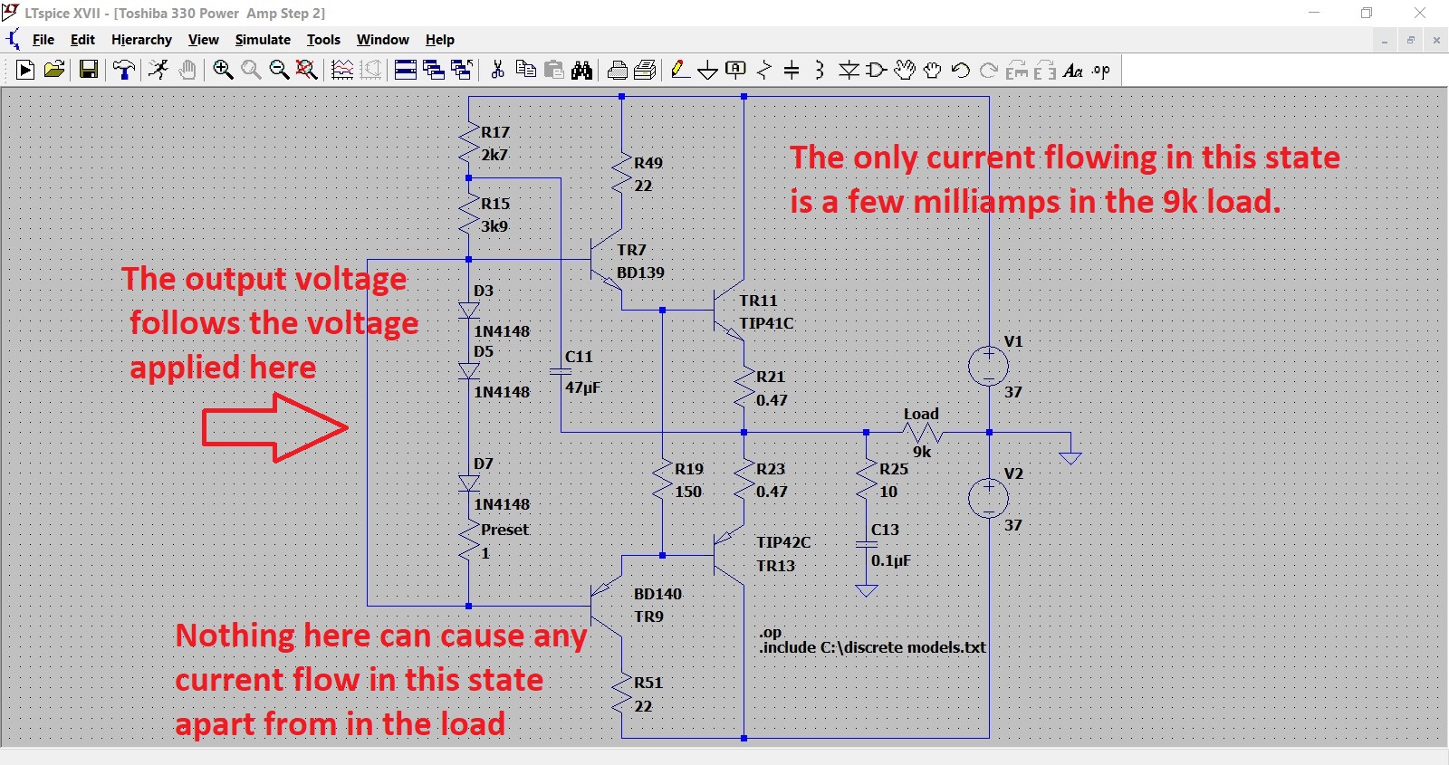

Without wanting to confuse you, this is how the circuit reduces down to it's fundamental parts. The speaker output follows the base voltage of the drivers, no matter what the polarity.
With no load attached no measurable current (for our purposes) flows in any component in this state.
If we linked R17 to the negative rail (second image) the voltages all reverse polarity. Again no current flows anywhere.
Check for any solder blobs anywhere around those transistors.
