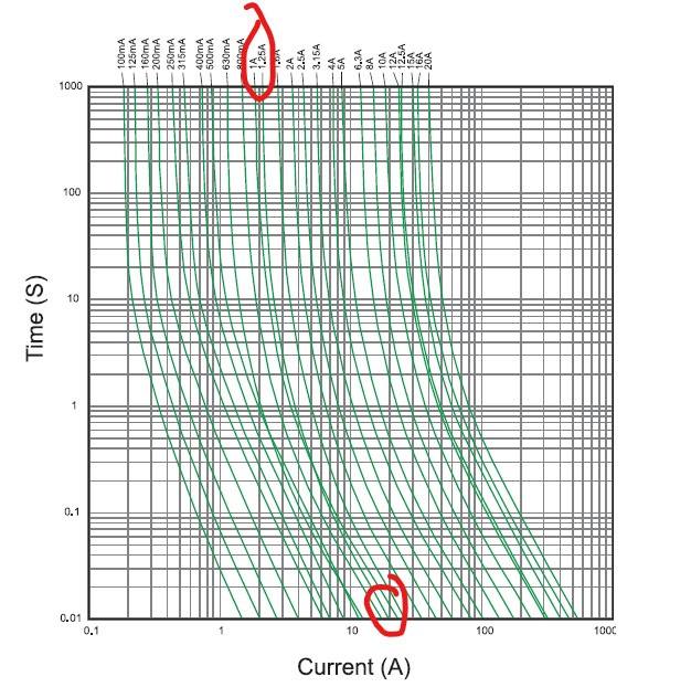

So we need to prove the bulb tester is OK. A 1.25A slow blow fuse will withstand around 20 amps (yes 20) for 10 milliseconds falling to around 7 amps after 100 milliseconds. These are fuse manufacturer data sheet values.

Starting Characteristics
OK, lamp limiter is now working as we'd expect, bulb lights up fully and I can power the amp up without the fuse blowing. Fuses are defiantly 1 and a quarter amp slow type. Ready for some testing 🙂
