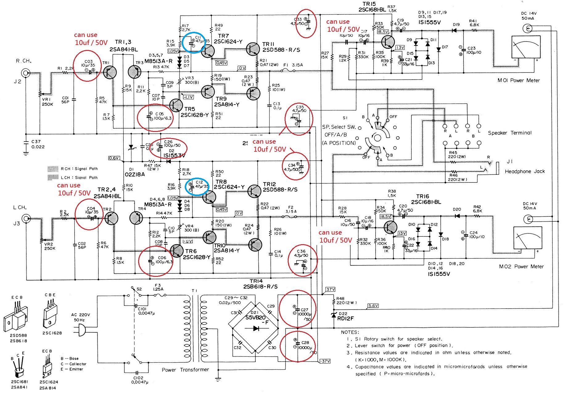

Toshiba 330 power amp
C11 C12 47uf/35v x2pcs

Just waiting on some of the caps to arrive but making a start. Just wanted to check with you more knowledge folks if these caps are ok for the power stage. They have the same values but the new ones are about half the size
Also the old ones say 50WV, my understanding is that means the safe working limit? So still a 50V cap?
Also, can the old ones be discharged whilst on circuit or is it best to desolder them first and then discharge them? If if needs to be done before desolrering how is this best done? With a light bulb?
Thanks 🙂
New caps produce with new technology therefore the size will be smaller than the old caps.
yes, old cap 50WV is still a 50V cap
If the amp is working normally, the 10000uf power supply cap will discharge in a short time.
But each time before you repair or do anything to the amp you better measure the caps voltage with a multimeter. If the cap is still in high voltage, discharge it with a 100 ohm 2W resistor and check with multimeter again.

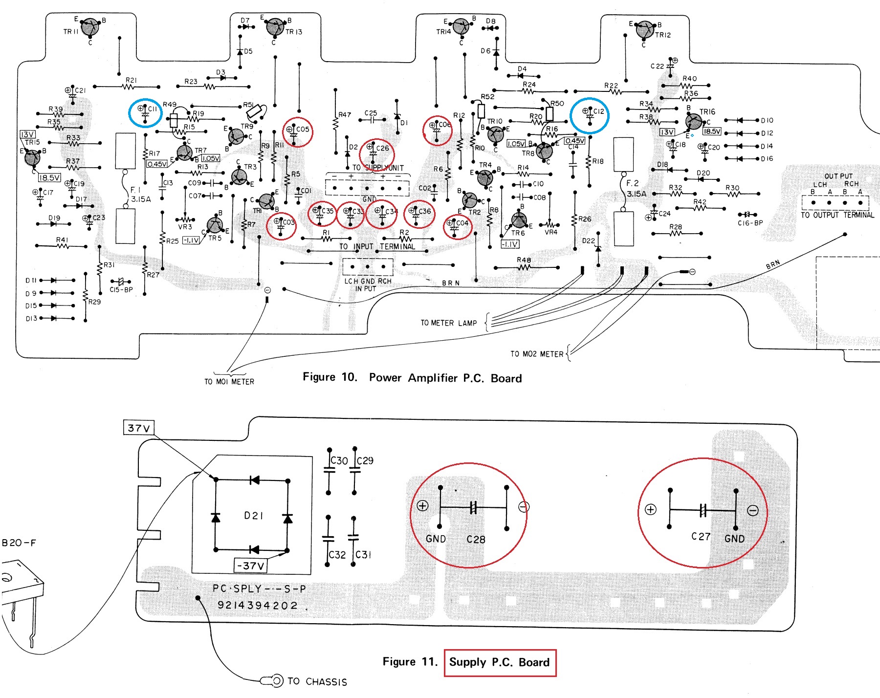

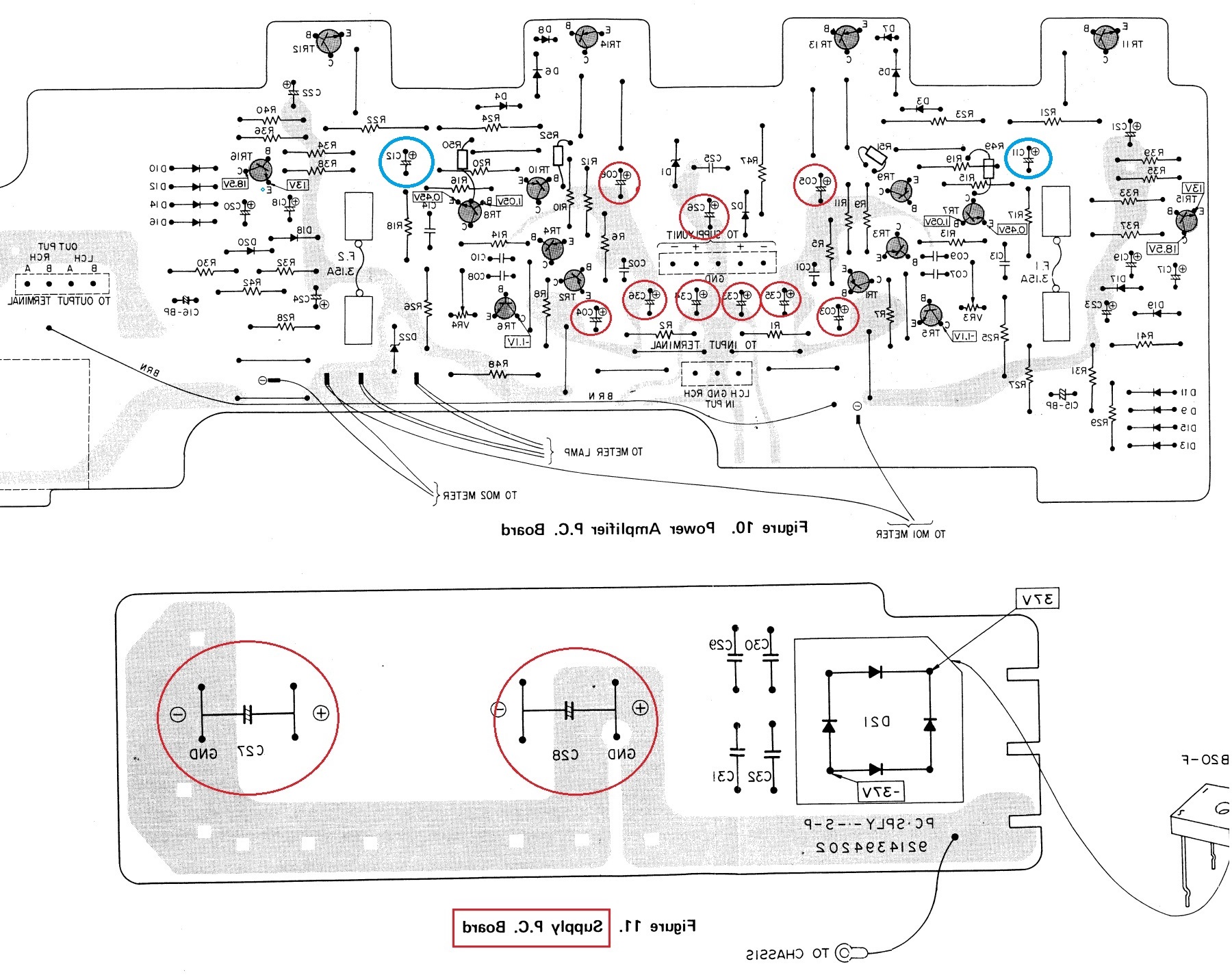

Bit of a dumb question maybe but....
How do you guys go about locating the solder points of a component in the underside of a single sided PCB? When looking at the cap I want to desolder from the top of the board, it's pretty hard to locate the points when the board is flipped over. I can only think of using some sort of very narrow beam light source touched to the side of the cap from above, like the small torches doctors use to shine into your eyes to dilate puplils. Other than that a ruler to measure the distance? Still not always obvious exactly where the solder points your after are though esp if lots of components in close proximity...
Patrick I have the schematic and have no problem finding the components when viewed from the top side, it's locating the solder points on the underside I'm struggling with. Nothing is marked on this side and it's pretty congested so not easy to locate the individual components...
Right. The large power stage caps have 4 pins. The ones ive ordered have 2....
There are only + and - polarities in the PCB, so that you just use short wires to connect the caps to the PCB, and fixed the caps with the original metal belt.
Careful in soldering, do not short any circuit, double check there is no short circuit for these caps before you fire up the amp.
