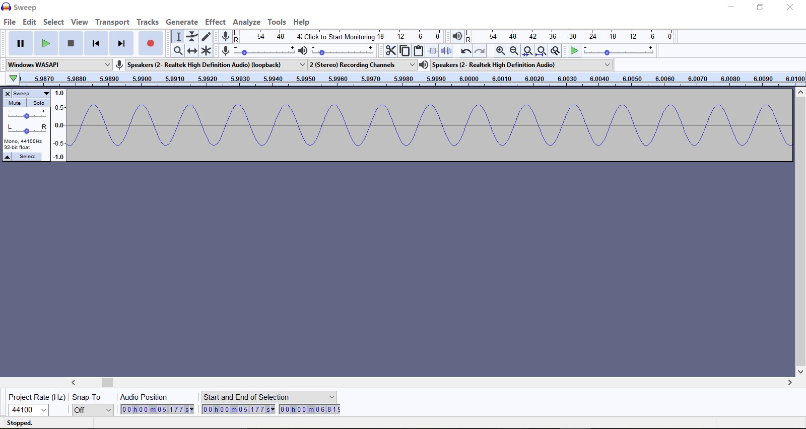

Here you go. This MP3 plays for 3 minutes and covers 20Hz to 20kHz. The level is quite high so make sure the volume is turned right down to begin. Once you are happy with the 'sound' which should be pure with no distortion then you can disconnect the speaker and turn the volume up to say 3 to 4 volts (AC remember). Then see if the level alters through the sweep.
Try both channels and perhaps also a different amp to gauge your meter response. Best guaranteed meter accuracy will be up to at least 500Hz or so and many meters are OK over the full audio range.
You could also try measuring the input voltage (from whatever you play the file on) as a double check on response.
The track is a single mono track to save space.

It played the file but it was a really fast sweep so not sure if it was an issue with my phone and the mp3 codec or something...

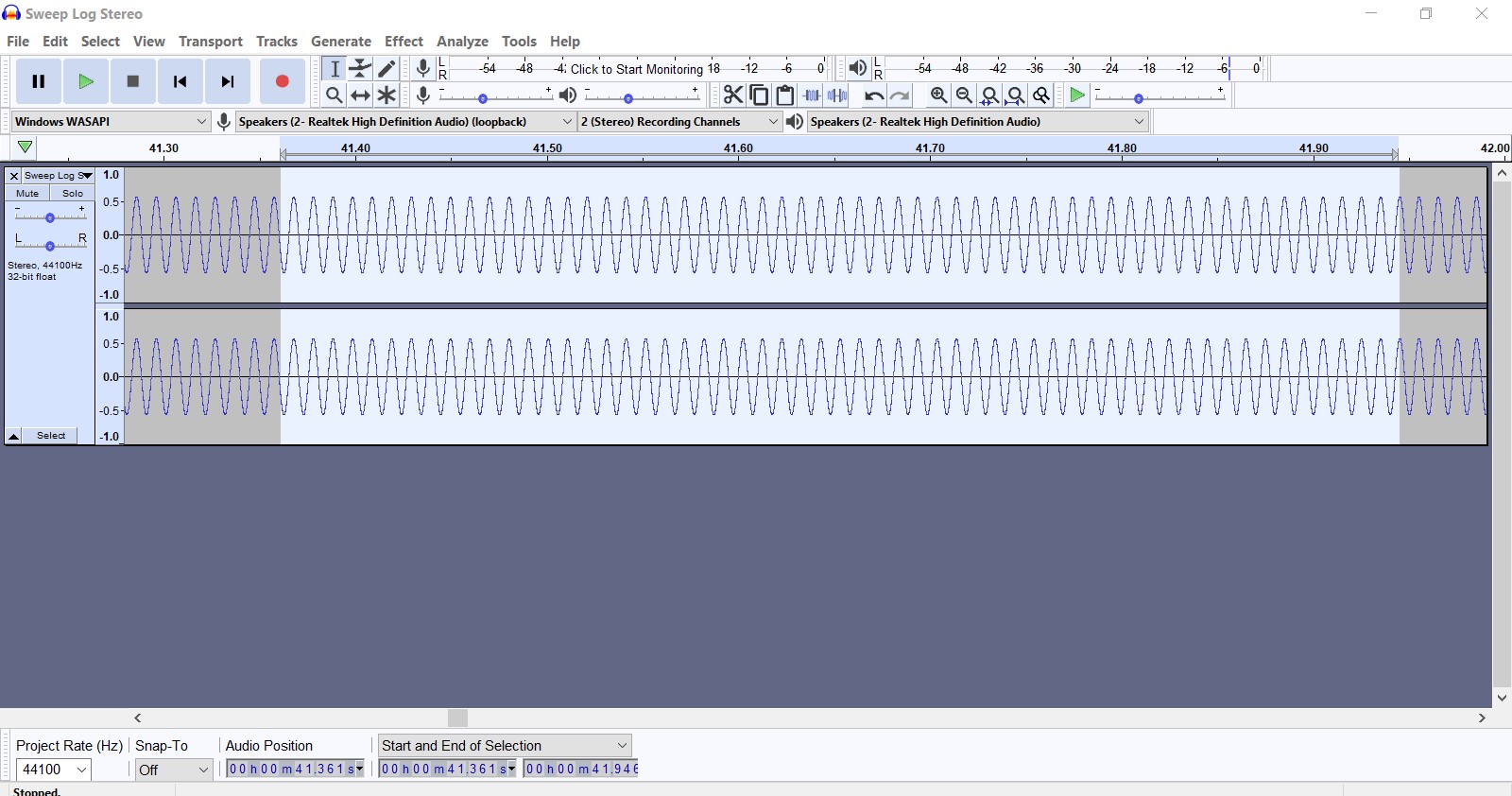

Try this, its the same thing but now stereo (two track) and crucially with a logarithmic sweep. The bass frequency increase starts off slowly and you may not hear anything until you get 30 or 40 seconds into it if playing on a laptop.
Even at 40 seconds in its only around 100Hz.
