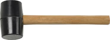

get yourself a plastic. or rubber mallet to shape up the
windings, do not hit the wires strongly, use gentle force just enough....

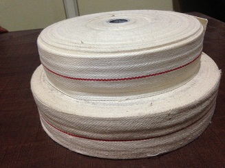

You don't want adhesive on the insulation tape. Adhesive makes installation almost impossible with the long unbroken tape that needs to be wrapped around.
I would think that there is too much air in a cotton tape. That air will be an effective thermal insulator and make the transformer run hot.
Which tapes I have to use for insulation between primary & secondary Can you suggest some.

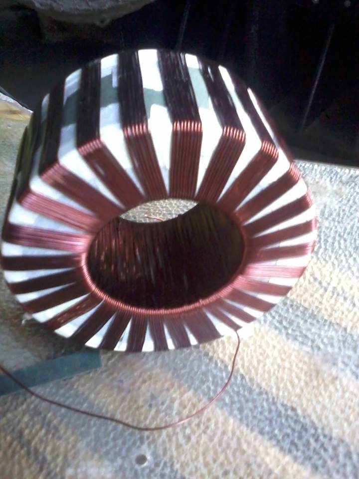

Hello AndrewT & Tony
Finally Done primary winding today of my toroidal core.Attach photo of transformer below. 755 round of 0.914 mm magnet wire. core size before winding OD-100mm, ID-60mm, Ht-50mm (M4,CRGO) as we discuss early on this thread.Please replay soon
