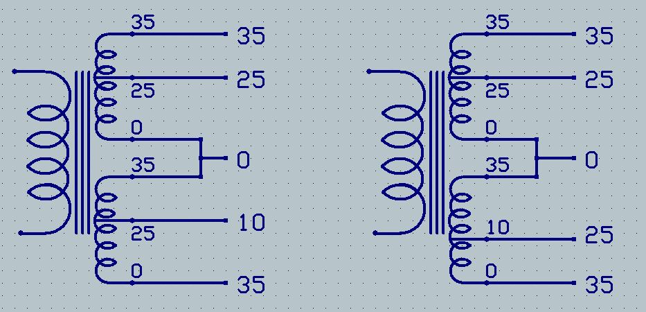

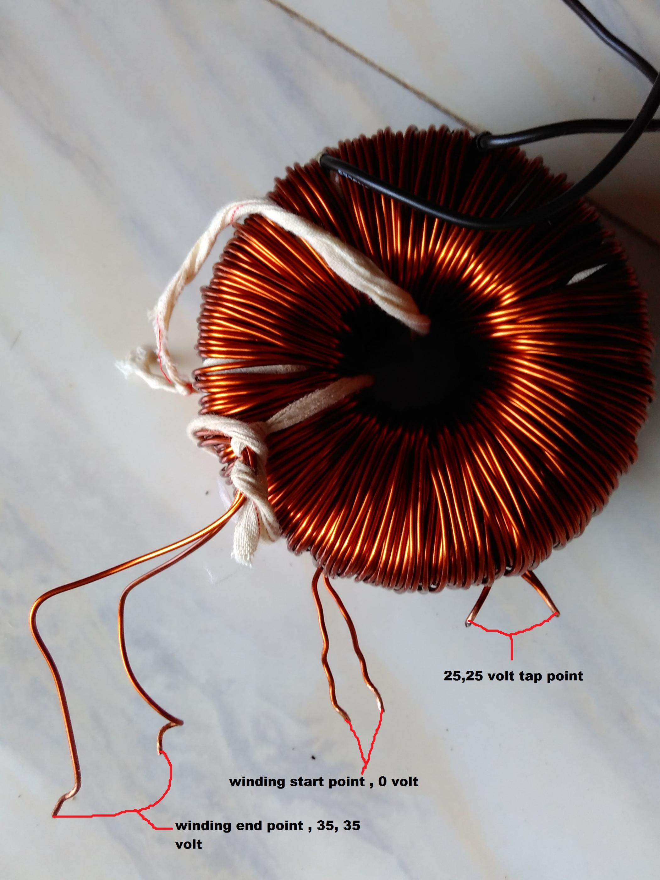

Hello Andrew t
I am completed all secondary winding
As follows 35 25 0 25 35 but when I measure 35 volt winding respective 0 it showing both 35 volt is OK but when I measure 25 volt winding respective to 0 volt one 25 volt tap shows 10 volt why this happing it shows 25 0 10
Measure each of the tap to tap resistances.
You might be able to see the shorter windings and work out from that where you went wrong.
I think you don't understand what i trying to say.
When i connect both 35 volt winding in series I get 35-0-35 volt but can't get 25-0-25 volt.To get 25-0-25 volt I have to connect both 25 volt winding in series.so thear is no short.
