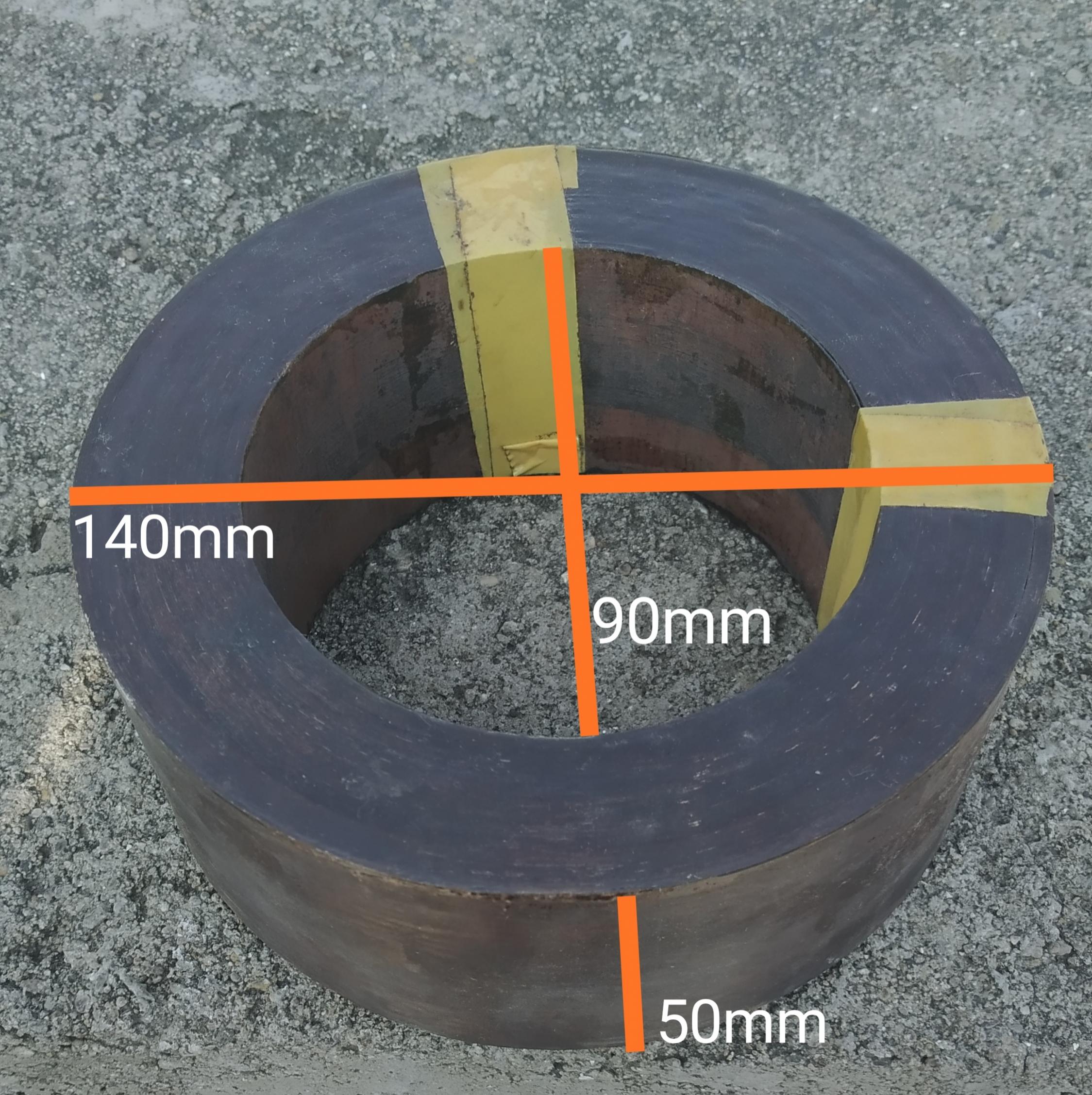

New core to build transformar
Hello Tony sir
I have toroidal core of following size, it's more than 1kva.
so I can wind two 35Vac and two 55Vac on it.
can it is enough for Apex Mono B500 and stereo Ax-14 amp. Because I think total Power requirements is near about 800 Va.
Or I have another 800 VA toroidal core.
please help.
Best regards
Hello Tony sir
please help.
Best regards

Not really sure of how did you got that power rating, but anyway, you would need about 3,6 turns per volt for 50hz ( 3 turns per volt for 60 hz ), or maybe a bit less for a higher flux density. You have 6358 mm^2 available winding window area, thus you can calculate the number of turns for each winding and the wire thickness...

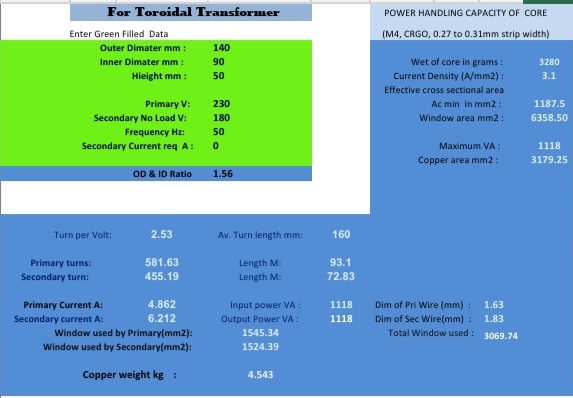

Hello tony sir and marianB sir
hear is my calculation for toroidal core.
I make about 5 to 6 toroidal transformar base on this calculation,
please see attachment.

at primary side with 2/5 turns per volt and 230v/50hz core works at 1/5 tesla.
you should use at least 1.2mm diameter wire for primary and for less copper losses and continuously load condition 1/5mm would be better choice
