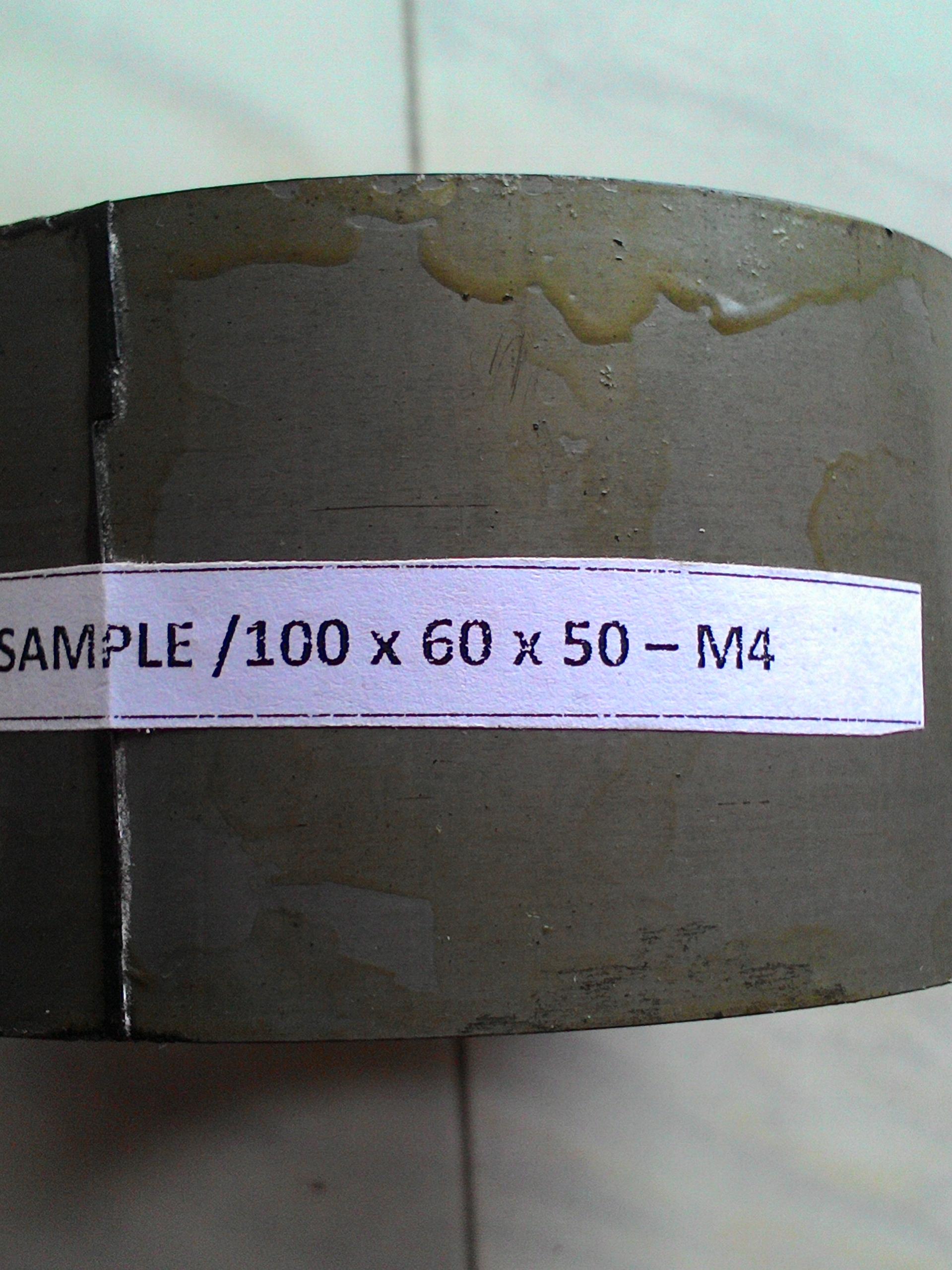

No way that core will handle 700VA, sorry.
You have a 2.5cm*5cm section core, so 12.5 sq cm.
Best case, it will handle 150VA .
Primary turns for 230V mains= 828.
Wire diameter: 0.50mm will be fine.
Secondary turns: whatever you need to get proper voltage.

Thanks for your reply.Before this core, I already build 360VA Toroidal transformer, on 9.5 sq cm core and that's working fine.Core size for that trans' was OD-100mm,ID-60mm,Height-50mm.

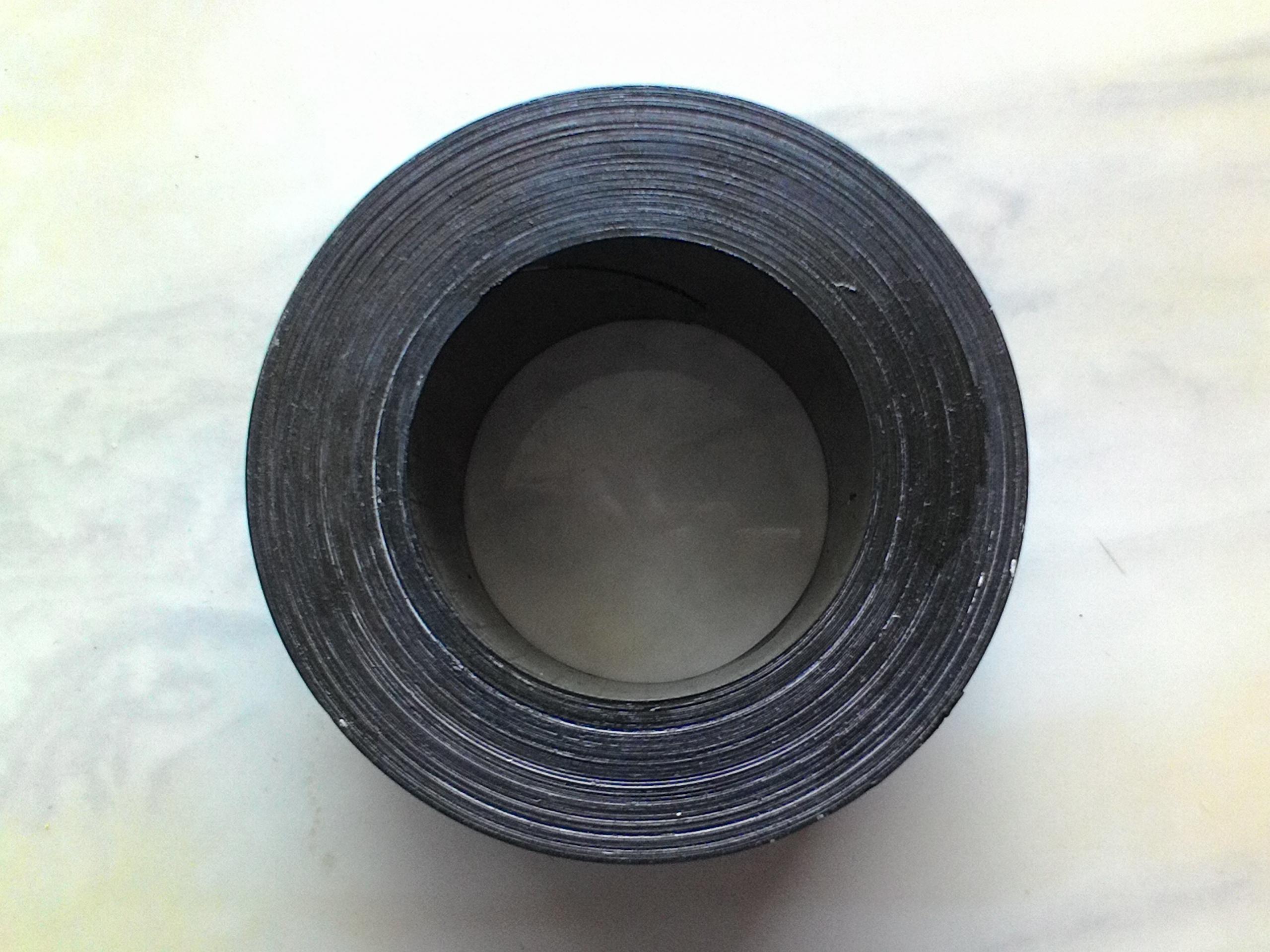

The core it's self doesn't have to handle anything, the core does not "give" any power, it's the copper wire that has to handle the needed power, the core is just an intermediary, it doesn't care how much power you ask it to transfer as long as you make sure it's far enough from saturation, and saturation does not come from excessive power, or from too much current drawn from the windings, saturation comes from to much induction, meaning it comes from a too small turns per volt ratio. The issue with any core is the number of turns needed to handle the voltage ( which depends on the core size ) and the wire gauge needed to handle the current. All of that has to fit inside the window, that is the limiting factor. With a big enough window, you can fit more copper, thus you can get more power despite the core's cross section, but at some point, the wire length becomes too large, meaning the DC resistance becomes too large, thus the copper losses become too large, that's what gives the need for a compromise, and the empiric formula P=S^2 is exactly that, a compromise, not a fixed limit.
In this case you would need at least 3,6 turns per volt ( i would recommend 4 ), are you sure you can fit all of that wire inside the window? Calculations can be made to be sure, but i rather doubt it can be done...

I already build 360VA Toroidal transformer, on 9.5 sq cm core and that's working fine.using the same equation. I get 35-0-35Vac/5A on that transformer windows are of that core is 2826 mm2.Total window are for primary & secondary winding I used is 1500mm2 little over 50%
Now, in this case, required turn per volt is 2.60. I have windows are 4415 mm2, May require Windows area for total winding for700VA, is a little bit more than 3500 mm2.so why can't I
wind 700VA transformer on this core.Core quality is M4(0.27mm strip width), CRGO.
That only shows it has been tested in some conditions, but it does not show any curves, any graphs, nothing about how far the core is from saturation, how much losses there is, etc, temperature of the core...
If you can present a document that shows all of that, only then can you be sure that 1,4T is safe, but even if it is, i would hate to think about the core temperature, especially at max power when the copper losses heats up the copper wire, and that can only add to the thermal stress.
Measure your primary+core and plot the graph Iprimary vs Vprimary
A core with too little iron soon shows up as excessive Iprimary before one reaches the maximum mains voltage.
The only solutions are to add more iron, or add more turns, or bin the core and start again.

Please understand I already build 360VA transformer on that core. And that transformer I used to drive 80W Amplifier, which rectifier required 35-0-35Vac/5A.I run that amplifier contently 5 to 7 hour daily.during amp operating transformer is a little worm.
Doesn't really matter how much power you draw from it, from the core losses point of view, more important is the length of time it has to work with that turn per voltage ratio.
I still think is a bit too economic at that flux but if you say it does not heats up too much then so be it, maybe it's a better quality core... This way it could probably provide enough window area for the needed windings, so you could probably get what you need from it, but still i would test it as thoroughly as i can with a resistive load, a scope and a couple of multimeters, just to be sure it will perform ok in time.
