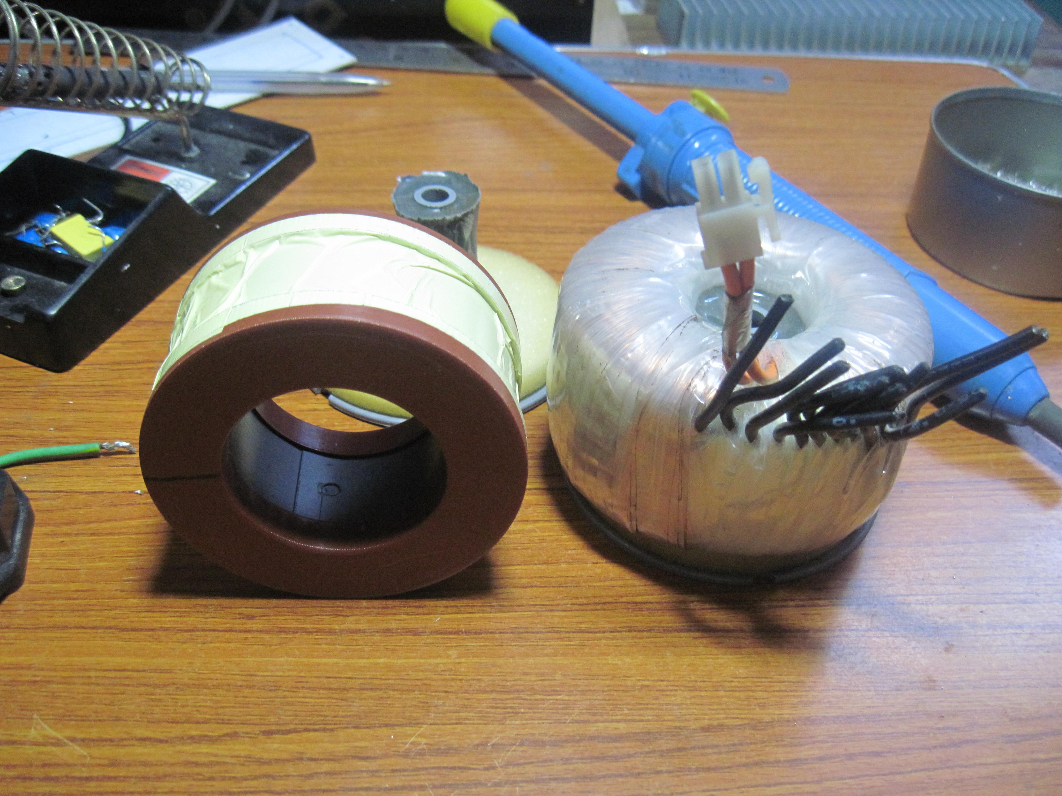

So My core is not more than 100VA. But every page of manufacturer of Toroidal core says Toroidal core is 50% lighter than EI Core with same VA.but My core is 1.84kg. Core manufacturer says 1Kg/100VA core wet required.what's your thought.
Why can't I calculate Maximum VA of core in Toroidal transformer like in EI lamination core I can calculate Final VA by just doing E center leg width*stack height and square the result I get maximum VA of EI lamination core.I wind EI transformer of 14.72cm2 Core area its maximum VA is 216VA and i get secondary out 45/3.7=166VA almost 75% of maximum capacity.

Toroid steel can generally support a higher flux value and that results in lighter cores.
Using V/Turn = 4.44 * Area * Bmax * Freq gives 4.44 * 0.02m * 0.05m * 1.8T * 50Hz = 0.3996V/Turn or 2.5Turns/Volt for a good steel toroid.

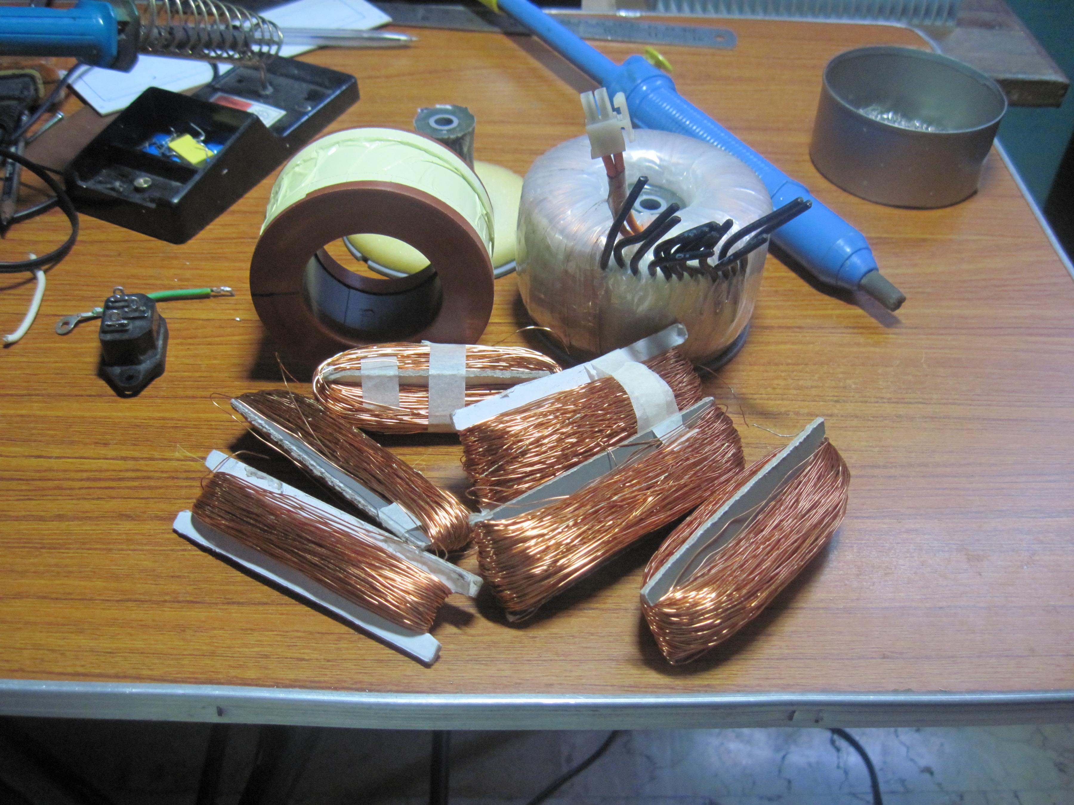

Once you have the V and turn/V you can choose wire to fit in. It depends on the winding capabilities how much area of the inner hole can be filled with copper, insulator and air, but nobody can tell this except for the person who will make the winding. This is his homework.

my rule of dumb for my traffo builds:
1. use 80% of available winding window for copper...
2. of the 80% of available window, 50% each of that for both primary and secondary...
but this is not written in stone, actual builds are different in a lot of ways...
experience teaches you a lot of things not otherwise obtained by mere asking
or reading books or searching the internet...
you got to have lots of actual building experience, only then can you
gain the confidence to move forward....
not by engaging in useless argumentations here...

Power handling capacity-Toroidal core
I found following link.They calculate Maximum power handling capacity of toroidal core.as bellow
VA=5.0*J*Bm*f*Ac min*ID²*10-7
where:
VA =Power handling capacity (VA)
J =Current density (A/ mm2)
Bm =Maximum induction ( Tesla)
f =Frequency ( Hz)
ID =Inside diameter (mm)
Ac min =Effective cross sectional area (mm2)
If I enter My core values in that equation result is as follows.
VA= (5.0*3.1*1.5*50*1000*3600)*0.0000001=418.5
Is that means I can make toroidal transformer up to 418 VA.this website has all information about toroidal core calculation.

As regards the winding technique:
The wire passing through the middle of the core should be as straight as possible and each turn should be as close as possible to it's neighbour.
At the outer edge the wire tales up about 50% to 60% of the circumference and so each turn should leave a gap of approximately one wire diameter to it's neighbour.
The wire and the insulation should be VERY much TIGHTER, even though he was hand winding. Try hard to really minimise the gaps in the insulation and to pull tight on the turn being wound.
I don't understand what he was doing with the interwinding screen. It looked wrong to me.
The interwinding screen should in my opinion be a complete casing around the whole primary, but with an insulated overlap so that a shorted turn is NOT created. You could with some creative folding do this with one continuous sheet of very thin copper. I suggest it would be much easier to insert a half sheet into the middle of the core and fold it out around the inner edge and turning out over the top and bottom of the primary.
Then wrap an outer sheet that is wide enough to cover the outer height and the top and bottom faces. This can be tack soldered to ONE edge of the first inner copper sheet, to create the complete enclosure. The other edge must not make electrical connection. It must be carefully insulated so that vibration and the secondary tightening does not force the two "open" edges into electrical contact.
