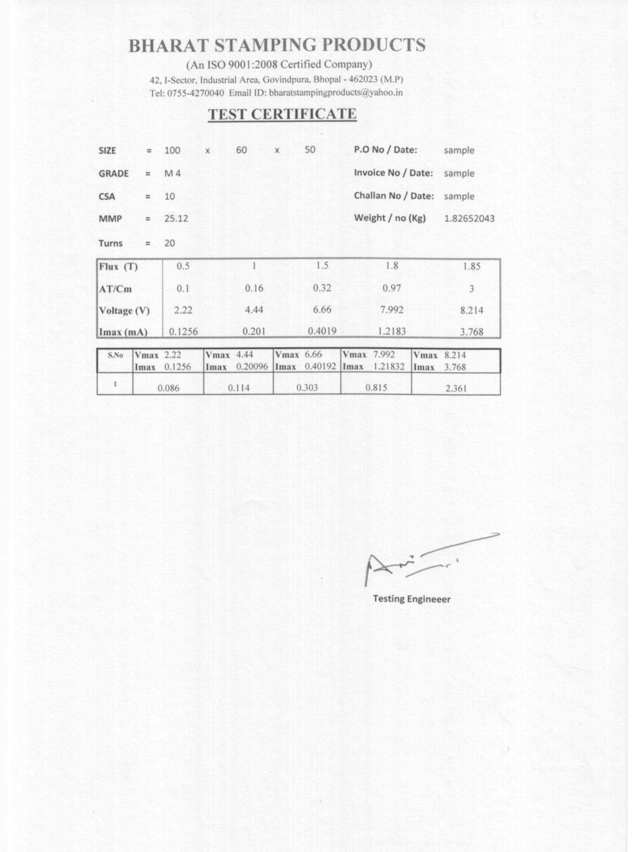

Technical document for core
Hear is Test certificate for my toroidal core
Now can anyone help me about core maximum VA rating.
You can use that test table to extract some guidance for your primary winding.
Take the middle set of values for 1.5T
Vac = 6.66 and Turns = 20
T/V = 3 and V/T = 0.333
You then need 240/6.66 * 20 = 720 Turns for a 240Vac feed driven to 1.5T
going across to 1.8T
You would need 240/7.992 * 20 = 601 Turns for a 240Vac feed driven to 1.8T
You can see from the currents that the 1.85T is too far into saturation.
But using that for 253Vac feed you would need 253/8.214 * 20 > 616 Turns to avoid that level of near saturaton for a maximum of 253Vac.
That would indicate you should probably use between 620Turns and 720Turns for your primary.
What is your worst case highest supply voltage?
That would probably require three layers of Primary winding where it passes through the middle of the core.
Do we need to insulate the three layers from each other?
Or can we rely on the inherent insulation of the 2layer enamel coating to give sufficient insulation on widely different voltages between the overlapping turns?
Some enameled wire is made with a 3layer coating for extra insulation, but I think it is not easily available.

Thanks AndrewT
If I use 1.5T then need 240/6.66 * 20 = 720 Turns for a 240Vac .But if I use 23 SWG(dim-0.61mm,current-0.76mA) magnet wire for primary than primary VA is 240*0.75=182VA is it ok to use that .or I have to use lower SWG to get about 100 to 130VA for Primary.How to primary magnet wire gauge chose without knowing Core maximum VA reating?
You don't know the final VA.
You would need to build the transformer and do what the manufacturer does. Test the idle current and idle temperature and see if they meet your specification.
Set to maximum resistive load current.
Check the temperature and regulation. See if those meet your specification.
If any fall outside, then adjust and retest.

You would have to wind on the Primary and the Secondaries and all the insulation to be able to test the temperatures of the core, the hottest part of the Primary and the hottest part of the Secondary. You can also check the regulation.Means I have to wind all calculated primary turn or just few turn with Difrrent gauge of magnet wire
You would only need the Primary to check the idle current.
You cannot do any other testing with only the Primary in place.
Why can't I calculate Maximum VA of core in Toroidal transformer like in EI lamination core I can calculate Final VA by just doing E center leg width*stack height and square the result I get maximum VA of EI lamination core.I wind EI transformer of 14.72cm2 Core area its maximum VA is 216VA and i get secondary out 45/3.7=166VA almost 75% of maximum capacity.
