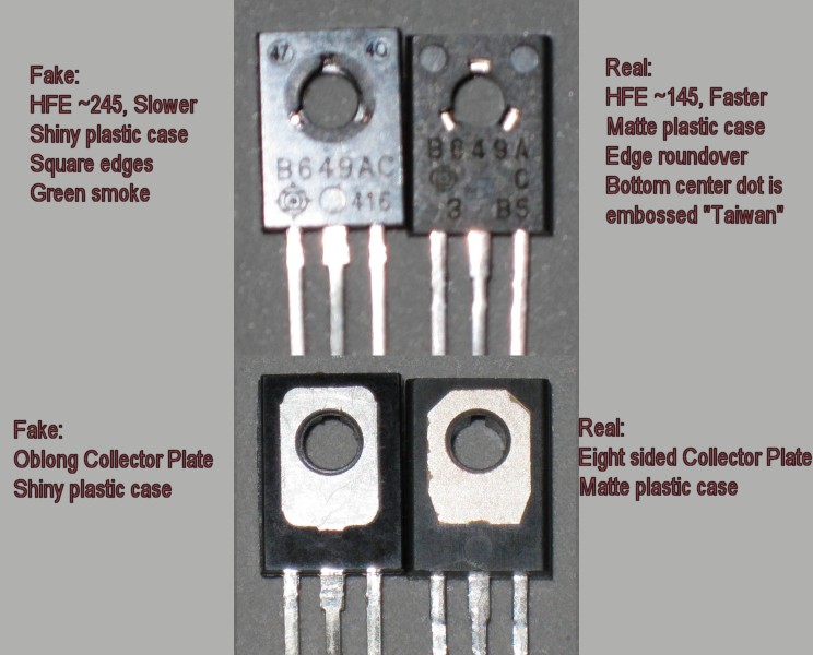

I found a post of user Danielwritesbac that might be conclusive.
There's a photo that shows the differences between a fake and a legit 2sd669. Mine looks identical to the fake one, same markings in same places. Also has a gain of 245-250.

What you have may be remarked BD139/140. In many applications, the user may never know the difference. Copper slug, good die attach, good encapsulation process, but may be a bit high on hFE (and capacitance).... but you put them in the circuit and it *worked*.
Sort of like using E-bay C5200's in an original DX amplifier. Yep, you can do it. Try that in an RMX2450 and you'll find the shortest route to your fire extinguisher.

MJE15032 seem to work great with "fake" 2sd669/2sb649, but on the other board I have the stock 200MHz drivers (2sc1384/2sa684) and it seems to be working good with no oscillation or other issues).
I think I'm safe with MJE outputs even if I use KSC2690/KSA1220.

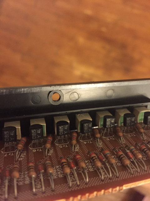

I found these while restoring a pair of Marantz speakers for a good friend. They are on a volume indication board driving LEDs. Seems stock so these would be genuine 2sc1815 transistors. Being 150mA I could use them for pre-driver H704 instead of 2n4401 (they would be proper ecb layout instead of 4401 ebc). I measured that transistor and didn't get more than 5mA through it. Interestingly I got about 14mA on the pre-pre driver (or whatever that is) H702. Made the measurements at 20Hz, 1KHz and 20KHz at max no clip power and max power total.
There are a total of 14 2sc1815 on two boards 🙂
I could also try and get the outer most ones that drove the max level leds as they are likely to have had the least work load of the lot 🙂

2SC1815's were used in countless pieces of consumer gear as general purpose NPN's.
None will have deteriorated, they will all be 'identical' and all the same as the day they were fitted.

I need to document a bit as the pre-drivers H704 were 2sc1318 that are 200MHz speed. 2n4401 are rated 250MHz minimum. They are faster than the 80MHz 2sc1815. Gain seems right between all.
