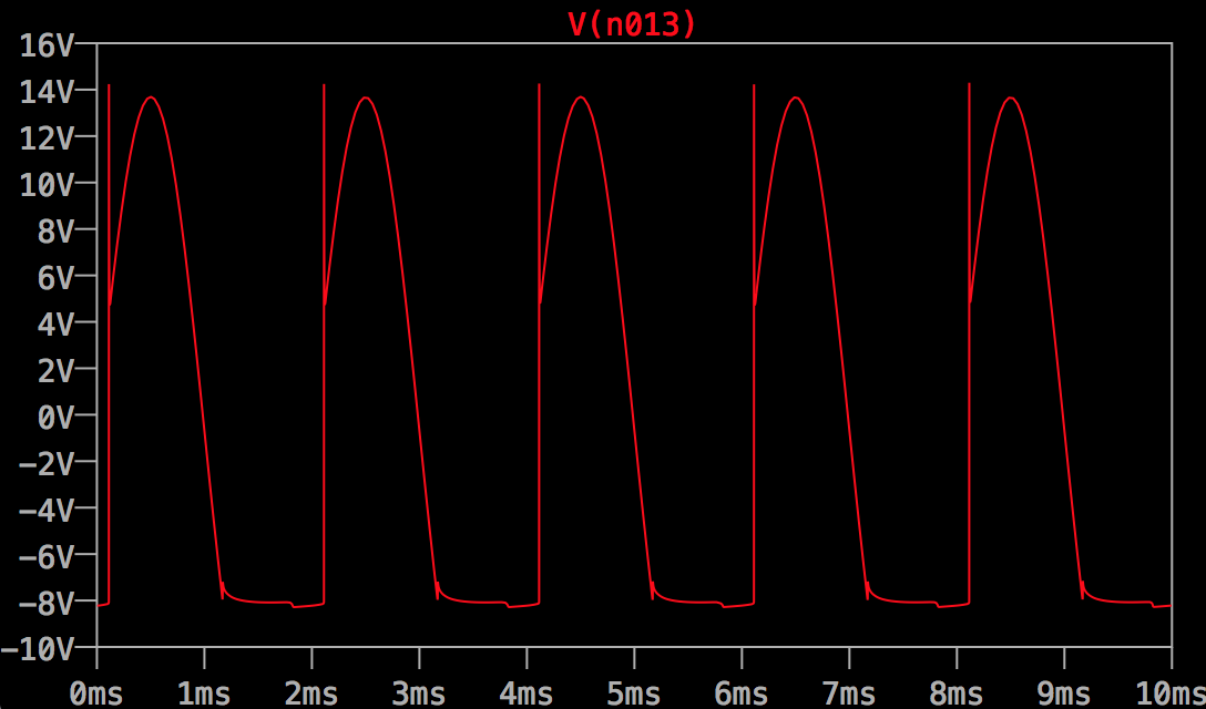

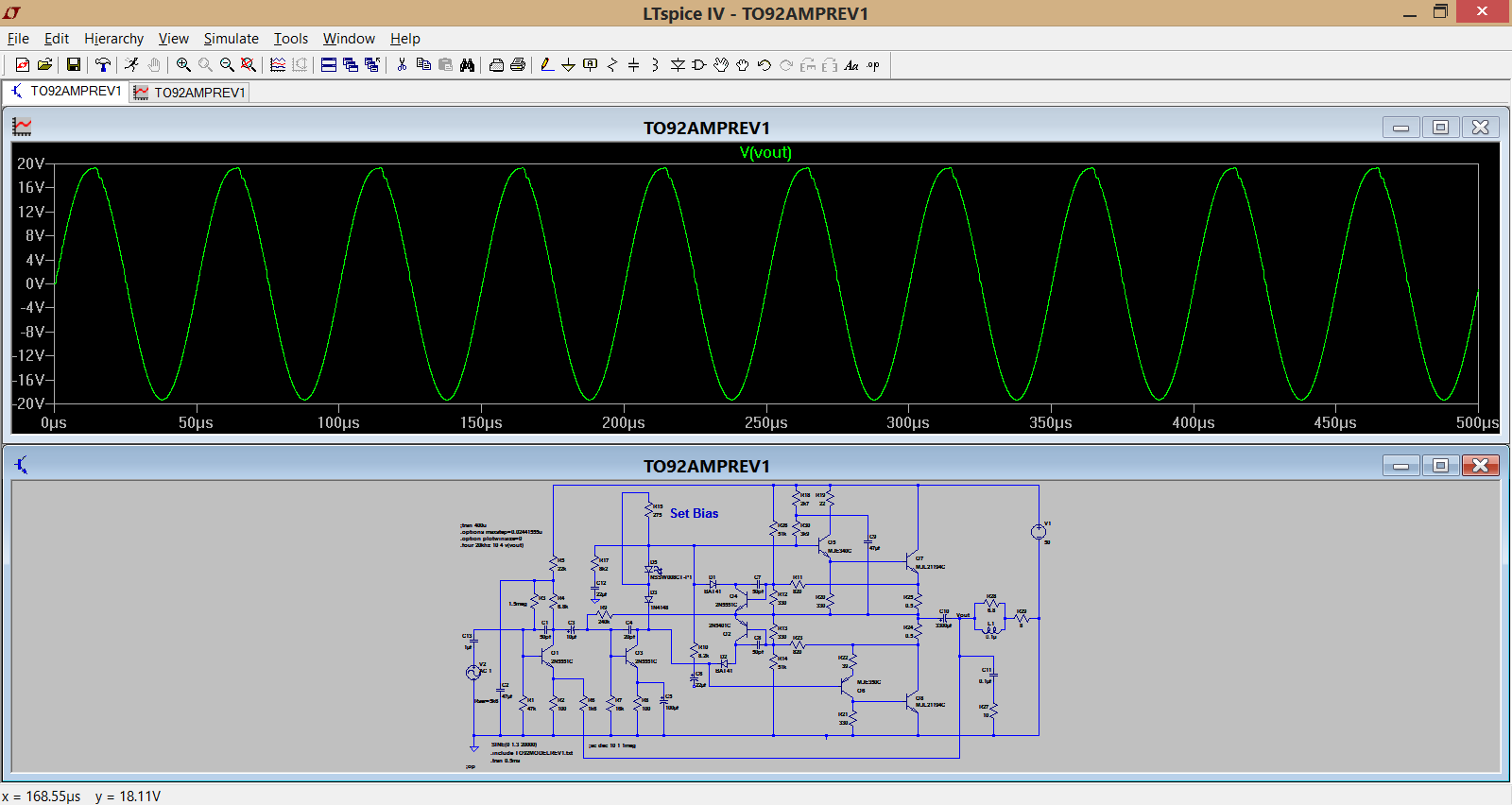

There's an issue with KSC2690. If I use it for driver I only have 1.48VAC input sensitivity.
At 1.49VAC the output gets distorted in a weird way. I can't seem to figure out where/why that happens. Other drivers have a bit more headroom.
Also the output doesn't appear clipped as other drivers do. Just this weird shape.

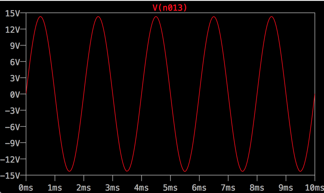

Why I asked you about the accuracy of Spice is because I remember when I measured last time the amplifier, with the rail at 51VDC I got about 22 clean watts into 8ohm. That translates to a Vpp of 37.52VAC. Right now I see that in any way that I test the setup with different drivers I only can go to 30Vpp before clipping. That 20% off versus what I measured in my setup. Also all my resistors are 1% hand matched to better, caps and transistors as well tried to match or close as possible to spec.
Weirdly enough, MJE15030 measures better for output until clipping. still about 15% off versus what I measured (with both DSO and analog scope). Seems pretty high margin.

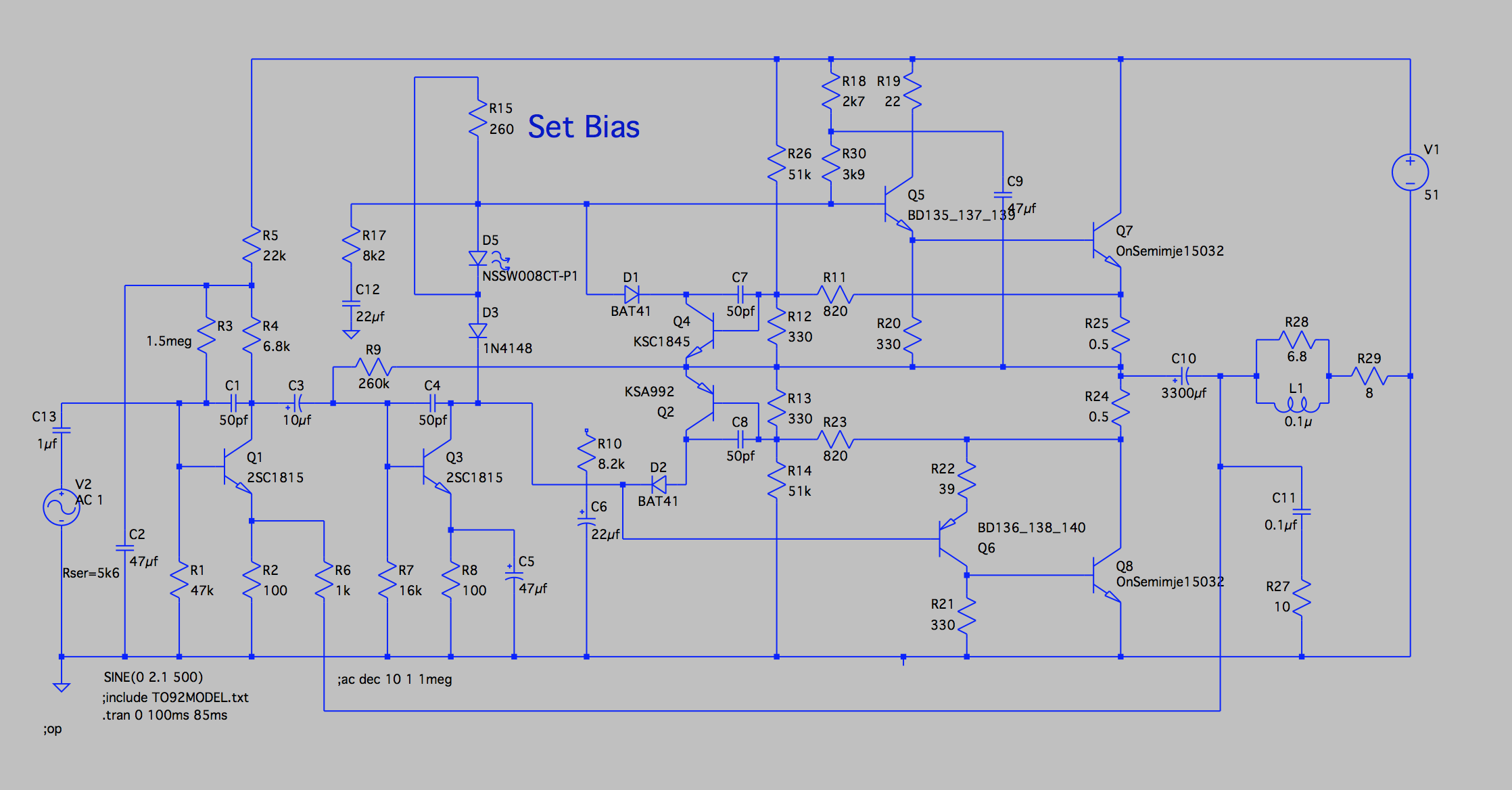

I can squeeze around 40 volts pk/pk from this design but only by a little modification.

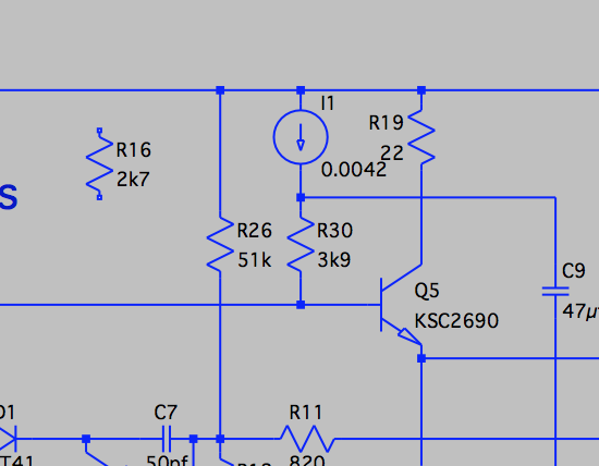

Look at R10 and C6 on the sim. It might be worth checking that those values are what are actually in the amp. The effect of these components is to artificially load down the VAS (voltage amplifier stage) which limits its voltage swing. I don't know why that has been done in the original design.

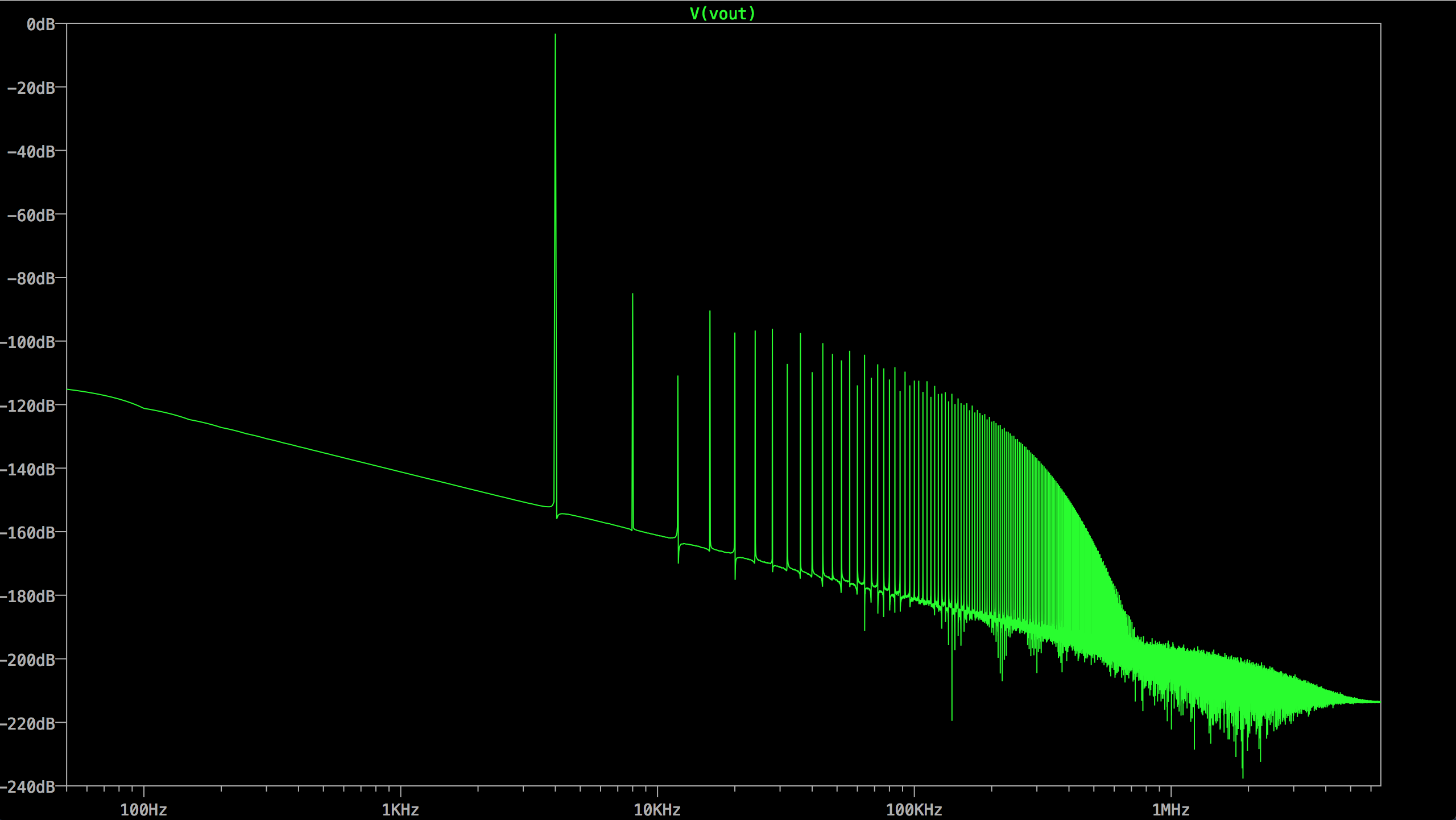

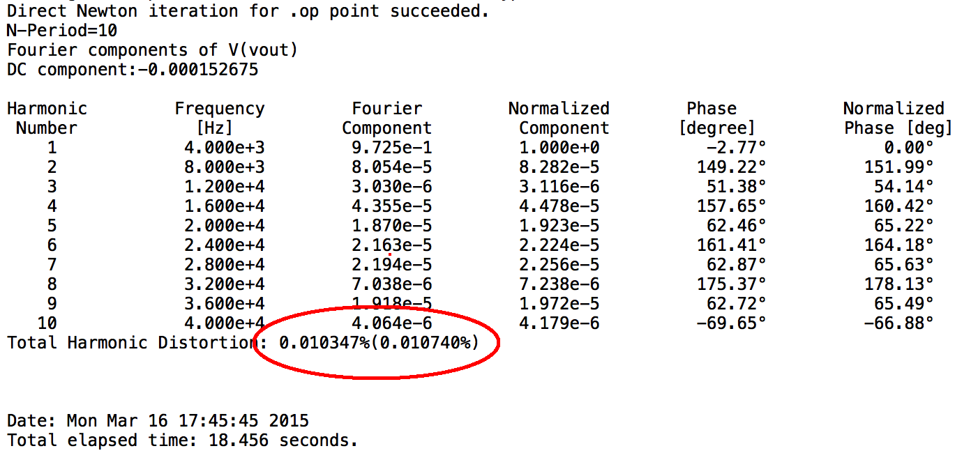

Distortion and FFT's (have you been working through this ?)

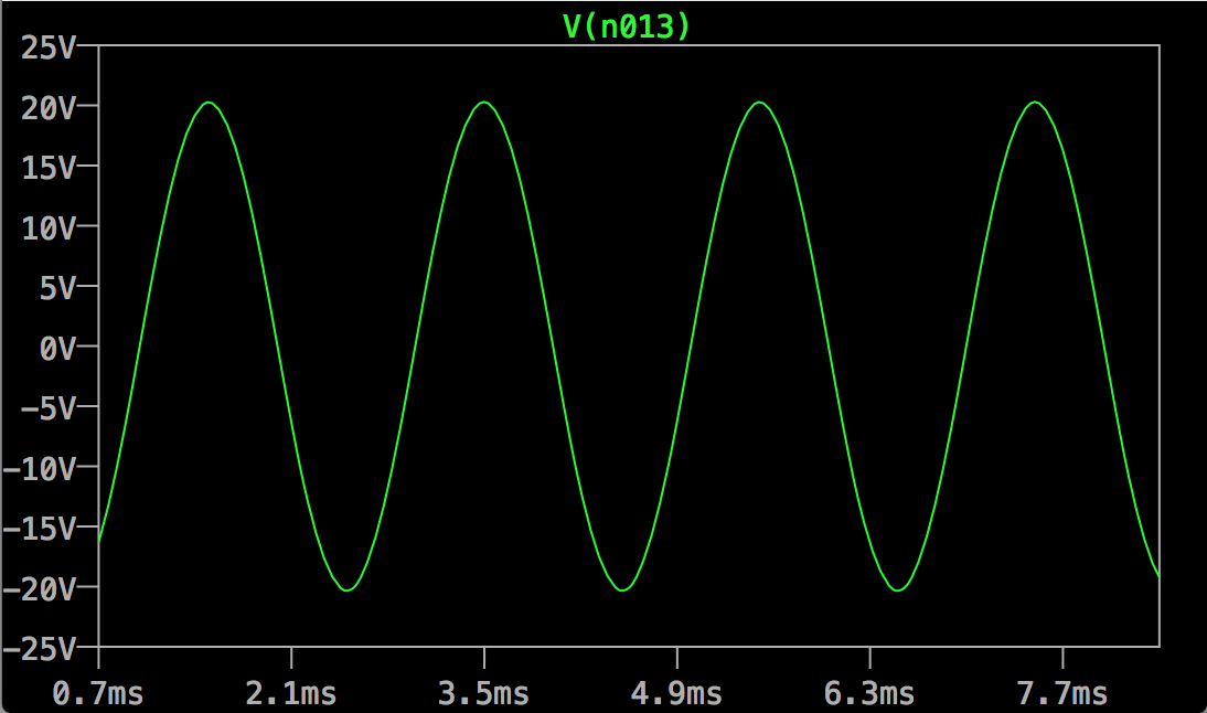

Yes, that was the issue! Good spotting.
Now it makes sense, I can up it until 40Vpp or so, just like I measured with the scope. The input sensitivity seems to be 2Vpp.
So now yes, it's very close to reality. This is great!
I was looking at the current of the 2n4401 pre-driver and it's pretty low! 7.5mA or so at max volume. I could safely replace that with KSC1845 (50mA part) if the Ft is ok (100Mhz vs 200Mhz). I will simulate some more.
The pre-pre driver has 1.6mA peak, and 1.2mA usually at max undistorted volume. That can be left KSC1845.
For my setup bias is at 280ohm (about 20mA), drivers are ksc2609/ksa1220 and outputs are mje15032.
I discovered that the clipping pot plays a role in drivers clipping instead of going crazy. I have to keep it at 280Kohm to sim good. There is already a 150K resistor in series with 200K on the pcb so the difference of 130K is well within the 200K pot.
For bias it seems that on my pcb there's also a series resistor installed so I can just play with that if I don't have enough room.

What would be a good result? And a decent one and a bad one? Regarding distortion/noise.
Also at what amplitudes should I test it? Low level/mid/just before clipping?

You might lose out in other ways though. Remember the current source in LT is perfect. For a real one you might find you lose some voltage swing... remember this amp uses a bootstrapped load for the voltage amplifier. If you measure the voltage at the junction of those two resistors under full drive you will find it higher than the supply voltage alone. A real current source may not behave and allow that.

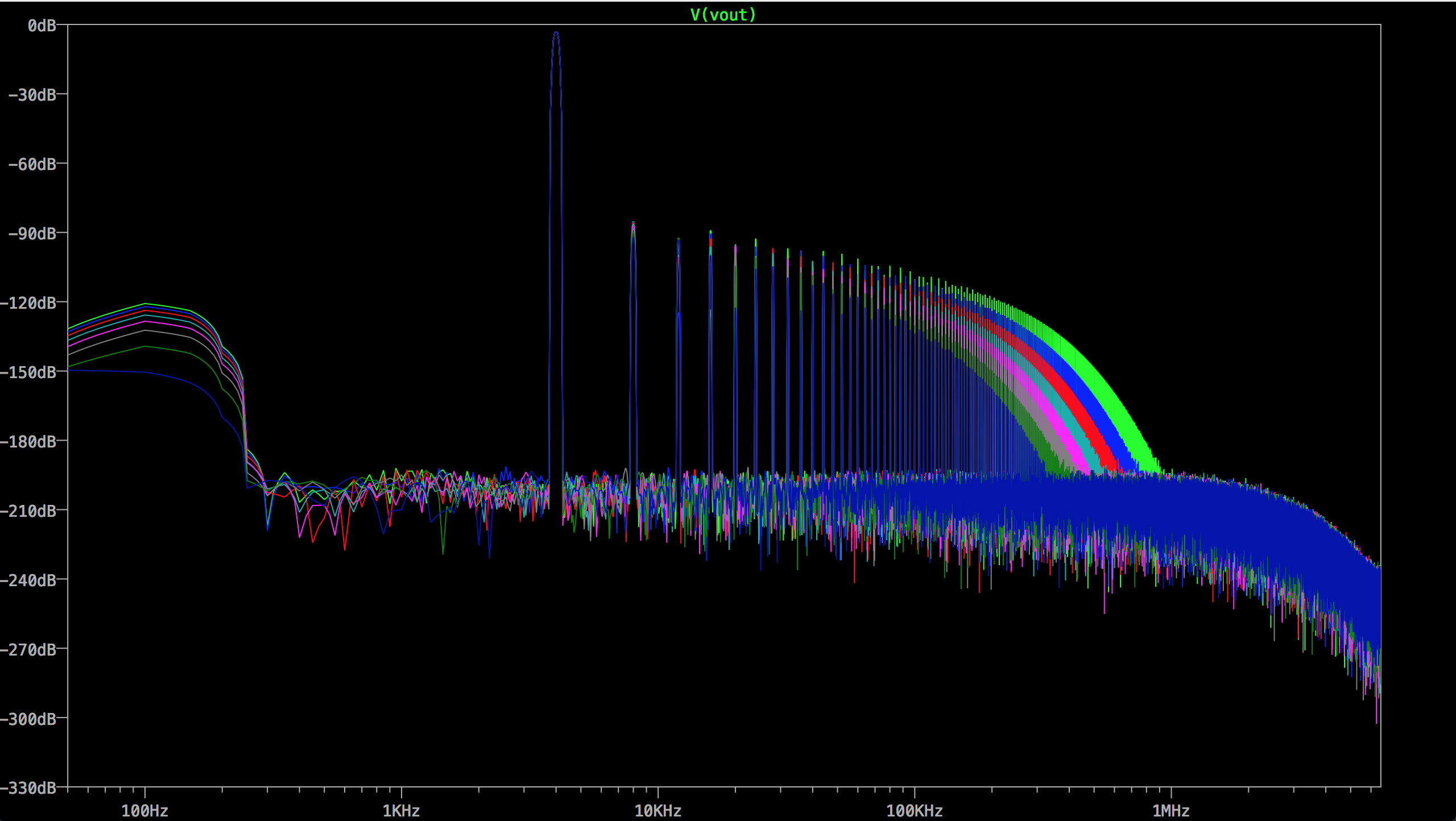

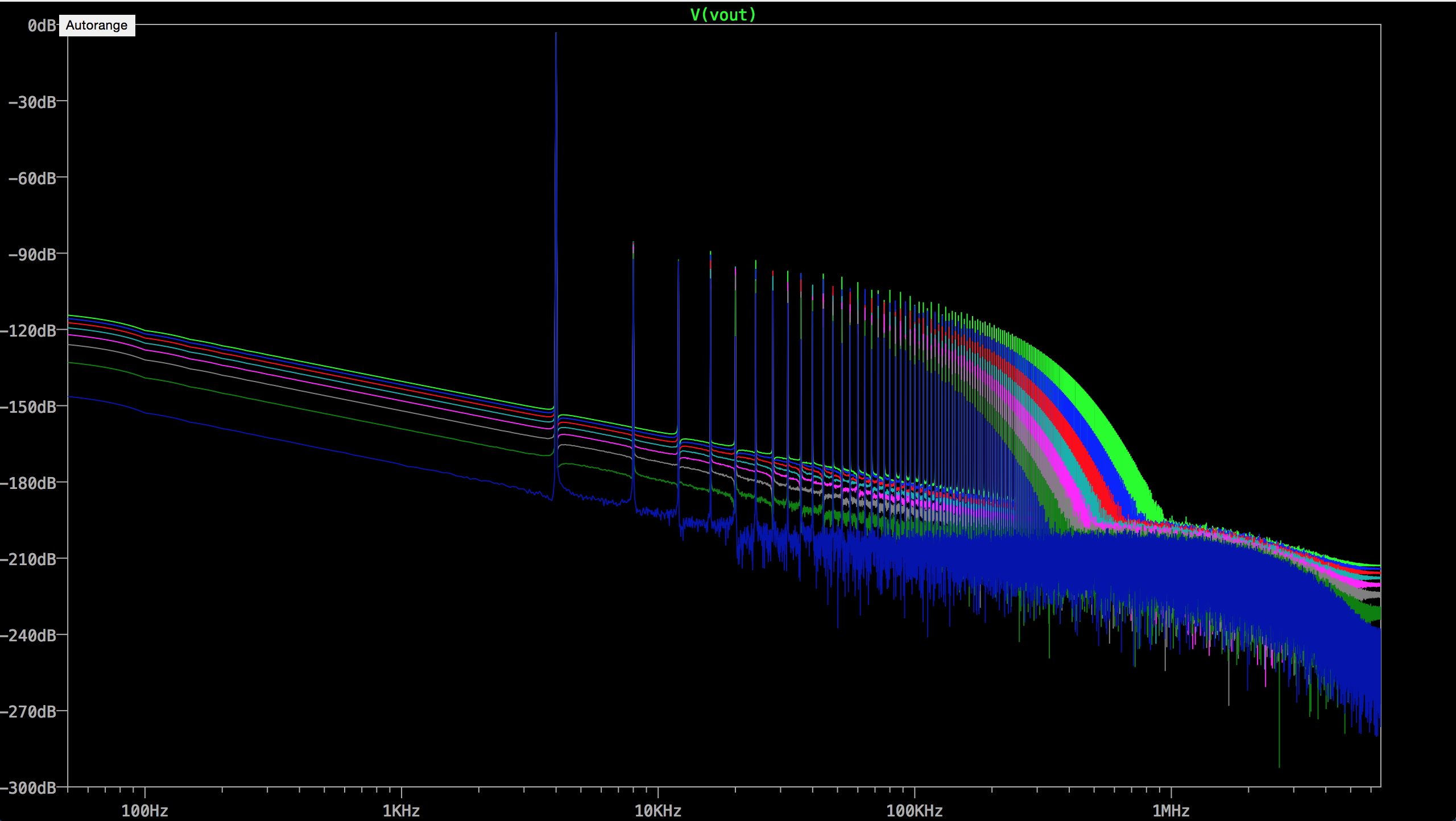

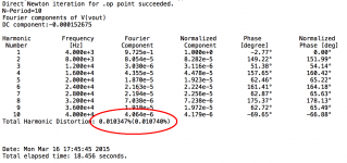

I made a sim with different bias current (resistor).
Starting from 13.9mA (green) to 52.8mA (blue). Also a flat top window.
It seems that as the current increases the 2nd order harmonics decrease, 3rd order increase and 4th decrease as well.
