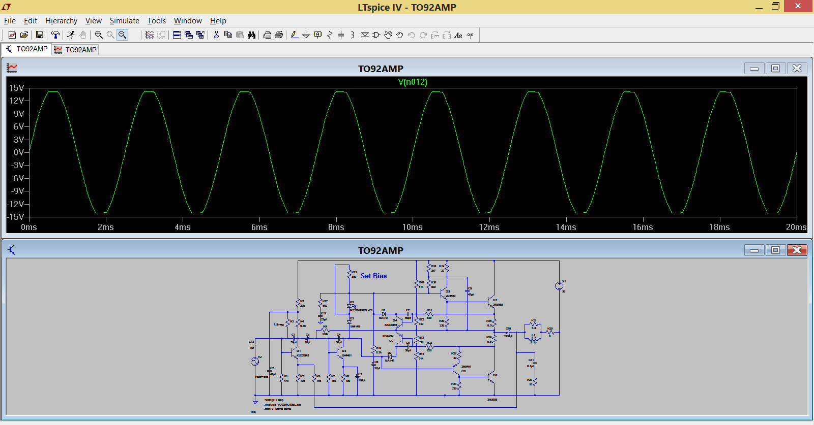

More little problems than I thought, lol it was just like fault finding for real.
Easy ones first.
1/ The AC voltage source is 'perfect' in simulation and that means it has zero ohms impedance. So you needed a coupling cap to stop it shorting the base of the first transistor. I also added 5.6k of impedance to it.
2/ Your 1.5meg at the input. You had 1.5m which is 1.5 milliohms, a dead short 😀
3/ Caps. You had entered some odd values for parasitics that made some of the caps appear as a short circuit.
4/ The models. To use the models in your list/s you need to include the name of the text file on the sim. You'll see how I have done it. I renamed the model file and used the .include statement. I added the diode model to the others, you can have them all one sheet.
The output and drivers you picked (your models) work but very poorly. I've used the standard devices included with LT for the output and drivers. Put your own back and try them though.

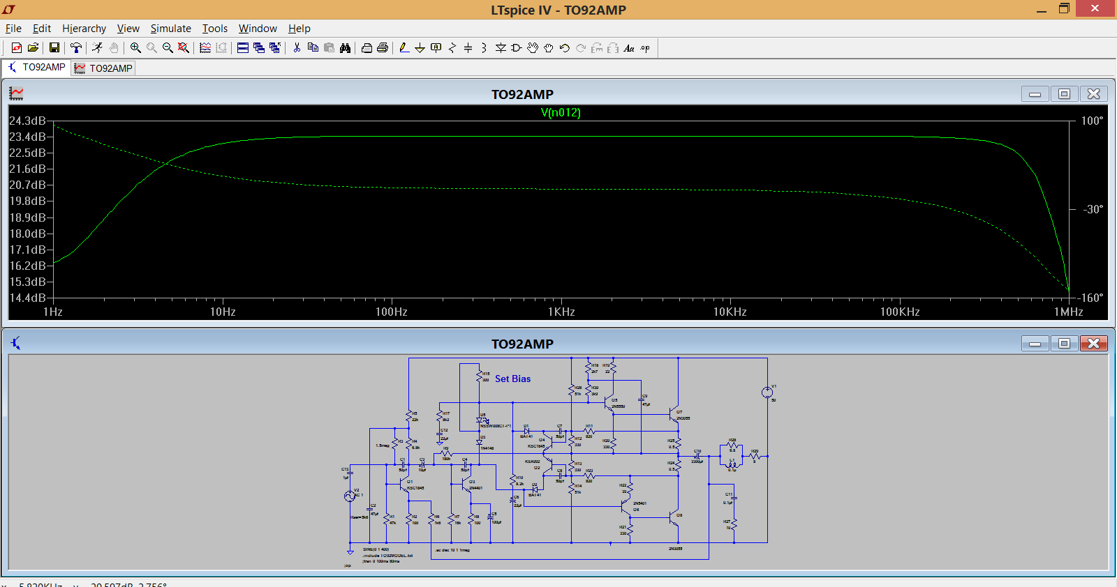

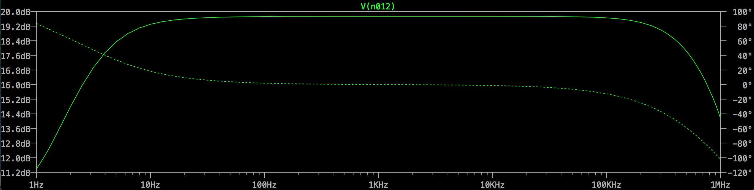

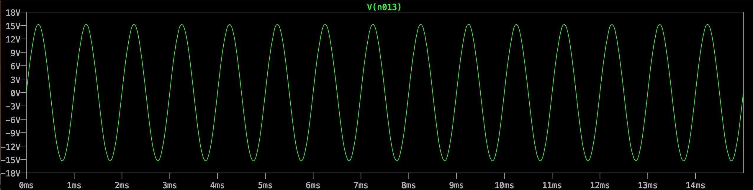

This shows the amp at max output (clipping) which looks about right given the topology. The bias network needed 'more volt drop' so I picked an LED. Also shown is the overall response.

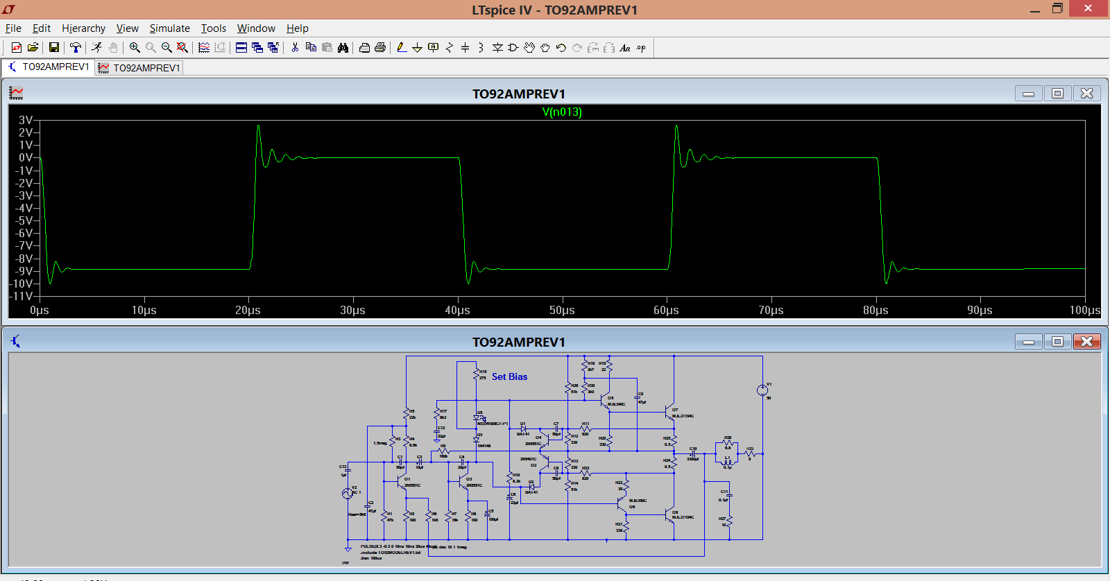

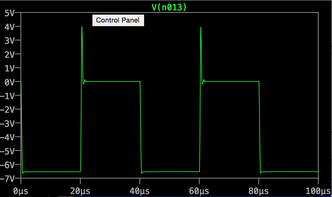

Try this one, squarewave response at 25kHz. Now try changing C4 up and down in value. Try 20pf and 470pf 😉

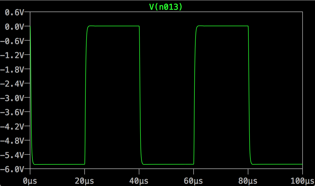

I just replaced the models with more proper ones. I had the model for 2sc2690 but now I found the Fairchild KSC2690 that I'm actually going to install, and it models better.
Also I got proper models for MJE1503x.
Looks much better now. Try it with my models now if you can.
Also I've replaced the R6 feedback resistor (?) with 1K instead of 1.6K.
Spiky... but you would need to measure it for real on the working circuit.
When I modified the pulse signal I forgot to add the 5.6k impedance on the source.
At the moment that's 320pF in my circuit (220pF+100pF parallel).
Seems like it's a filter at 96KHz or so.
If I lower it to 100pF the cutoff freq is 284KHz. But the rise is sharper.
In this setup C1&C4 are 22pF. Lower than 10pF for C4 and Q3 oscillates. Seems like C1 can be 1pF with no effects. The result looks even better actually.
The picture is for 100pF instead of 300pF

C4 will be quite critical in the real amplifier. Yes, the 5.6k and 320pf will give a -3db point of about 89kHz but of course there are the other circuit elements as well that influence it.
It was never designed as a wide bandwidth amp and its better not to try and peak it up to much... you could end up worse off with regard to distortion and stability.
LT is very accurate but that accuracy depends critically on the models. If you substituted all the transistors for example, and say used the ones in my sim above (which used Bobs models) then I would think the results would be fairly close between sim and real if you were to fit those devices.

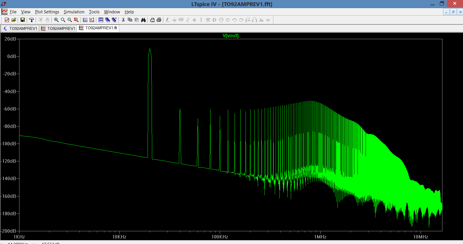

Have you tried any distortion simulations on it ?
I only used 2n4401 (from your models) as that's what I'll have at hand.
MJE15032 I got from OnSemi website and KSC1845/KSA992 and KSC2690/KSA1220 I got from Fairchild website.
I haven't tried any distortion test as I don't know how to do it/interpret it 🙂

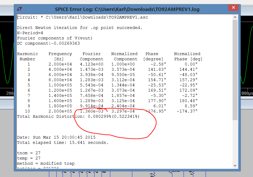

I'll tell you how to do the distortion tomorrow 🙂
This is 1 watt and at 20kHz. The slant on the FFT trace is because of the time constants of the caps. We need to run the sim for longer to get rid of that.
What you can try and get right is the bias current. I'm not sure what the recommended value was for this amp.
