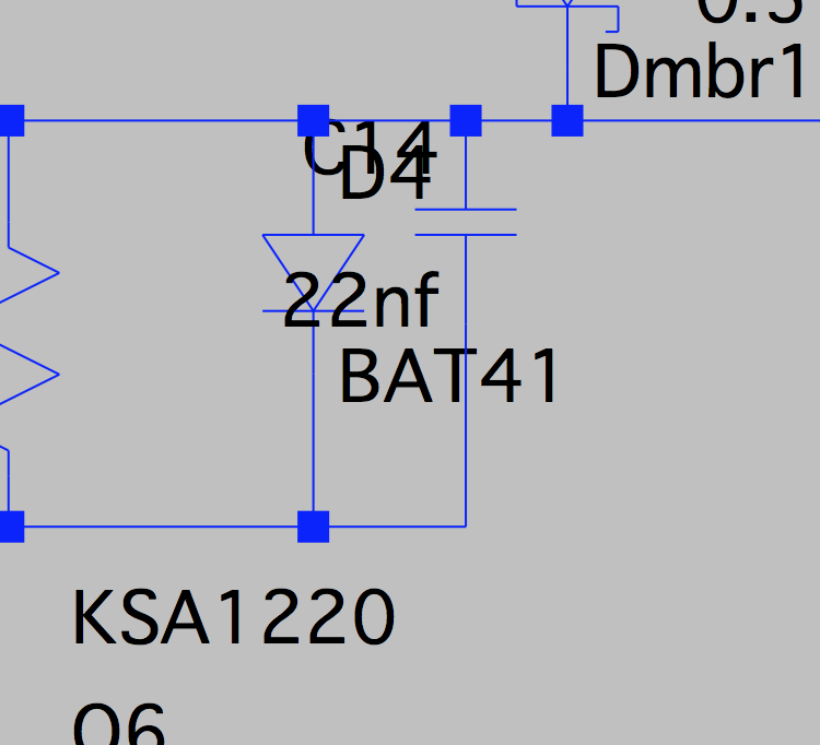

I also added a 22nF cap across the Baxandall diode. I saw it mentioned on different threads that it's recommended.
I will do the other channel and test with the board out and hope to get the right capacitor values. Also will make it without the 22nF cap and see how it measures.

I remember this cap from a topic where I saw the Baxandall diode discussed (or the diode parallel to emitter resistor). At least in a simulation that cap removed the oscillations.

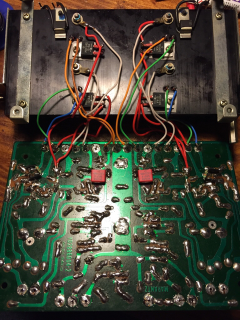

Now I'm looking on the pcb where I could install the 10uF cap, in a way that looks decent.
Thanks for the tip Mooly!
Btw, it seems I can go without a Miller cap on the driver in this setup. Are there any "disadvantages" to linking the 10uF cap between the bases of the drivers?
Ltspice shows an improvement in THD with the added cap. 🙂
A cap between the bases is fairly standard and simply maintains low AC impedance at higher frequencies. The open loop gain is helped along to. I can't say why it wasn't included originally, other than it obviously was deemed not necessary... but obviously it is now.
Make the cap look 'official' by putting sleeving on the leads and mounting it on the back of the PCB like a factory mod.
I thought about the backside but it will seat between the bottom of thc pcb and heatsink. I will check it out and see the best arrangement.
As long as it fits it will be fine. The cap only needs to be 16v working voltage so you can use a miniature one.

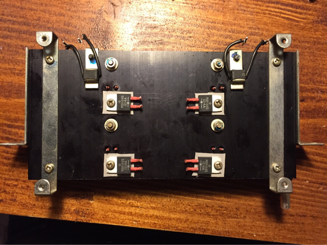

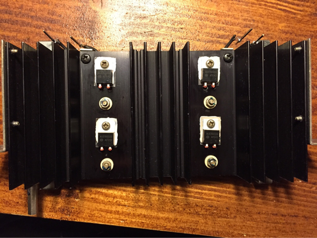

I've finished replacing everything and the unit is stable and working like a charm!
Very happy with the result, lots of work but it payed off 😀

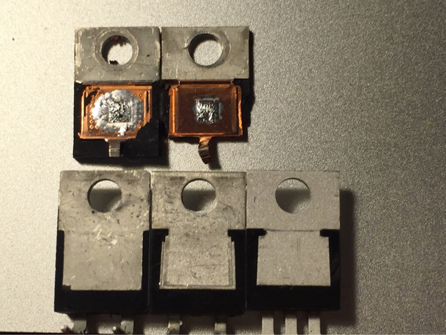

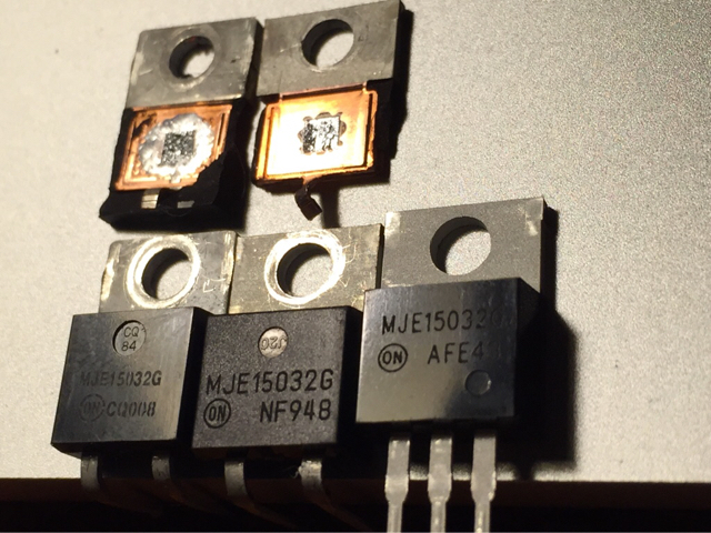

- to92 transistor replacement
