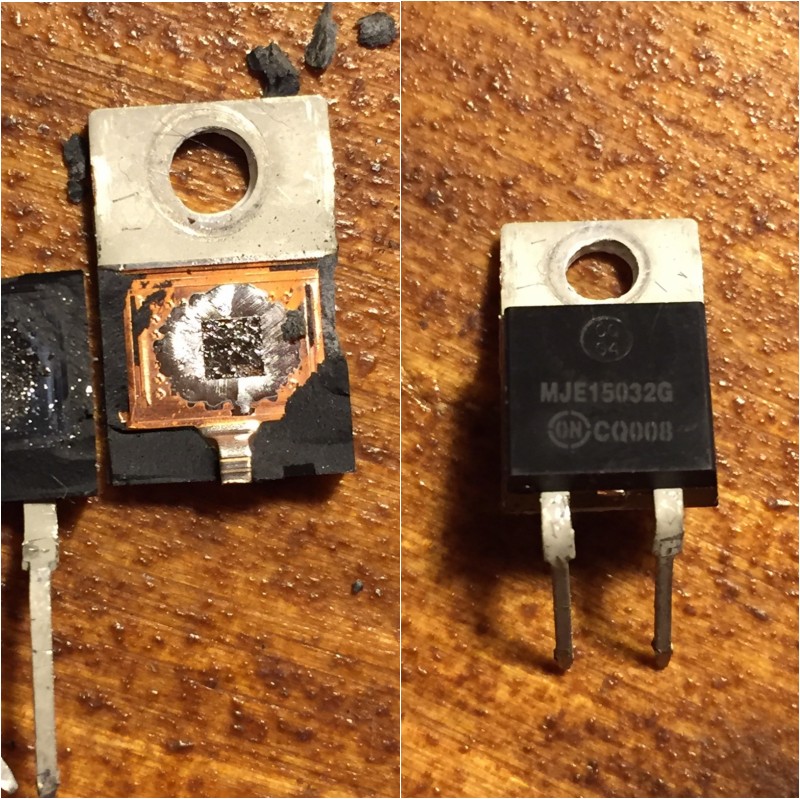

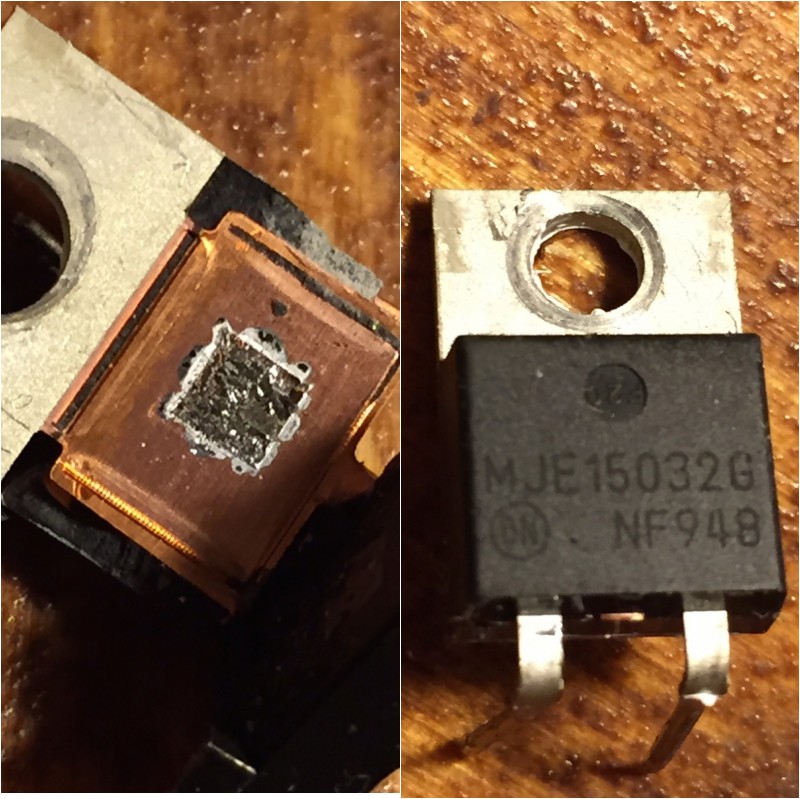

I decided to crack open two burnt output MJE15032 transistors. I found two types at the store, both in the same box.
Is any of the two a fake? Or at least a decent copy/implementation? I could replace them all for one kind if there's one legit.

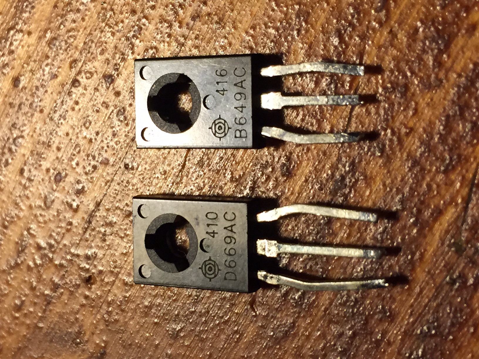

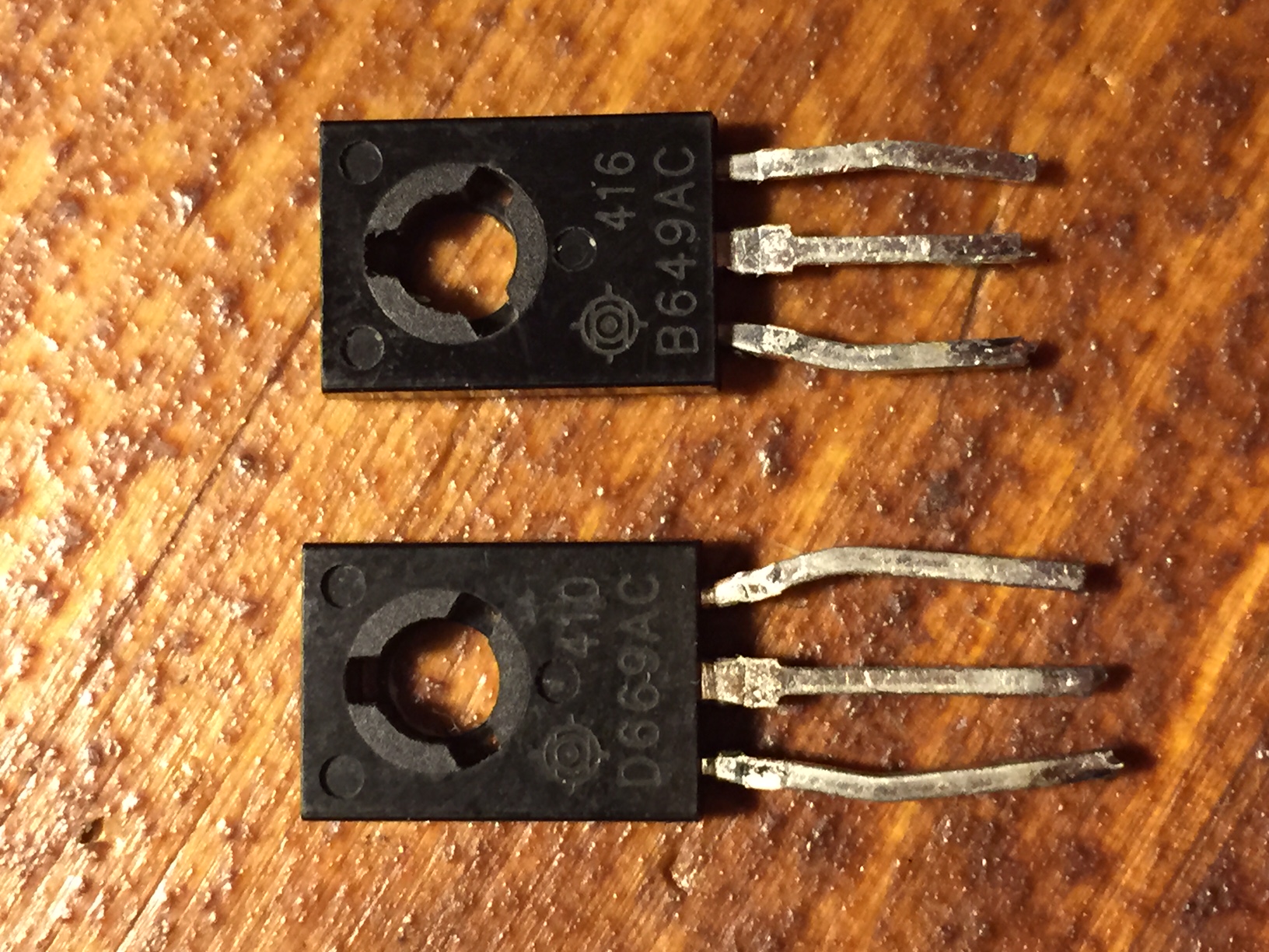

I will have to take both boards out again. The right channel to replace the 0.5ohm resistors that I burnt (and used the old ones from the amp), and the left channel I want to replace the driver transistors with 2sd669ac (which I don't think are legit as well)

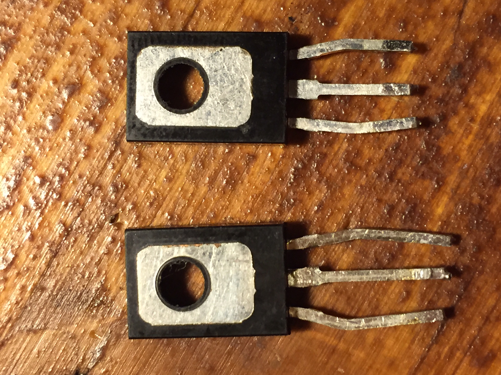

2sd669 has a gain of 245 and 2sb649 has a gain of 270 (made with cheap dmm function). As I read the original had a lower 170ish or so. They do look nice as a product, not a cheap clone.

Still need to crack one 2sd669 and see if the die is minuscule or something normal for that size.
The 649/669 are some kind of clone of the obsolete Hitachi.
But the originals are one of the highest SOA To126 ever available and outperform most T0220 for both power and speed.
That leads me to expect a "big" semi on the copper slug.
It would be interesting to see if what is actually used meets with my expectation?
Ok, then it's settled. When I get home I put the hammer on the 669/649.
ON has a couple of different pacakging facilities. Both look legit, but the 2nd one looks like a major QC problem. They used WAY too much silver epoxy to attach the die. That will increase the thermal resistance and make it run too hot (internally - the case temp will not go up).
Ah, ok. Then I will get the first type and have them all the same.
They are obsolete.Any leads to sourcing legit d669/b649?
Only clones and fakes are now available, unless some honest and benevolent Members have a stash of old stock that they are prepared to share.
These are not "clones". They are either NOS originals or outright fakes. "Clones" would not be marked with Hitachi's logo. The dies will in fact be small (under 2mm) even in originals. fT is high and capacitance is low, which requires a small die. And mm^2 per mm^2, small dies hold up better for SOA than large ones. You would need proper test equipment and methods to determine if they are real or fake unless it's extremely obvious from cracking one open. If they put in "cheap" BD139/140 dies in them, they would probably work fine in the application. The high fT, low Cob, and high SOA for this device type are highly desirable, but not essential in an amplifier with relatively low open loop gain and a single +48V rail. If you had a low enough fT (under 10 MHz) it may give you grief, but if it's even close to being in familiy it would work.

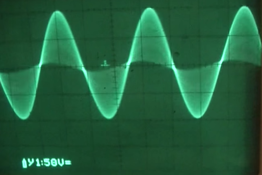

By pure chance I stumbled upon a screenshot of a waveform that looks exactly like my amp's at about 22-22.5khz.
It starts looking like this, then when I increase the frequency it goes down in amplitude (still looking like this) until it flatlines (even if the volume is way up). Then as I increase the frequency even more it starts to rise again (with maybe a phase shift) looking like this picture and it clears at about 23khz or so and looks great again.
