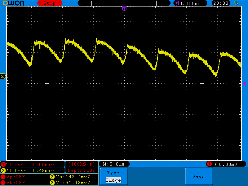

I installed 2SD669/2SB649 and I think it is oscillating. I added 470pF on 2SD669 instead of 500pF as it was on the 2sc1384.
I measured bias and I saw that the DC varied constantly so I scoped it (H001 emitter) and saw this.
In DC there was 100mA or so and I could adjust it but it was very sensitive and was droping fast. At min I still have a sawtooth waveform, but less in amplitude. Increasing the bias increases the sawtooth amplitude only, not frequency.
The frequency is 100Hz

Bd139/bd140 with 220pF oscillates as well.
