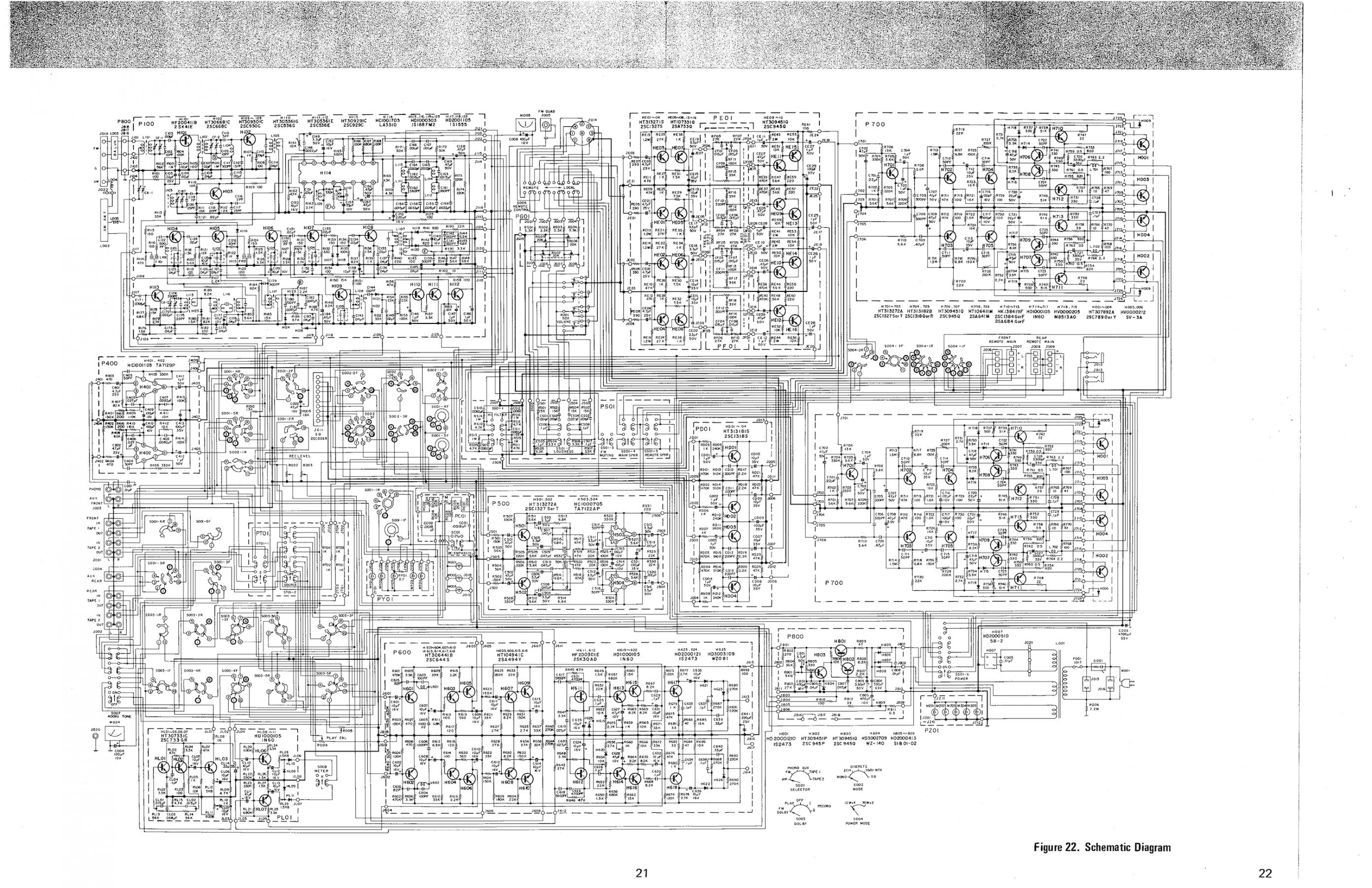

Bias altering and drifting is absolutely normal but it shouldn't 'suddenly' alter (like throwing a switch). If it does then that points to possible instability.
You need to set the scope up to monitor the input to the channel dropping out and see whether its front end or power amp trouble.

The bias jumps around constantly. It isn't stable for one second.. It constantly varies between 13-17mA. I tried upping it at 20mA and the same, 18-22mA jumps around. Also at 10mA. On all 4 channels. But I remember it doing the same before I touched it. The first thing I did when I got it was to adjust the bias.

The bias you will have to look into. Just a thought, if the bias generator isn't super stable (meaning its rail dependent to some extent) then mains fluctuations will reflect in the bias current. It should be immune but as its of a design of yesteryear when such things weren't looked at as closely perhaps, well you never know...... just a though as I say.

I'm almost sure it's a matter of cable connection to the posts. But I need to snoop around a bit with the scope and see exactly what's happening. A quick finger test might target the issue faster on the low level boards.

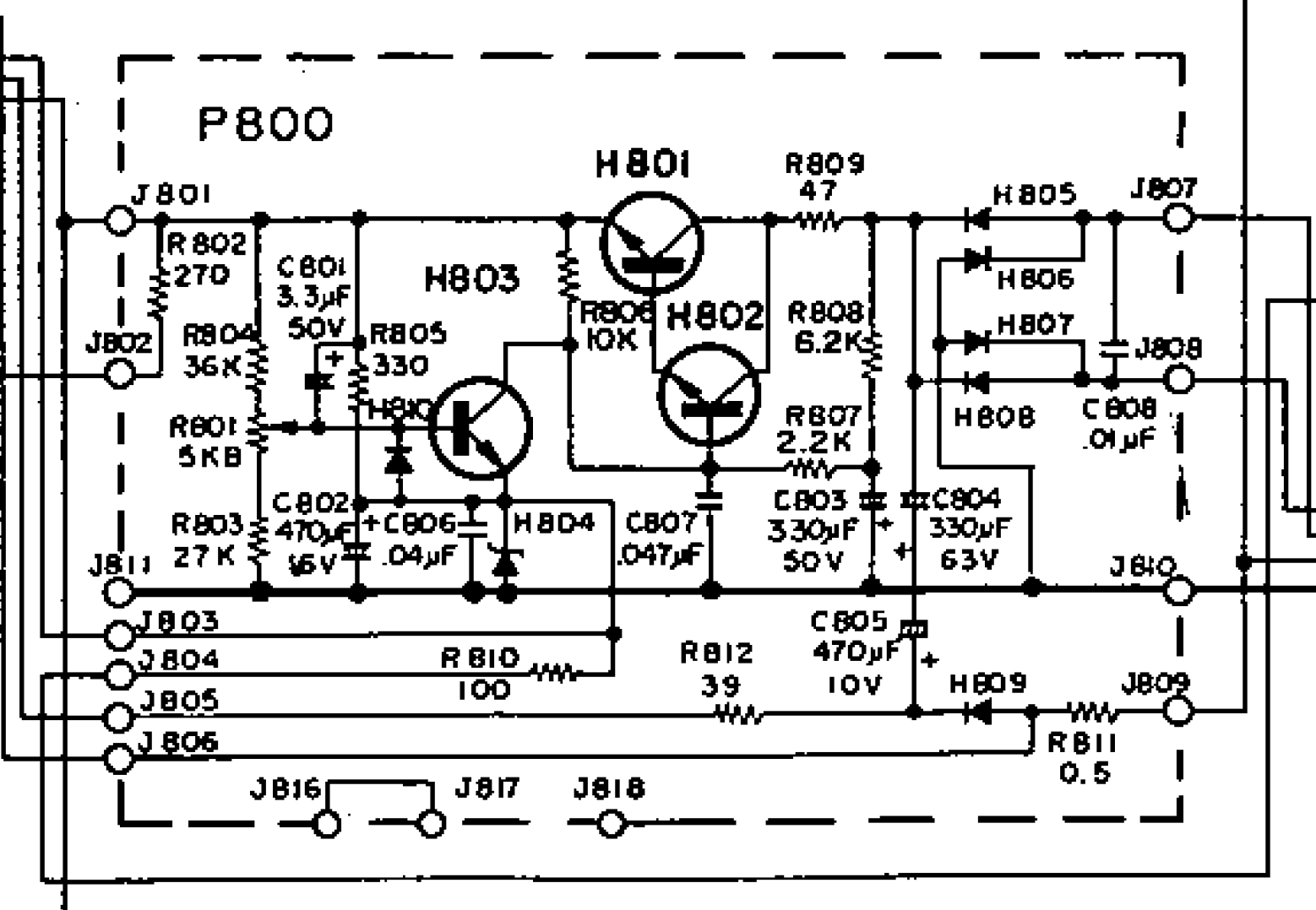

Right now I was thinking about that 220VAC vs 230VAC and decided to test the low current power supply. And ... yes...not great. 43.3VAC found on it. Rectified that's 61.22VDC. The output of the power supply should be 35VC so that's a 26V drop on the power supply.
I measured the filtering R809 and it has a 8.9V drop on it, putting out 2.4W of heat. In the datasheet that is a 47ohm/3W resistor, but on board was a 33ohm/5W resistor. I mixed them because I wasn't paying attention and now there's a 33ohm/3W resistor on the board, with increased voltage across it It's staying at a "warm" 145 degrees C. And it's right next to the large heatsink.

I measured the current draw (across R809) and is about 270mA right now. Way high for buffer + preamp. But those are not the only things drawing current.
On R802 I can see how much P600 + PL01 boards are sucking and that's about 57mA for doing nothing all day everyday. Those boards are the Dolby board and Dolby Tone&Meter board. Don't need those so I'll just disconnect them from J802 connecting point on the power supply board. That should give me a cooler 213mA draw.
R805 has 64mA going through it but that's needed for regulation I think and there's a line going to some of the small bulbs (stereo fm/am etc). R806 and R804 have negligible current, sub 1mA. That's a total of 148mA or so for the rest of the amp.
P500 board draws 0.5mA.
Ta7129 IC draws 3.5mA, so that's 7mA because there are two of them.
Phase inverters from the output stage draw about 3mA in total, measured.
Preamp draws 10mA measured.
Buffer can't be measured as it has no resistor in series on the input. I measured the higher wattage 2.2k resistors. 11mA through one and there's 4 of them so that's at least 45mA on the board.
That leaves about 80mA. I don't understand where that current is going to.
Is it something that I'm missing?

I will look at the output with the oscilloscope. I might design a new regulated supply altogether.
There's not much to be done, just 35VDC output. There's hardly the need for 7W.
The Zobel resistors are stone cold (R763-R766).
The transformer looks hefty, quite large for 2x30W output. I have some 100W 8ohm resistors that I'll use to see how much the power supply will dip, but should hold by the looks of the transformer. I will also check the voltage drop on the wiring. I replaced all wiring from bridge to each board and large cap. There's some wiring left from the bridge to some wiring posts where it meets the leads of the transformer.
