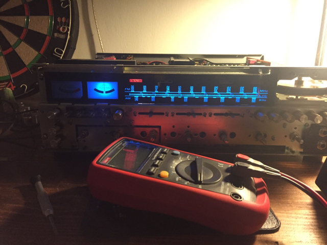

I am having a bit of an issue, not big but nevertheless it's troubling me a bit.
It seems that the rear left channel has a larger swing than the rest. I can dial it back from the balance slider on front. I have to offset that a bit to get it in alignment with the rest of the pack.
I will try and see what's happening in the low signal stages.
The only issue I'm having is that one of the 4 channels is a bit higher amplitude.
I traced it to the preamp board.
On the buffer board on JD01 - JD08 all signals are equal in amplitude (buffer is gain 1).
On the Tone amp board JE04 - JE02 - JE03 are equal, JE01 is higher.
I traced the issue to the balance pot board.
I measured the resistors I installed and they are all 3.3k. Signal going into the slider board is ok for all 4 channels, signal coming out is higher for one channel. With the sliders in their center position.
So it seems that one of the slider pots has an offset.
I will leave it at that and set it for equal signal after I assemble everything.
Didn't notice this before as I didn't measure anything in the amp.
So ... I'm happy with this result 🙂

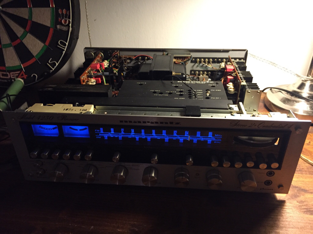

Looks good and it looks like you got the illumination pretty even which can be trick with LED's
I had an issue with the fact that the left side dials were brighter than the tuner dial. I had to up the resistance on those to make it even.
Here you can see the difference:
This is how the LED fixture looks like:
The incandescent bulbs were powered by AC so I got vlmw42 leds that have a diode across them and put them cathode to cathode. I do sense some 100hz flicker with the corner of my eyes without the plastic faceplate but otherwise it's great, I can't notice anything.
I will botch some parts on the back of the PS board if I find the flicker annoying. Adding caps was too complicated for the light fixtures. I only noticed them while the LEDs were exposed and only with the corner of my eye. With the plastic front plate cover on I didn't notice anything.
Also if I do make it DC then I'll only have one LED lit from the two in the setup depending on which way the current flows 🙂 right now each led covers half cycle.

A few observations:
Is it normal for the bias to not be steady? It kind of jumps between 13-17mA when set at 15mA. I noticed this behaviour before the restore. I saw this after one hour of continuous use at a decent volume.
Another issue is that it still seems to be dropping the right channel only now. I left it playing in the background now at low level and one channel was out. I tried turning the volume high but didn't got the channel back. I had to turn off the unit then turn it back on and it works now. Happened 3 times already.
I also used croc pliers to squese the wire on the connecting posts. Didn't do this on all connections, but did it on buffer board I think and some on the tone/preamp board. I tried soldering but it's really hard as there's many wires in the way and solder doesn't stick, even with flux applied.
