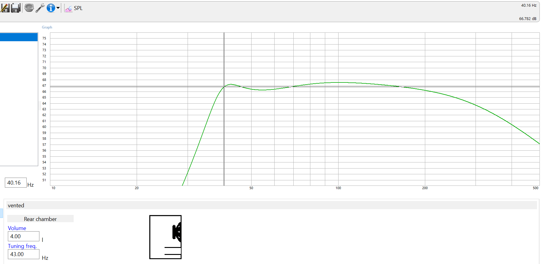

Have a look at this pic. I have dropped the ZR6 signal to 1w. 66db @ 40hz result. Still finding it hard to work out if that would audible on this system less than 1m from the ears. If this is a good result for what I am after, very near field output wise

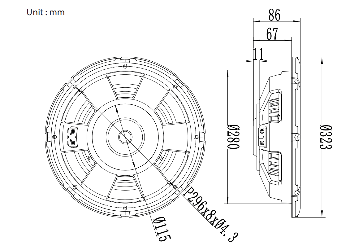

Ahem...Driver needs to have a mounting depth of less than 70mm. Any suggestions?
I have one of these myself. 67mm mounting depth, to this date it is the lowest mounting depth of any 12" that I have seen:

KaffiMann, I can quite see you running this driver in a tiny BR. The Vas is huge, and weirdly this is the case for all of these pancake type drivers except for the DS18 SRW. They model very well in tiny ported cabs. With the huge Vas, most of these drivers don't make sense to me as a space saver. I have tried simming all the way up to the $1000+ drivers. Give the SRW10 a go in place of your blam, see what you thinkAhem...

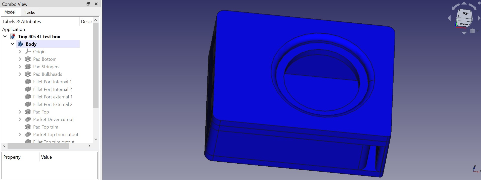

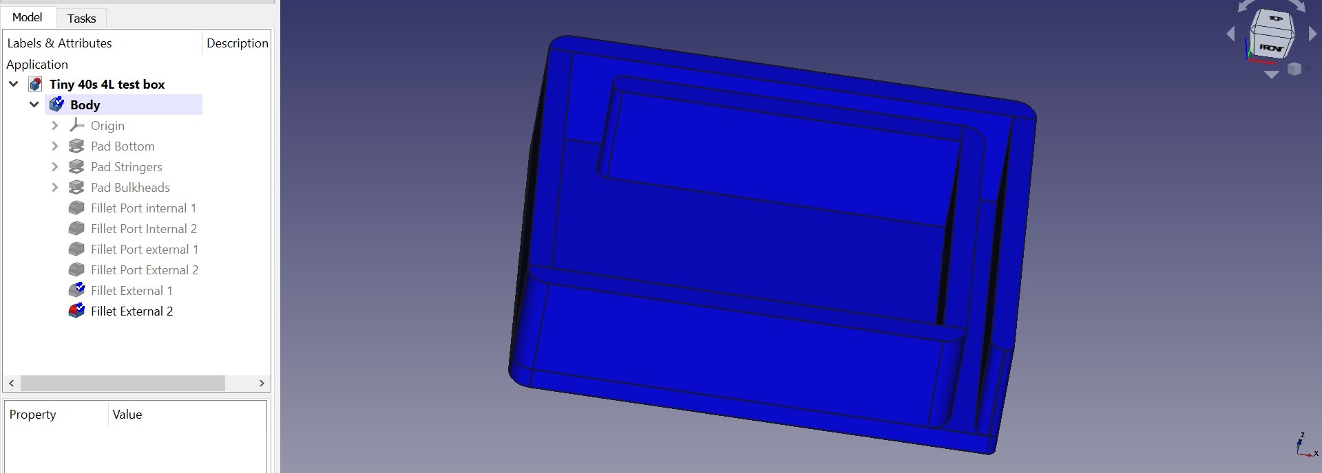

This is test box 2
4L net internal, 330x252.3x110mm external, 43hz tune. Ready to be made. Plans via PM
