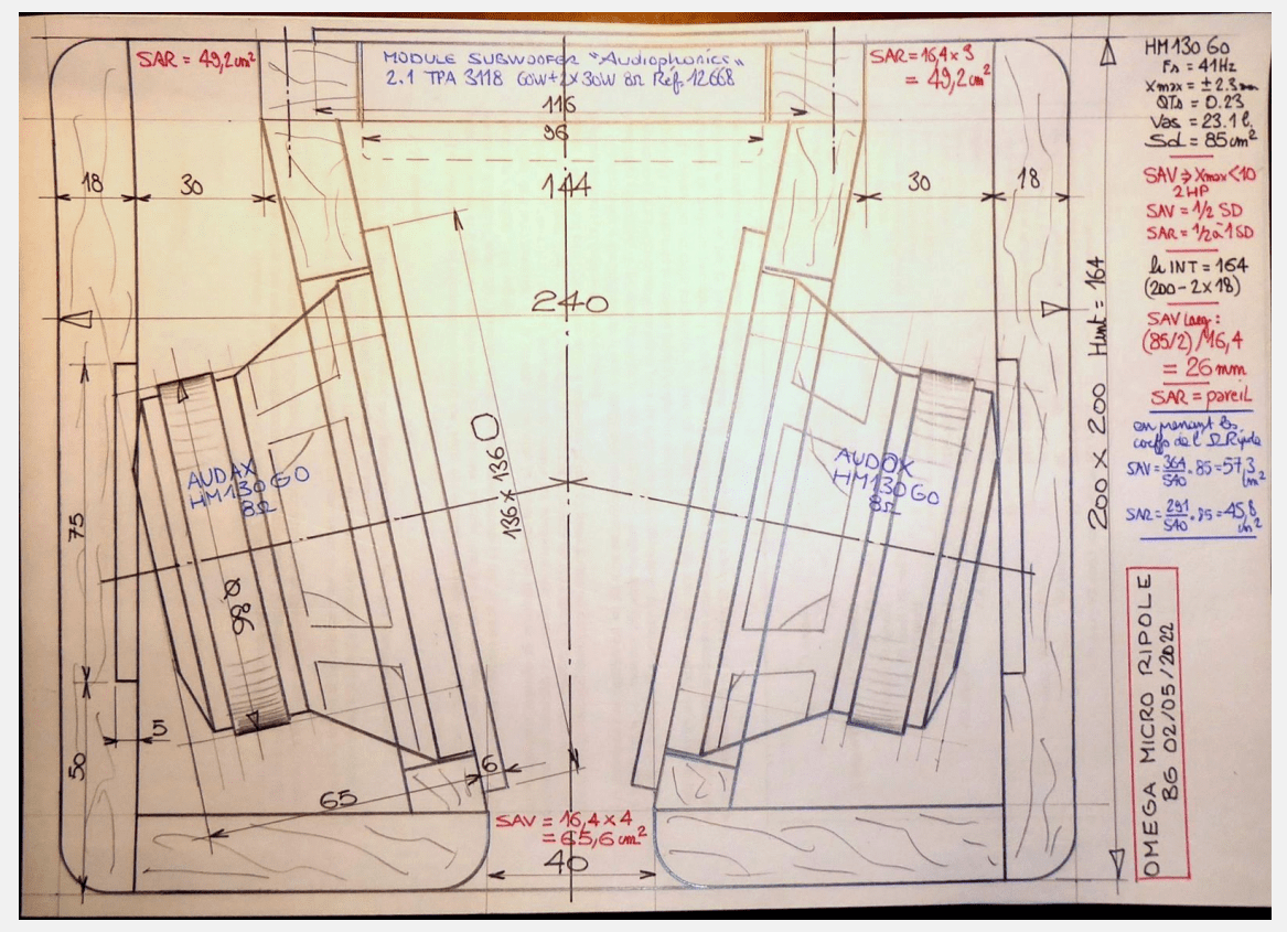

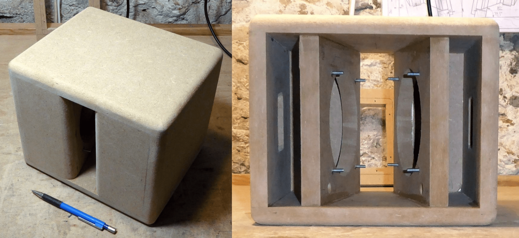

Very cool, is that under 4L for total net driver volumes? What is the F3?
My Omega Ripole Micro is derived from the original Ripole principle subwoofer (as invented by Mr Axel Ridtahler) :
The F3 is circa 30Hz, and it works fine if you listen at moderate loudness levels. The sole issue is to find a correct mini sub module, and the one I used was not : the integrated LP Xover had a poor slope and frequency adjustment.

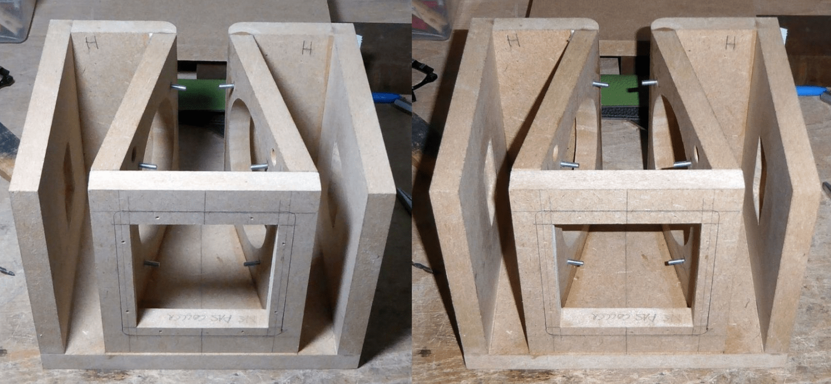

Nice, perseverance always wins. I have not come across this box layout, but it sure is interesting. With higher volume sound it may "walk around"a tad and some form of rubber feet may do the trick. Would love to see the final response curve from all around, as it may just be very close to a point source with those small dimensions. There should be no audible group delay as you cover less than one octave, nor any standing waves or even resonance. Fantastic little design in my humble opinion

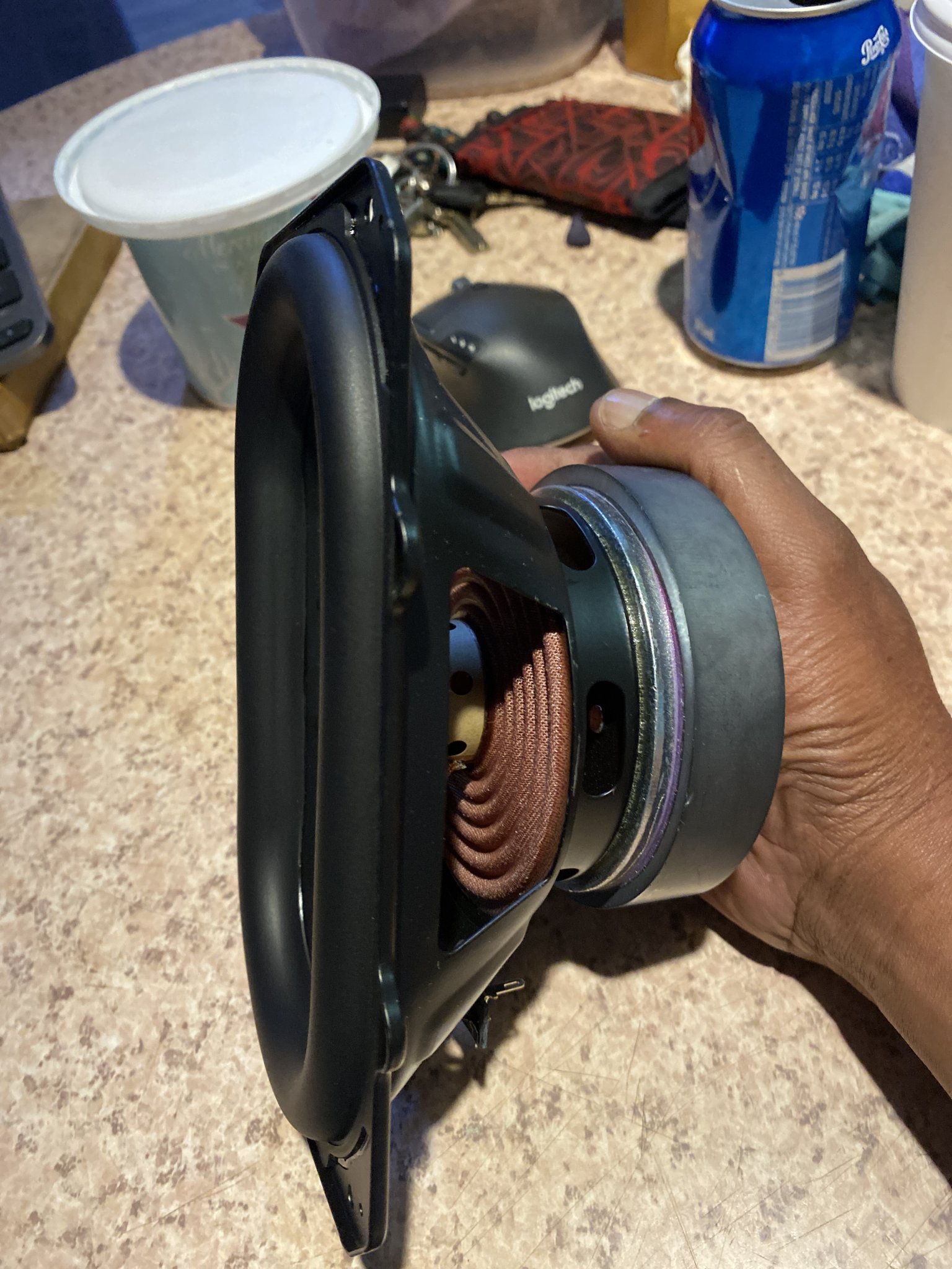

My money is on the racer driver taking the tiny crown, This thing is built like an oval piston with massive travel. Pity there aren't any specs on this driver. Its a replacement for a brand name boombox's sub section
