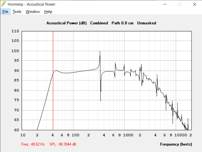

This is at xmax of the Tang Band W3-1876S, in a volume of under 2.5 liters, the materials will add some, but it's still a bit smaller than your 4 liter goal.
Doable, I recommend some chamfering on the port to help reduce a slight chuffing at max volume.
If you can splurge on some passive radiator you may get it to around 2 liters total since you do not have to waste as much space on the port.

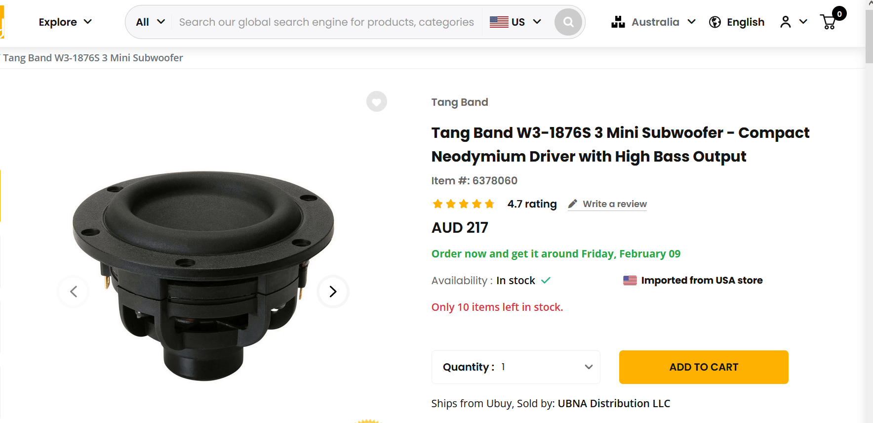

Yes, the Tang Bands were my first choice but the shipping from PE is much more than the driver to Regional AU so I gave them a miss. There are some very similar looking drivers on Ali that might model well, will need to get some in and measure T/Shis is at xmax of the Tang Band W3-1876S, in a volume of under 2.5 liters, the materials will add some, but it's still a bit smaller than your 4 liter goal.

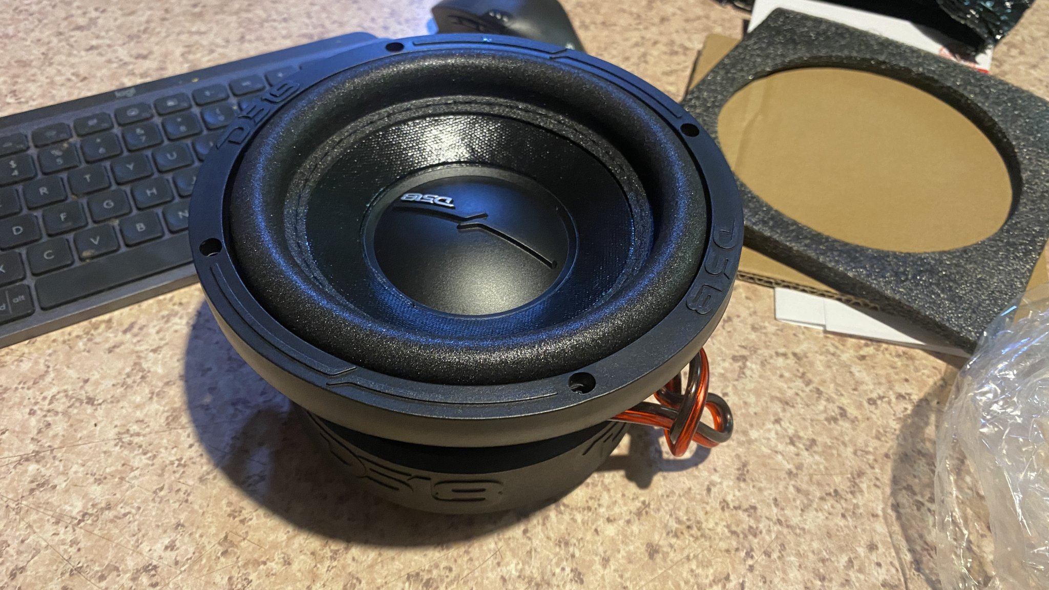

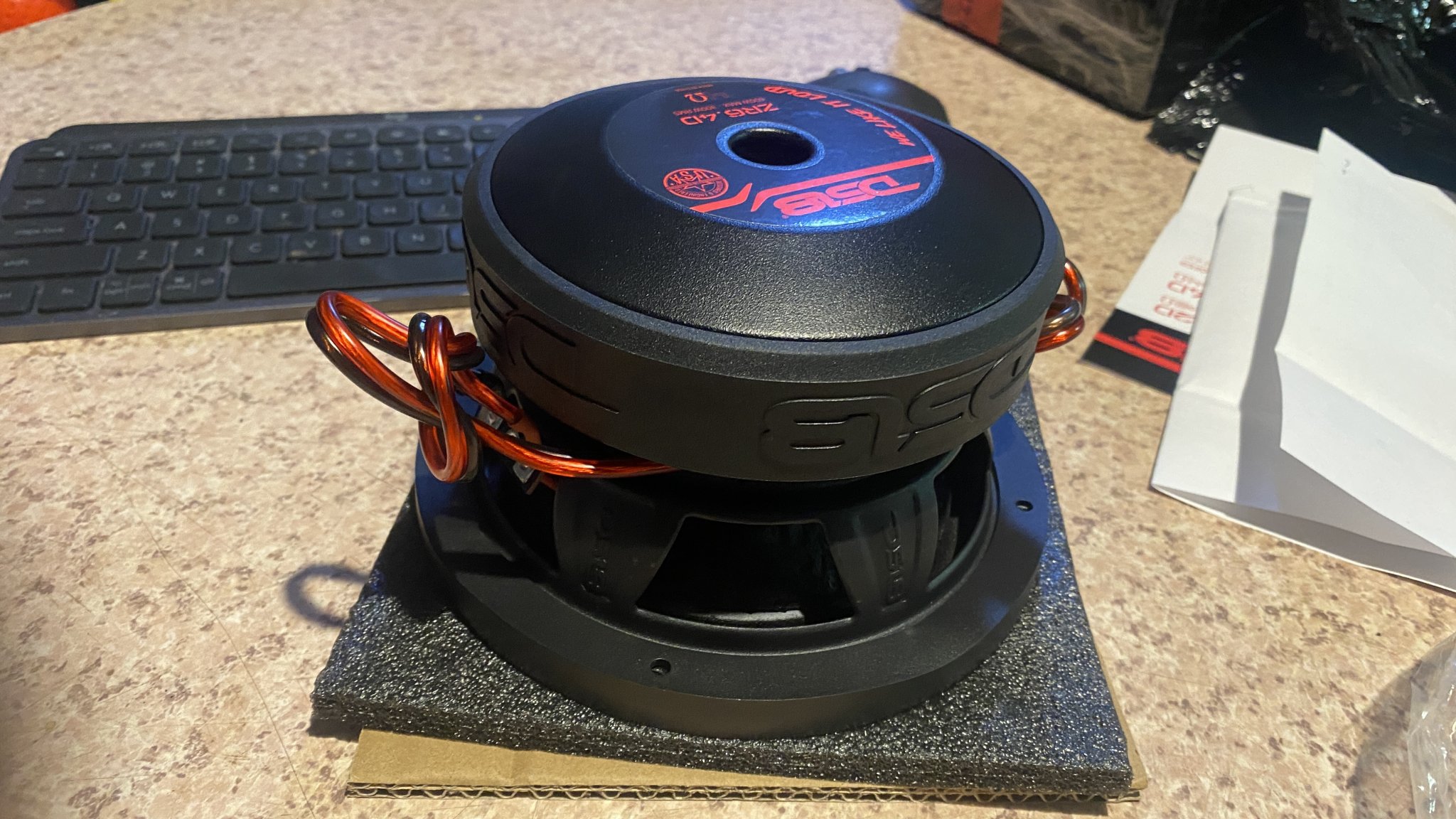

Found a new contender, smaller driver for the Tiny40s sub, appears to be a replacement driver for the BB3. Got one coming in but doesn't have any T/S specs

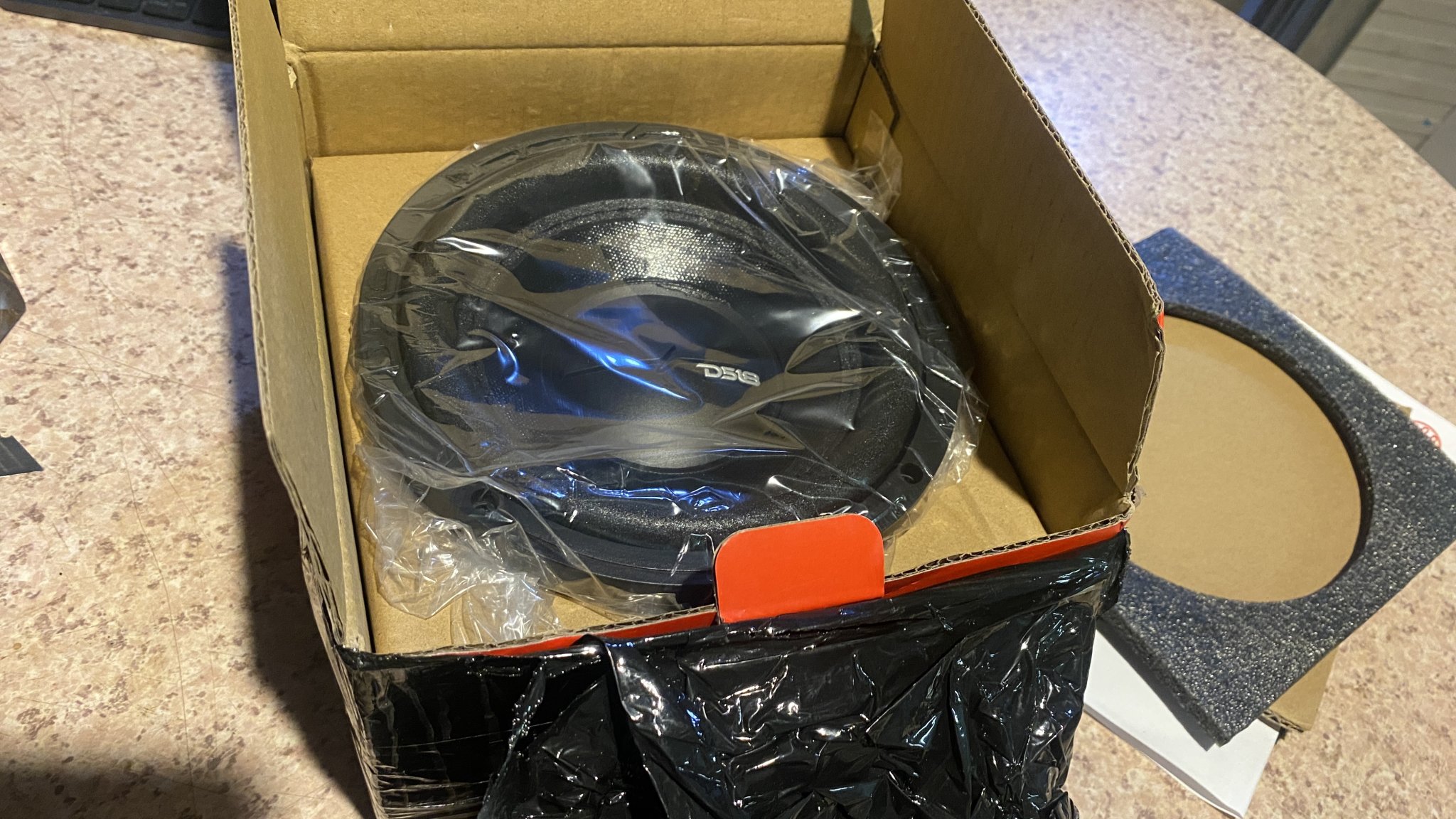

A surprise arrived today, ETA was Feb 07
The cone appears to be well doped. Is this the minimum driver to pull audible 40?

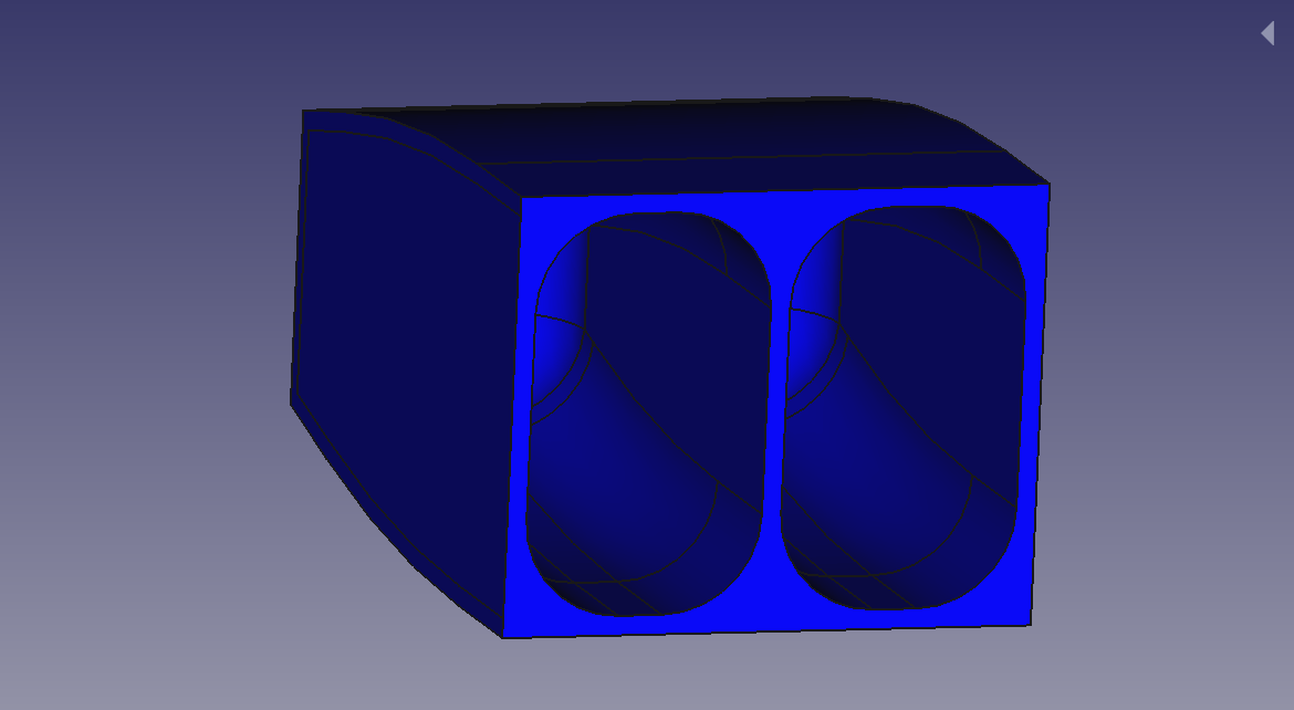

Have a look at this. Its the basic form of the test box for PR systems. I have been thinking about placing the racer sub on that middle bulkhead and a racer PR on each of those front openings, make sense? That bulkhead is movable to allow varying volumes on either side of the partitionHave you given ANY thought to a small bandpass design? If you want the 40Hz nearfield, all you would have to do is use a PR, and add enough mass to push the usable range low enough.
