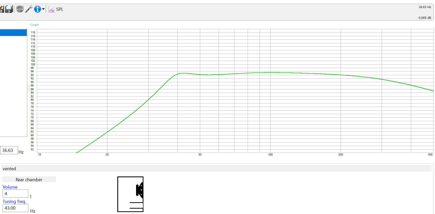

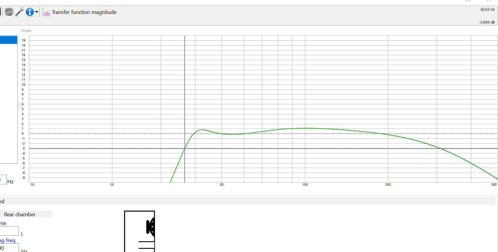

Man, I know you folks have been at this for a lot longer but this is getting ridicoulous. Did you actually check the ZR6 numbers and how it models with 4L cab volume in Winisd? Is this not moving enough air? I have been begging folks to help me understand how to read the results and thought I was learning and goiing well to come up with this result for a 4L @40hz tune box. Now you are telling me that I am not doing this right?you NEED to move air
What is bad about this result for the ZR6 in 4L BR redone as a PR and why should the dayton bar unit in a sealed be considered instead of this result for a solid but tiny 40hz box. I thought I was absorbing well and modelling better but now you have confused the ef out of me man

When performing your modeling with such small enclosures designed for maximized performance, it’s very important to look at enclosure volume as NET volume. The DS driver you’re considering looks to displace about 1.5 liters. If I’m correct, you discarded the ported system to regain the volume displaced by the port in favor of PR? There will be some displacement there as well with the PR Chassis and added mass. A good rule of thumb is 2x the driver SD required for efficient PR performance. I know you have an overall gross max enclosure size you’re working with so……
My only area of contention was your subjective dislike of sealed systems compared to resonant…….hopefully I’ve effectively translated that to a point of understanding where the sealed system when properly designed will always be more accurate to the input signal.
target of around 4L net volum
for a 4L net internal, and gross internal gets over 7L
Confused again man, do I not appear to have a firm handle on NET, GROSS internal and eternal? Drawings show that everything is aligning with the drivers displacement, material thickness and its displacement, driver compartment volume, port volume, aux compartment volumes and so onWhen performing your modeling with such small enclosures designed for maximized performance, it’s very important to look at enclosure volume as NET volume
Would really like to find out how I am falling short in correctly using displacement

So far the ZR6 looks to be the champ at this as it looks like it will be quite powerful in output in the target net 4L. But I don't need this much output for what I am trying to make. Just enough output to be audibly flat is the requirement as it will be battery powered as well using a power tool battery pack

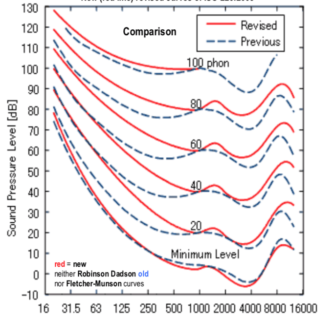

A bunch o' random observations:an audible 40hz
- "Audible" is a key and big word here. From the equal loudness contours in @weltersys post #74, it seems 40 Hz would be audible at 60some dB. But if you are playing at I think you said 70 dB, for the bass to sound correctly loud you'd follow the 70 Hz contour up from the midrange and find you'd need ≈ 106 dB. How far away are you listening? If 2 m that means like 112 dB from the driver, if 3m then like 116 dB if I'm doing the math right in my head. (That's ignoring some amount of room gain).
