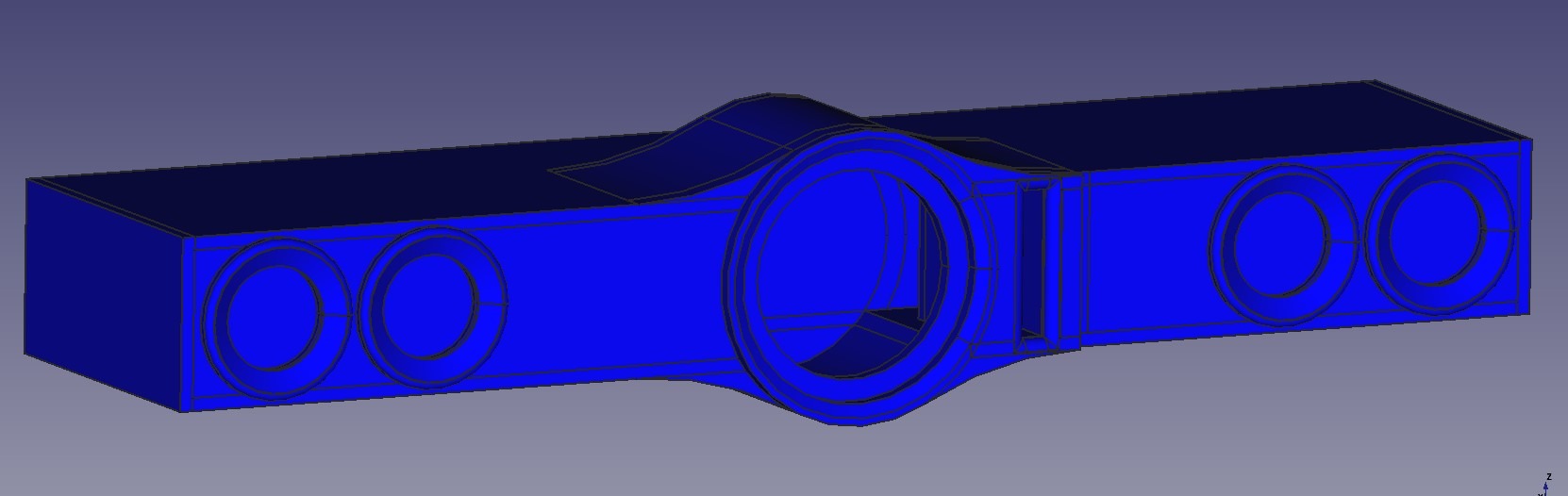

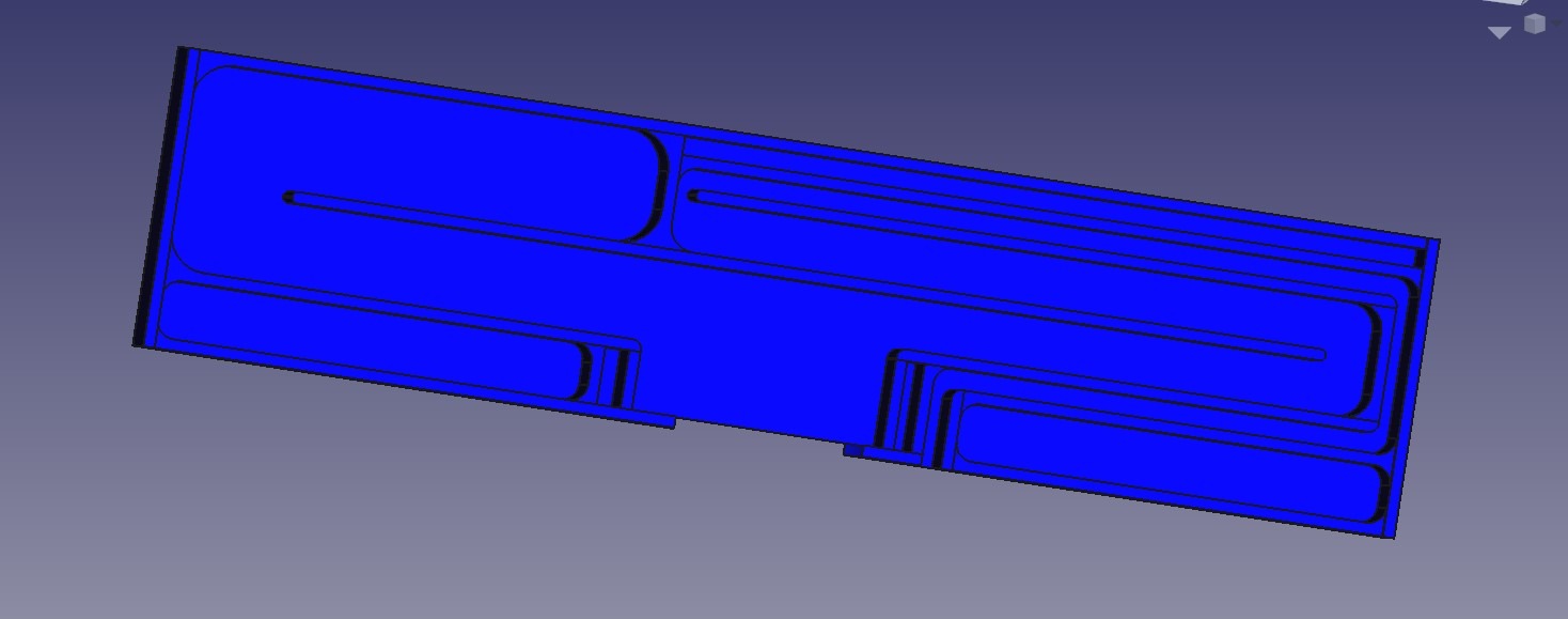

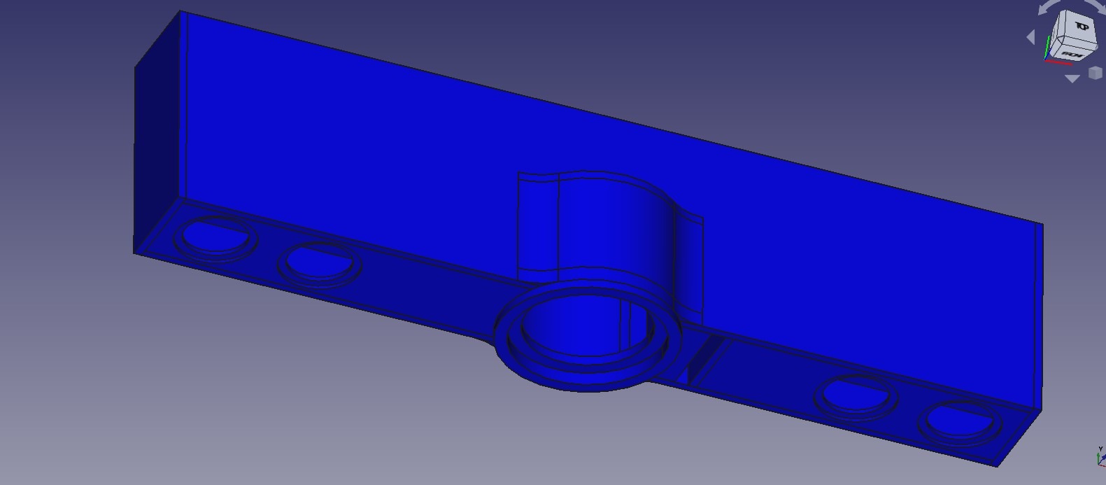

A bit more details, shown without front trim and top. The fillets (rounding) in the corners are structural and cubic core, 3D printed and glued in place devices. The right hand side rear cavity is spare volume that can will be used for electronics

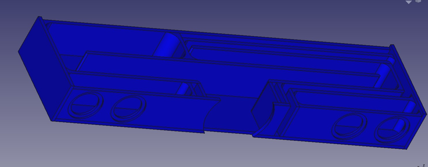

Shown with front trim in place. Drivers sit under the trim, only the roll surround and cone/cap will be visible after install. This is the design work on the hopeful 20hz soundbar complete. I am curious about the similar size 23hz tuned bass reflex that looks like a TL. Will draw that up in cad next to test against this TL just for some fun

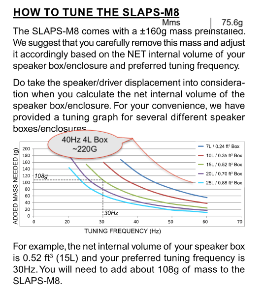

This is a cheap pancake. Seriously considering getting a couple to try back to back with one active and one passive just to see what happens and to try as a super heavy-duty PR for the 6.5" drivers at 600w
Hoping to be able to do some experiments with this on the back panel behind the driver in a 4L box with the 6.5" sub
Extrapolating a new 4L line, looks like you would need to add around 225 grams of weight to the Slaps M8, 65 more grams than the pre-installed 160 grams.
That would put the Mms near 300 grams, about 1/3 Kilo flapping at 40Hz.
If the 6.5" sub driver can make it move in that small a box, that's gonna be a "whole lotta shakin' goin on" ;)
