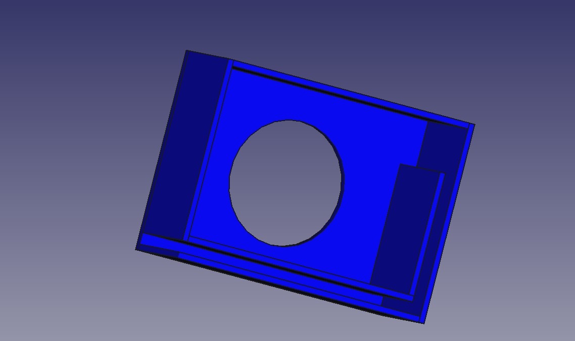

Thank you for that, I'll ponder that a bit and do some modelling. This model (shown without back panel) is the max space available at 280.3mm x 204mm x 104mm. There is some space behind the driver location to fit a cup to the back panel for driver vent clearance. The port is tuned to 43hz. Net volume after taking out port and driver displacement is 4L. Internal volume is 4.7L
Box is 6mm wall thickness and no bracing, but the resonant frequency (jiggle frequency) of the assembled materials will be higher than 400hz as I am using FRP with balsa core and 200gsm biax glass skins. This surface can be further tensioned to lift the resonant frequency above the speakers range

You can add parametric EQ, something like Fc 40Hz, Q 2.0 and +8dB while lowering the high-pass a bit. I wouldn't worry too much about modeling it exactly flat as the in-room response will throw things off anyway

One thing is that a sub's frequency cannot be flat over less than an octave, not possible. Get yourself a very compliant speaker and then tune it to the Fr you need by adding a little weight to the cone until it is where you need. Then design your box for that. I take it you will use an electronic cross-over with its own amp, which makes things even more flexible. If you use a miniDSP with it, you can basically do anything you want with the frequency response.
Personally, I won't use a bass reflex for a sub, the port can chuff a lot is such a small box and also sound very boomy. What I would do is make your speaker from cardboard and tune the crossover by ear using something like Equalizer APO to real music and ***** by ear where you need to fill in.

A good ported box sounds enjoyable to me, sounds a lot different from the same driver in a sealed box. Winisd is showing very little excursion in this box with 150wrms power and the target is a flat 40hz-300hz at around 70db daytime and a lot lower at night. Do you feel chuffing would be an issue at these levels? The ports will be slot ports
The driver will be here in around 4 weeks. I have lots of MDF offcuts in 16mm lying around to do three 4L net test boxes tuned 23hz, 33hz and 43hz
I have digital interfaces and a calibrated mic, hope you guys can help me measure and test this thing and point out any problems
