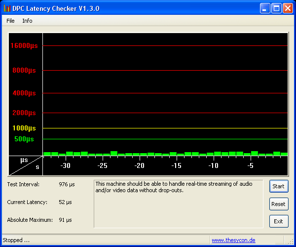

Just as a comparison, here is the latency of my Dell desktop.
Win XP/SP3 2 gig ram, 1.2GHz dual core. I never have the least bit of trouble with it no matter the audio bitrate.
