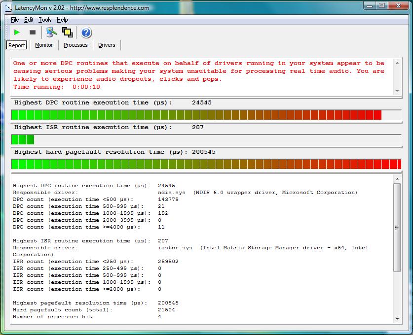

SY, you said this was not as bad before. Have you tried going back to a previous restore point? Also reading up on this ndis.sys file that it is a good candidate for virus infection. Can you find it and determine the last time the file was updated? Also...did you run a recent virus check?
Yes, I scan for viruses weekly. Where would I find ndis.sys? I ran a search for it with no results.

c:windows\windows\system32\drivers
You should see it listed as ndis as a 'system type' file. Curious that you couldn't find it in the file search...came right up for me in WinXP

Sonidos, I have the same problem with Media Player, foobar, and Media Monkey, so it's not player-specific. I'll take a look for the ndis file and report back.
edit: ndis file creation date was 2/2008. Date modified was 2/2009, probably about the time I got this computer.
hmmmm...scanning with my favorite search engine, I found this article....seems there is definitely some type of contention going on...lets give this a read..
Adjusting PCI Latency Settings to Fix Clicking and Popping Problems | Pro | Rain Computers

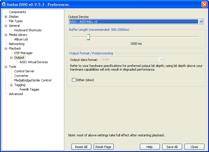

SY, in Foobar you can look for ASIO setting to see if the drivers are there. If they are, you can use them.

Pano, my version (1.1.1) doesn't give that option- it says that output selection is automatic.
