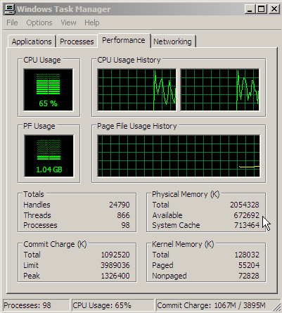

Hi SY, press <ctrl><alt><delete> and choose task manager (I'm assuming this works in vista as it does in XP and Windows 7)
click on the performance tab and have a look at what it says beside Available (in the Physical memory section). screen shot below is XP. and I've got about 600MB of memory free. If the number here is very low then you may have something hogging all of your memory. I've never quite worked out Windows paging stats, give me unix any day 😉
Tony.

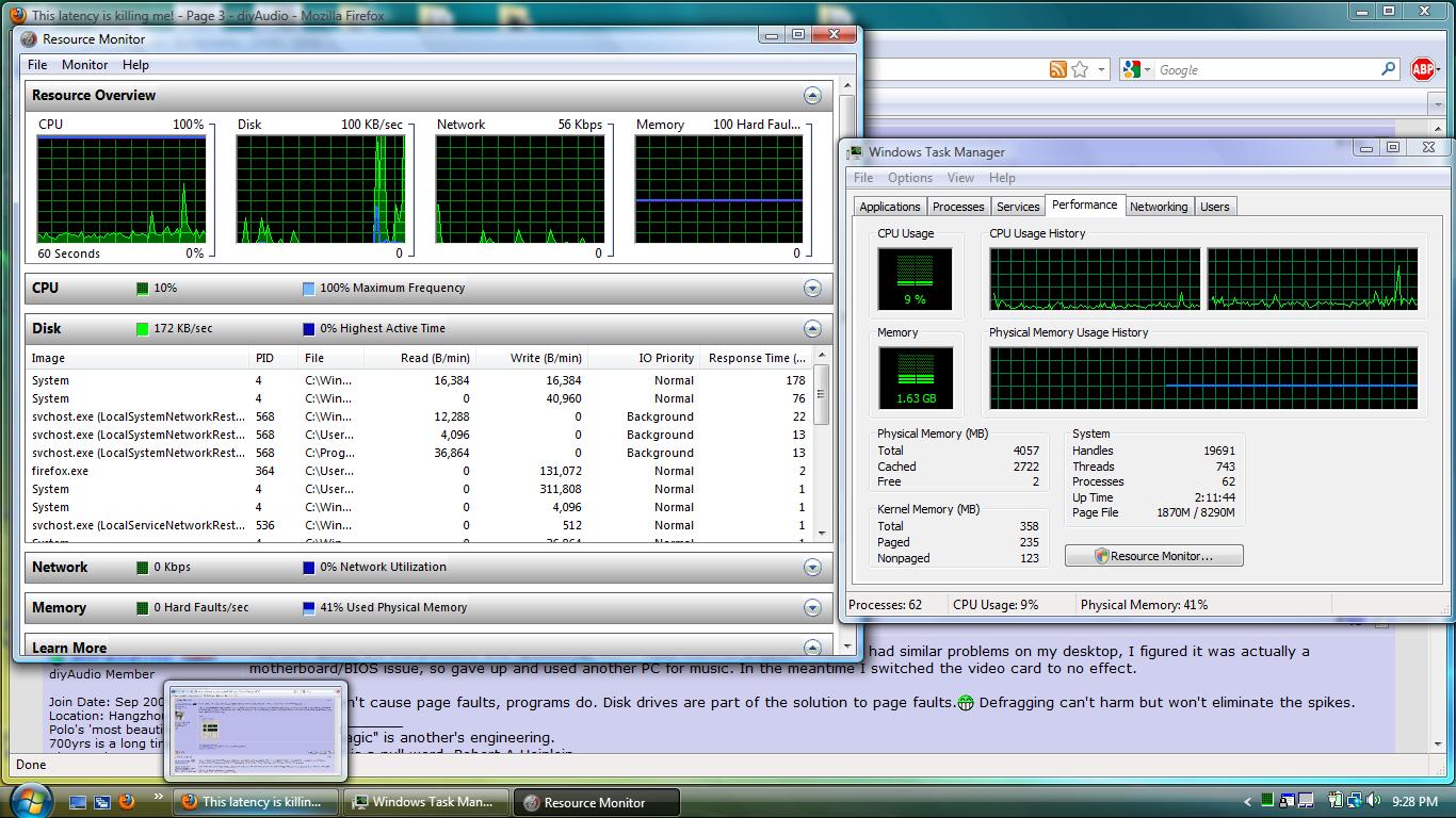

Kind of the same, but to get to the REALLY good info click on the link on that page called Resource Monitor (only present in Vista/Win7). It will give you much more indepth details on things like Networking, Hard drive usage (what programs are accessing the HD), CPU usage (PID, number of threads in a program, etc.) and memory usage.Hi SY, press <ctrl><alt><delete> and choose task manager (I'm assuming this works in vista as it does in XP and Windows 7)

Well, I understood about 20% of all that, so I must be improving. Here's a shot of the resource monitor. Any clues?
