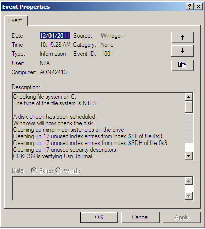

I can't remember if anyone said to run a windows disk check (the two second mouse pointer freezes are what I was having (though up to 20 seconds) when my HD went (4 times now). double click on my computer (might be just computer in vista) right click on drive C: and choose properties. click on the tools tab then under error checking click check now. tick both the fix errors and scan for bad sectors boxes and then click start. It will say it can't do it now and ask if you want to do it at next reboot. say yes.
Next time it boots up it will run through the disk check. depending on the size of the drive (and the number of problems) this could take 20 minutes to many hours. (will only take many hours if there are a lot of bad or nearly bad sectors)
when it has finished you can find out whether there are any bad sectors or not through event viewer (I'll tell you how later as I have to finish this up and leave for my train!).
Tony.

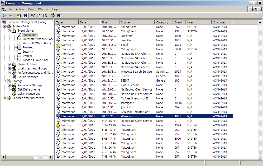

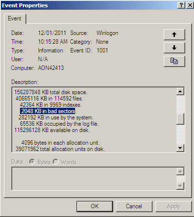

OK Part two. Once the machine has rebooted, right click on My Computer (or just computer) You can find it either on the desktop or the start menu, sometimes both but not allays Choose Manage.
In the window that comes up expand event viewer and then click on Application (I'm assuming vista is the same as XP here).
look for an information line with source Winlogon as per screenshot1 below.
double click on it and have a look for any fixes that have been performed (screen shot two below).
scroll down to the drive stats (note if there are many fixes it may not have the drive stats) and see if there are any bad sectors screen shot three below:
You don't want any!! as you can see my drive is very sick (and it is only about 3 months old).
If you have ANY bad sectors then the drive is probably on the way out. Note that on my drive a sector is 512 Bytes so I have 4096 bad sectors, that is a LOT!!! All drives have a certain amount of space reserved for re-mapping bad sectors (and they do it automatically), once all of that has been used they start to show up in windows, by that time it is a problem.

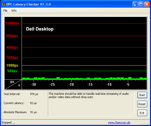

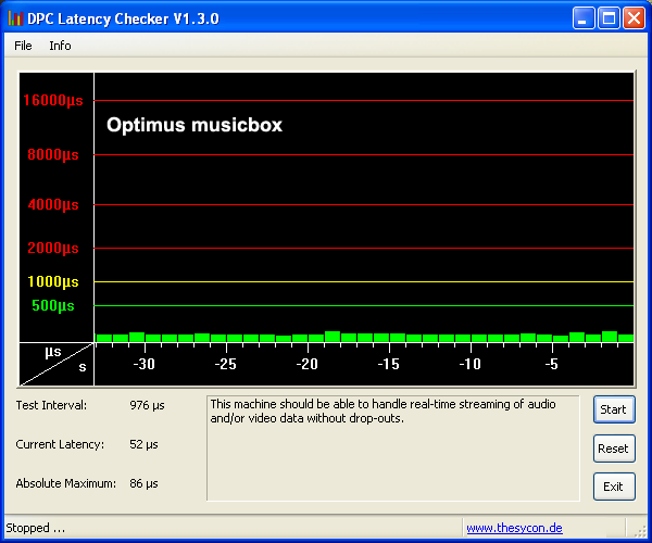

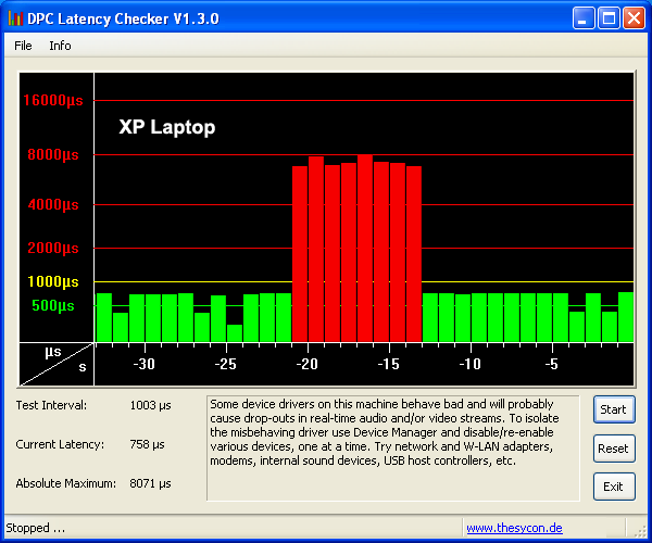

It may just be because it's a laptop. Although we are taking different hardware and OS, here are some shots of music computers at my place. All win XP
You can see the big nasty on the Laptop, the one that has audio problems. That big block would show up about every 60 seconds. Once I turned off the WiFi, it would be just a single or double spike every 70-80 seconds. The green baseline was lower too, by about 40%. So it may be a network thing on SY's computer. All mine are networked, only the laptop has WiFi.
The music server I run is an old Dell Optimus with just 504 MB of RAM. It's a clean and minimal install of Win XP pro, but no great efforts to turn off drivers and such. Shot taken while playing FLAC files from a USB drive.

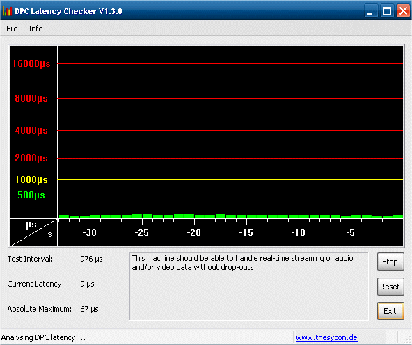

I use ASIO for my VST keyboards on both a Creative X-fi and a Turtle beach SC and Win7 just sucked! Back to XP and my sub 30uS latency. I found that DPC latency program and the (old ) core duo -1.8ghz does just dandy (below).
That was with a DIVX movie running , my server being utilized , this page , and both the simulator and my PCB layout program in use.
PS - another latency issue is the quality of the hardware. Most onboard hardware is "emulated" in software , using MUCH more processor time. My 2 network cards are REAL , at full "tilt" (utorrent at 1mb/s+ and the lan at 10-50mb/s (gigabyte LAN) a modest 10uS of latency my be experienced.

That's what you want to see normally but in this case it would have been nice if it did have some because it would point to the disk as being flaky.
It is possible for the disk to be developing bad sectors but just not run out of spare ones to re-map, in this case it won't show up in the windows check disk, so unfortunately a zero result is inconclusive.
