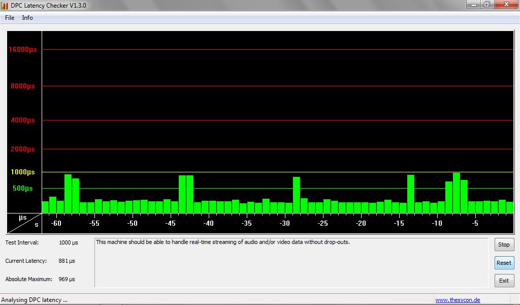

This latency is killing me!
Here is something scary.... My 2GHz/2GB dual-core XPSP3 laptop gets creamed by my 1.6GHz/1GB Win7 netbook in the latency test. 😱
I need to put 7 on my main laptop (XP install is old and trashed), but maintaining 6 PC's in the household gets pretty exhausting.
That HAS to be a driver issue.

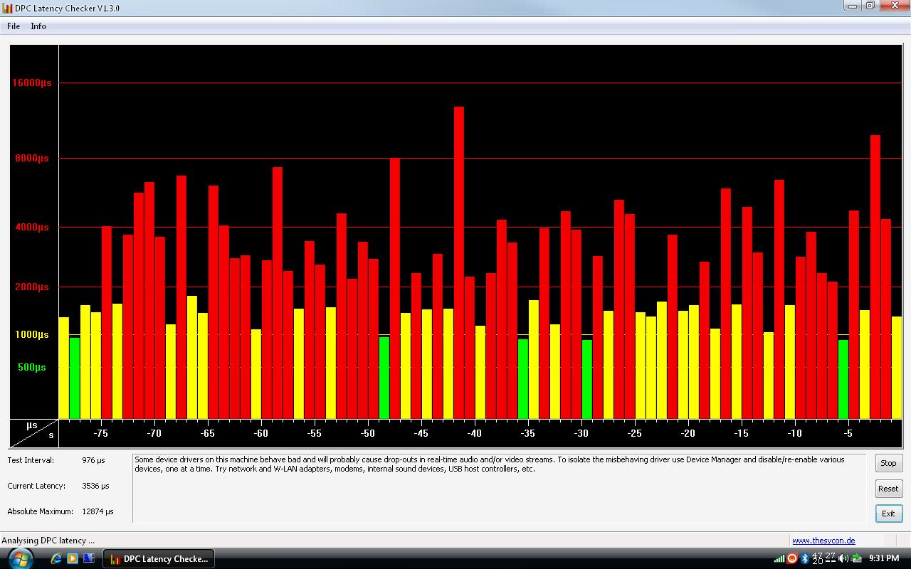

OK, in my usual suave and debonair manner, I managed to make things much worse. I downloaded and installed from the Dell site later versions of the IDT sound driver, an "urgent" system utility, and BIOS. Flashed the new BIOS. Now the sound has an intense three Hertz stutter. I might be able to sync it up with Tiny Tim's vibrato.
Ugh, that is not good. Run the Latency program again. Lets see what is causing it now.
EDIT: I hate dell's system utilities. Wouldn't be surprised if that is causing it. LOL I had a dell program continuously crash my VPN client.
Here's the report:
Highest DPC routine execution time (µs): 24140
Responsible driver: ndis.sys (NDIS 6.0 wrapper driver, Microsoft Corporation)

Hmmm, very odd.

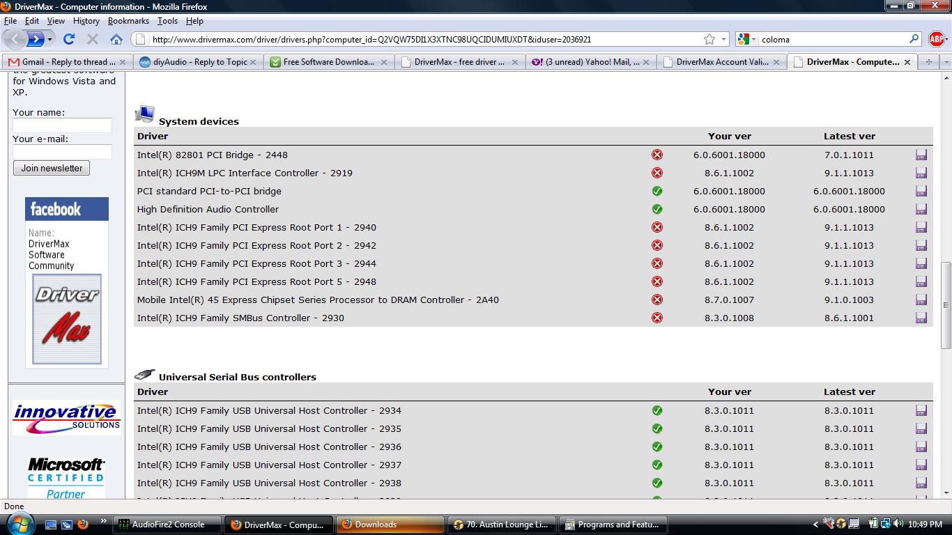

If this is a driver issue we can get to the bottom of it. Download that program I mentioned and then copy paste what ever drivers it says are out of date. Lets see if we can't get this stuff working right. I'll work on this with you all night if I have to. I love tackling problems like this.

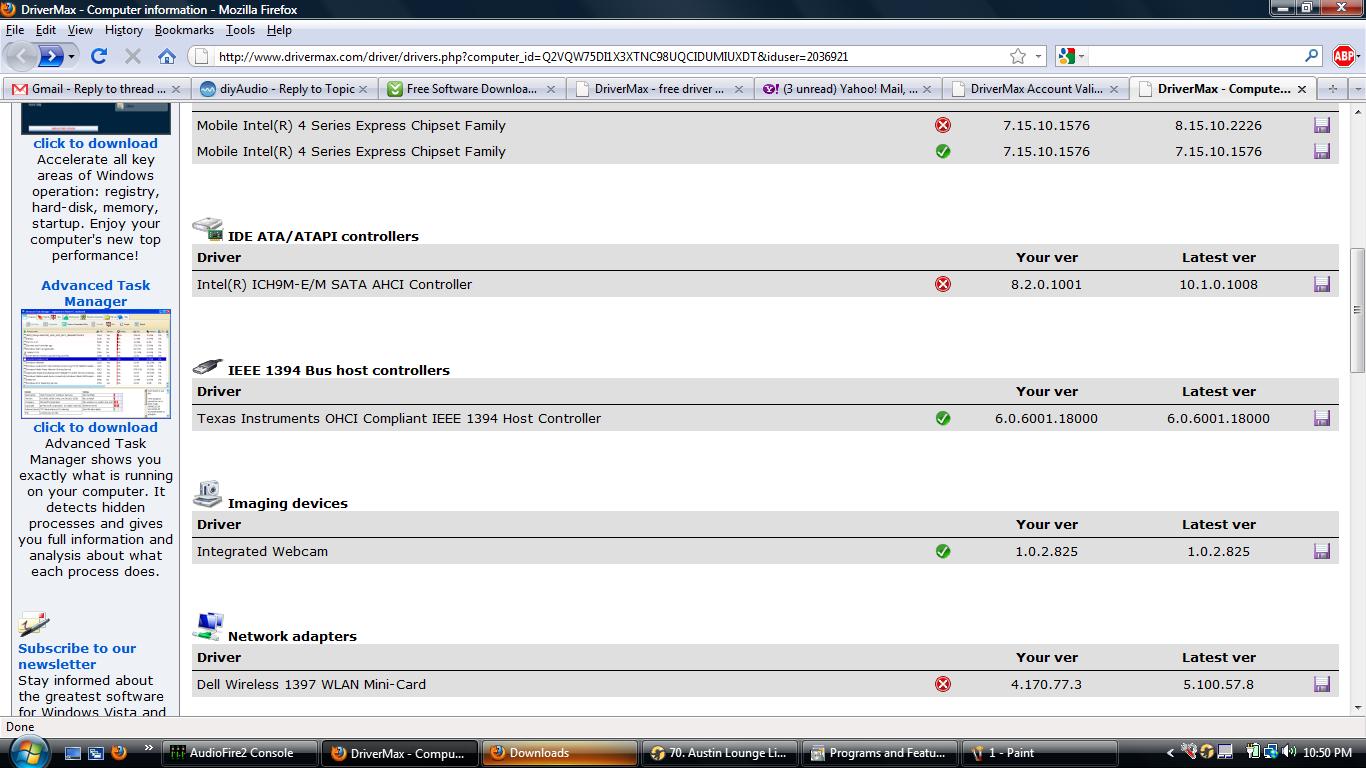

That's unbelievably nice of you, but it's two hours later here, I'm an old guy, and I have to be up early to get more of this grant proposal cranked out (music would have been nice!😀). Anyway, I downloaded that program and it came up with quite a few out of date drivers.
One section in particular which stood out was the drivers associated with the Firewire adapter. And here's the results for System. Any advice you leave me, I'll try when I get up.

I think the utility was a little confused, it is showing the same driver twice once as up to date and once as not, the mobile intel 4 series express chipset one... and are you sure the firewire is out of date? IEEE1394 is showing up to date 🙂

OK, first off:
http://downloadcenter.intel.com/Detail_Desc.aspx?agr=Y&DwnldID=19596&keyword="INF+Update"&lang=eng
That should update most of those intel devices that are out of date.
Intel SATA Driver
http://downloadcenter.intel.com/Detail_Desc.aspx?agr=Y&DwnldID=19607&keyword="ICH9M"&lang=eng
OK, your dell wireless card actually appears to be a broadcom wireless card under another name. Having it under the generic broadcom name will allow us to get updates more easily. To get the exact model though I need the Hardware ID.
To get me the hardware ID:
Start ORB
Into the search box type in Device Manager
In the device manager window go down to Network Adapters
Right Click on the Dell wireless adapter and select Properties
In the window that opens click on the Details Tab
On this tab you will see an entry called Property with a drop down box below it.
Select Hardware Ids in this dropdown box
Provide for me the first entry:
For example one of my network adapters has the hardware ID:
PCI\VEN_11AB&DEV_4355&SUBSYS_FF501179&REV_12
That will give me everything I need to track down the Broadcom driver.

The Intel site told me that I shouldn't replace the drivers when I ran their update utility. Messages like "A customized computer manufacturer driver is installed on your computer. The Intel Driver Update Utility is not able to update the driver. Installing a generic Intel driver instead of the customized computer manufacturer driver may cause technical issues. Contact your computer manufacturer for the latest driver for your computer." Or "This device is unknown or unsupported. Please contact the manufacturer for possible updates."
Anyhoo, the hardware ID for the wireless adapter is PCI\VEN_14E4&DEV_4315&SUBSYS_000C1028&REV_01
