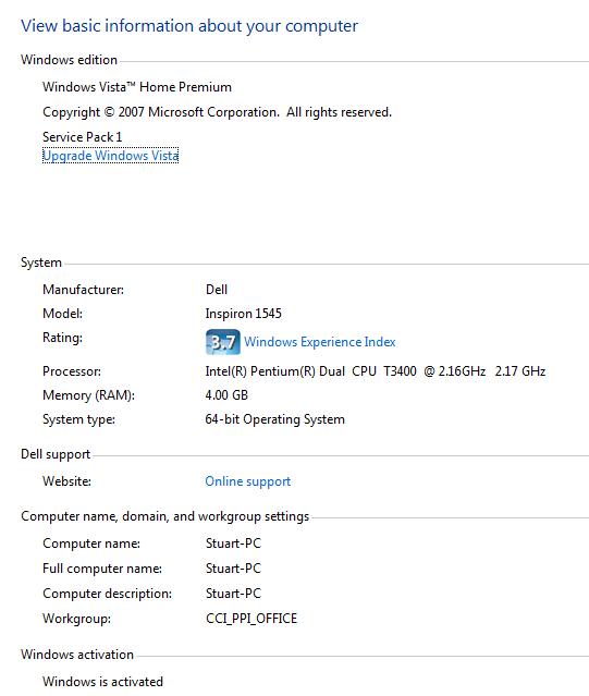

Can you please list all of the specs of the computer? I am a systems admin and can probably help you with your problems. Also which version of you OS is running and how many processes are listed via your task manager. Thanks.

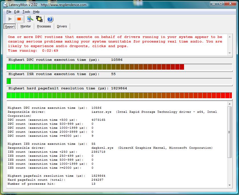

Anyway, she finally looked into things and here's what she came up with. The first issue was ndis.sys, as the latency monitor indicated. In order to ameliorate it, the adapter needs to be disabled in BIOS, under system configuration -> Integrated NIC and wireless -> wireless devices on startup (F2). Doing this reduced the glitches from every few dozen seconds to about every four minutes. The next culprit causing the every-four-minutes-or-so glitch is IASTOR.SYS, which apparently cannot be safely disabled, since it apparently is what controls HD access. Intel has no updates to the version I have.
So I seem stuck- things are MUCH better, but not fully right.

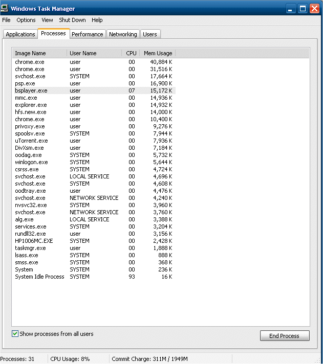

BTW, 63 processes while Task Manager is running in Admin mode ("show processes from all users").

That is your main problem , 63 processes !!!! WOW.

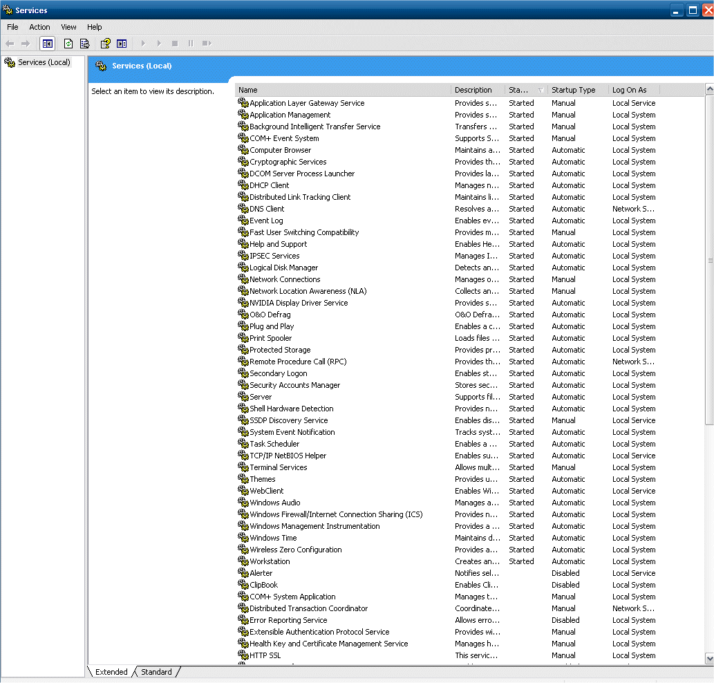

I am serving HTTP , downloading from 100's of peers simultaneously(utorrent) , running a movie , and the LAN is streaming MP3's/movies to the kids. All this , and only 28 processes (below 1). The ISSUE is modern software with all of it's "helpers" (creative) , "Bloatware" (windows itself and any toolbars/IM software). To gain control , see what is actually loading on startup (below 2 - services). You get there - control panel / administrative tools / services or RUN - msconfig (you can selectively uncheck a service in the "services" tab) .
Creative , HP , any toolbars , java , office , (and others) (anal)ly run in the background ALL THE TIME (even if you don't use them) collecting info , continually updating ,using processor time, and doing all sorts of other BS. This does not need to happen for reliable operation and "weeding" this BS out will give you steller performance.

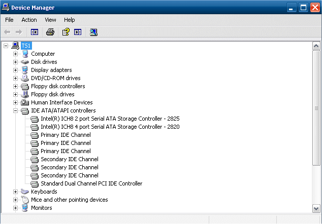

PS - IASTOR.sys is a raid storage controller. IF you don't have raid you don't need it. Win7 has the standard ICH 7/8/9 controller in its database already. The intel driver package will offer to install either the normal (no raid) or raid controller version. Most intel based PC's are either ICH 7-9 , mine is ... but no raid (no IASTOR.sys) .. just the standard driver (below).

A common misconception. But having 63 processes doesn't do anything much for the latency, it just uses up memory and his machine has 4GB which, even with Vista, is plenty. The problem isn't the number of processes - since most of them will be sleeping most of the time - its drivers behaving badly (i.e. selfishly).

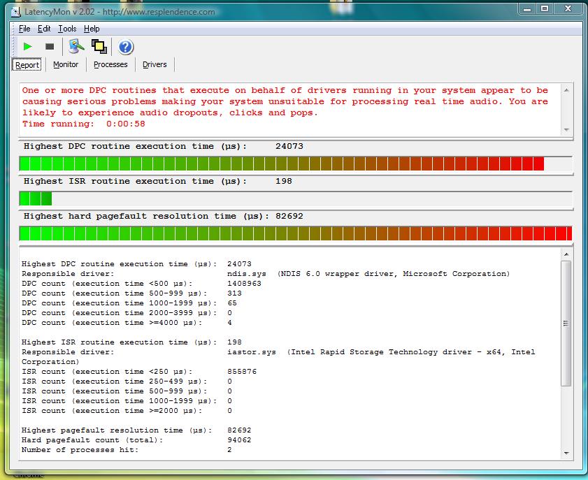

Well that is good progress! Could you repost the latencymon again? the iastor was only showing 200uS before, is it now showing up in the DPC section as well...

200uS latency of a driver (if you really mean microseconds, not milliseconds) is nothing. It is 10 samples at 48kHz.

Here's results before and after following my wife's suggestion (disabling integrated NIC and wireless devices in BIOS).
