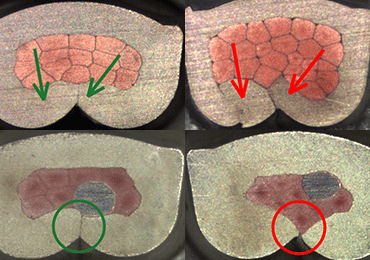

Yes, good crimp makes cold welded gas tight joints and doesn’t have solder wicking up the wire to stiffen it and make it prone to mechanical strain failure. The solder actually adds a layer of resistance vs copper to copper or copper to brass cold weld.
Micro photographs of cross sections of crimped connections.

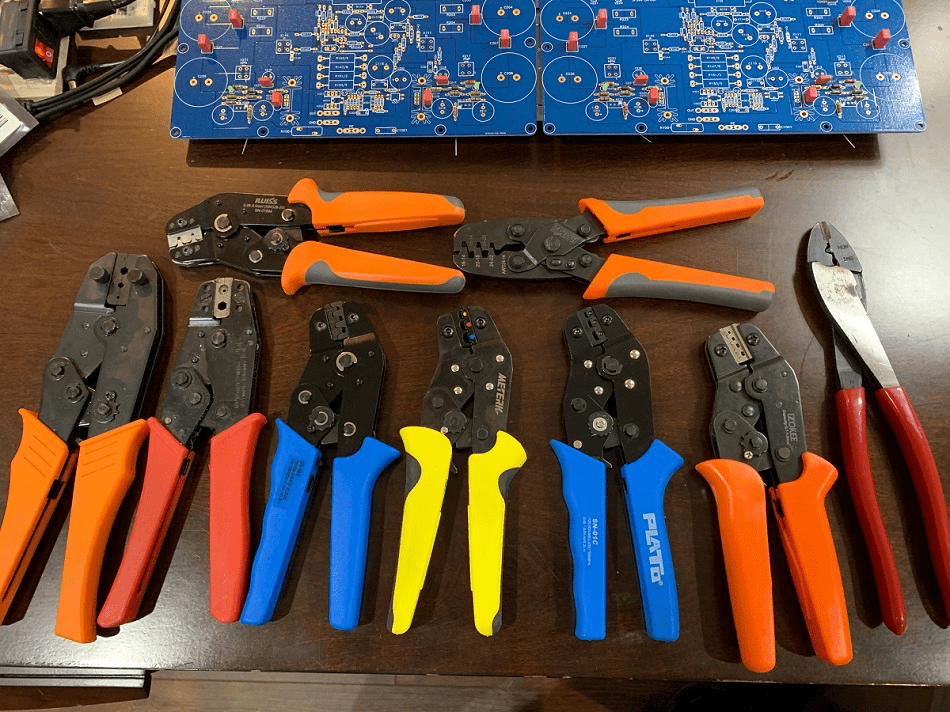

This is about 1/3rd of my crimp pliers. Probably the most used though. Molex KK, Molex MiniFit, JST VH, JST VP, Amp RG-170 and RG-58 coax, etc.

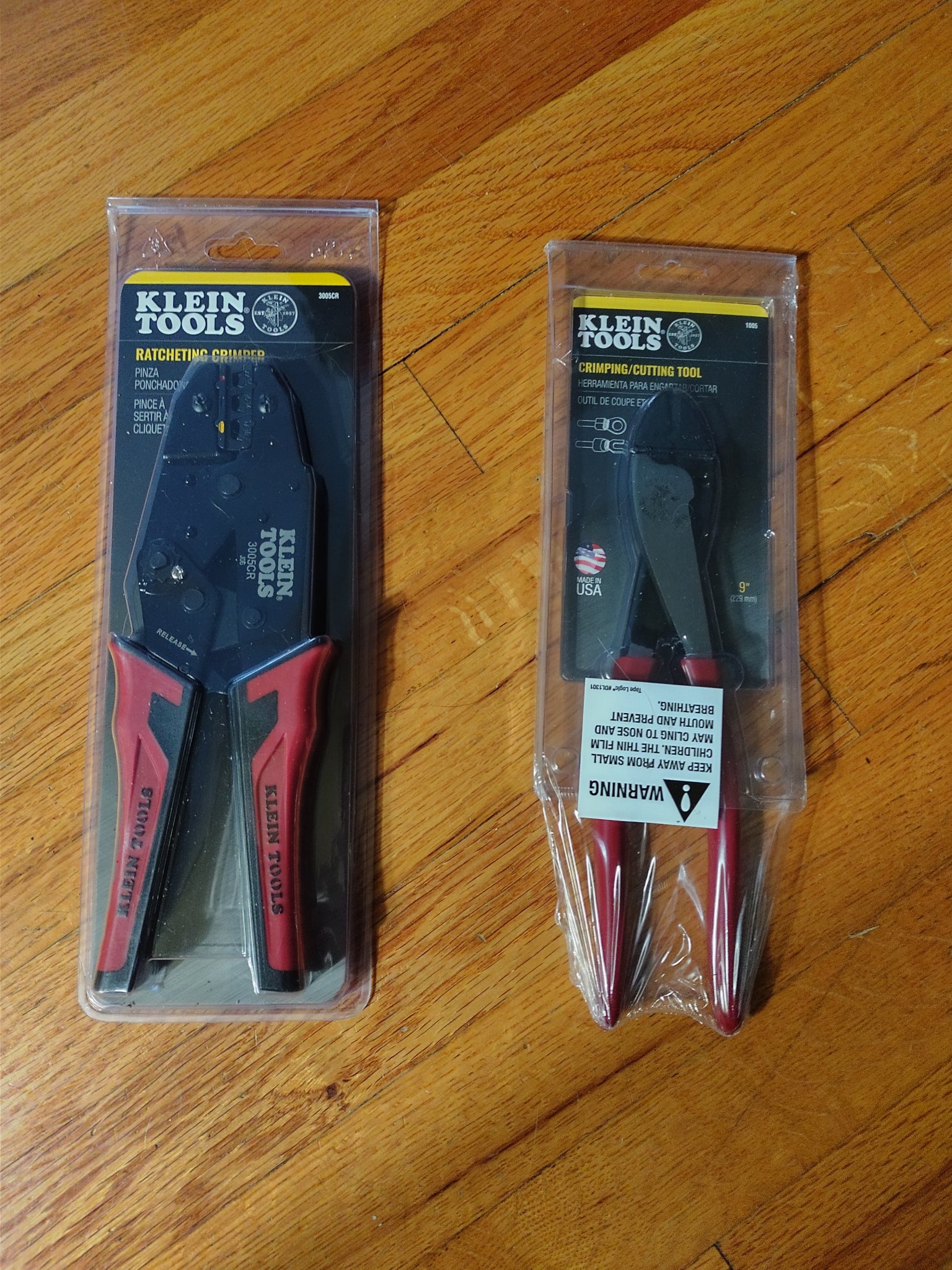

Well, I ended up with these two to start the collection.
Now where do I get the good kind, heat shrink and so forth connectors to use with these items?
I going to look at parts Express and so forth, but I have a feeling there are "special" good ones?

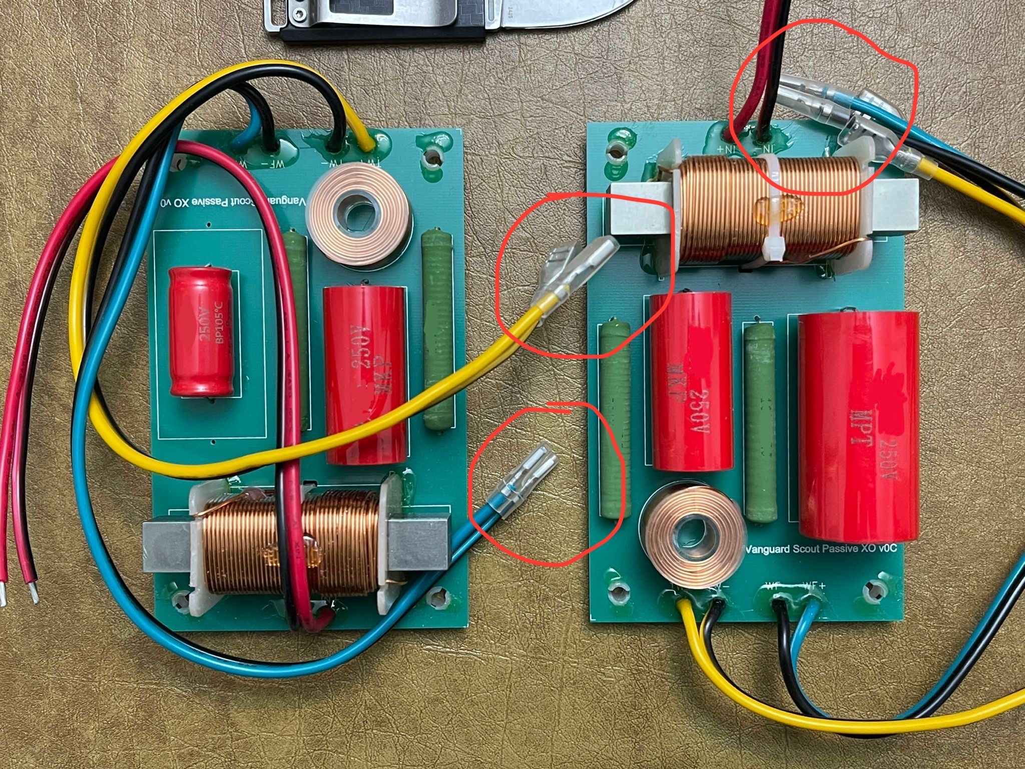

I think I know the ones you refer of, my OEM speaker crossover comes with clear molded vinyl covers that slip on like a sock. Very nice but I don’t know where to get those. I suppose I could ask. Those connectors tend to use special double wing curled crimp - like the very large Molex or JST.
Like this:

I use the Klein J1005 to pre-crimp the connector. These will work as your only crimpers but they won’t make a full box shaped cold weld joint. Then I use the ratcheting box shaped die crimper to do the final cold weld crimp on the joint and the strain relief. That Klein should work fine.
I use this Klein to strip the wires:
Klein Tools 1011 Multi-Purpose Wire Stripper and Cutter for 10-20 AWG Solid Wire and 12-22 AWG Stranded Wire https://a.co/d/auxmuY8
Klein’s are great tools. Like Flukes, they will last forever.
Perfect. Then I picked the two correct ones. Parts Express has a tone of fasteners for these.
