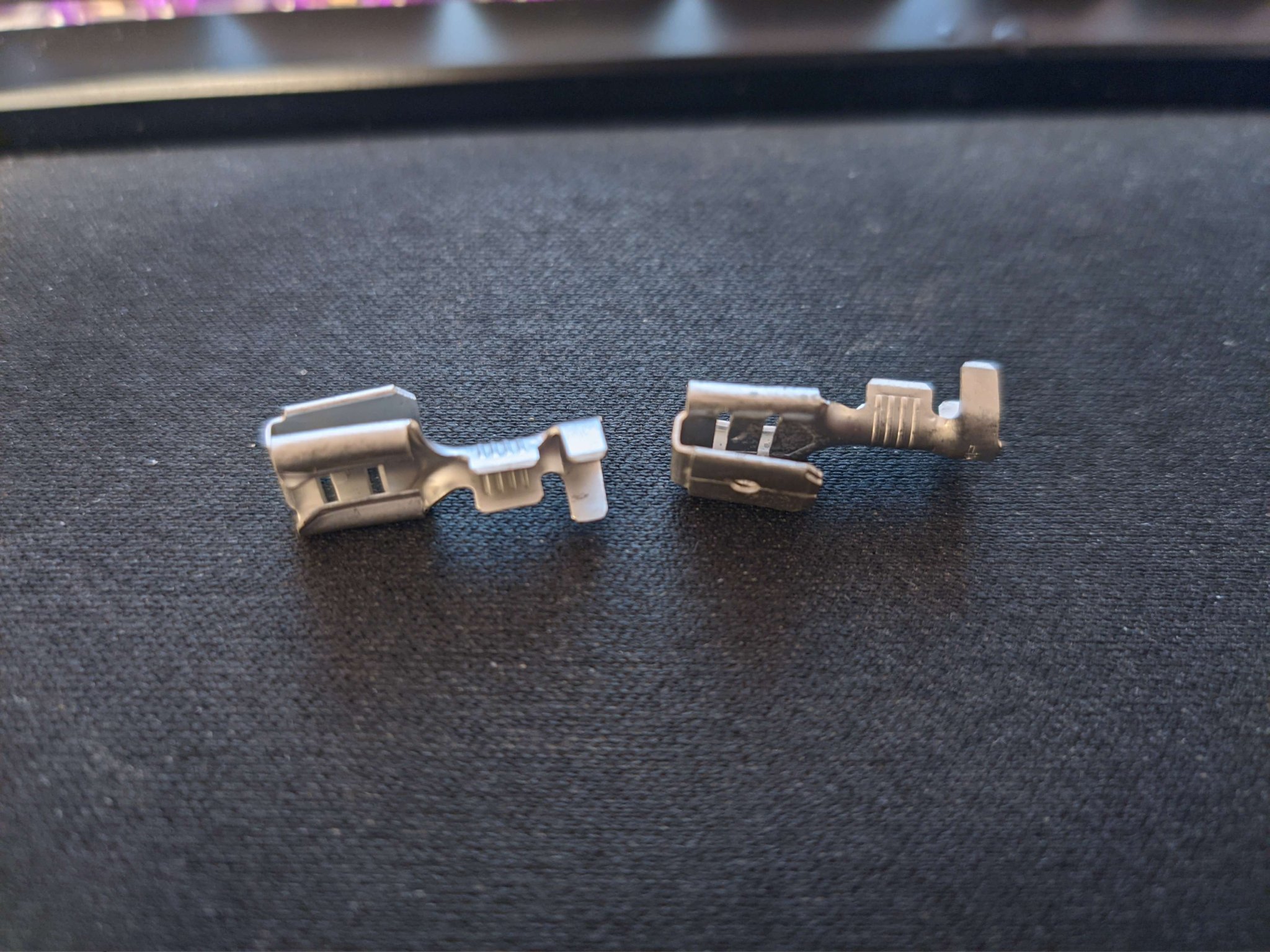

Maybe I am looking at this wrong, but mouser wants 46 cents a piece, 100 would be 46 bucks. 100 through parts express is less than 15 bucks....this cant be right?Yes, the faston connectors are really the best. Check out the dastasheet in the link below:

It's possible the silver plating is cranking up the cost? Not sure, my only experience is buying from mouser or the china-special's off amazon.
Only one way to find out, I've just always been a solder and shrink wrap kind of guy, this is new. Have at least two projects going, this speaker being one of them that will make good use of a crimping set up, so here we are!

Brass tin plated variant is only $0.10ea. Probably good enough!

I just realized that price is for a spool of 8000! There must be another price for singles.
They're not cheap. I will have to check what I was paying. I did buy an assorted pack on Amazon that included clear covers, but the largest size in the pack is good for maybe 16ga max.
1-70823-8 - part no for 6.3mm clear sleeves - https://www.digikey.com/en/products/detail/te-connectivity-amp-connectors/1-170823-8/2284643
60635-3 - part no for 6.3mm quick connects, cheap at digikey - https://www.digikey.com/en/products/detail/te-connectivity-amp-connectors/60635-3/294251
If you wanted fully insulated, maybe part no EDV10-250FIB-Q - https://www.digikey.com/en/products/detail/panduit-corp/EDV10-250FIB-Q/9491246

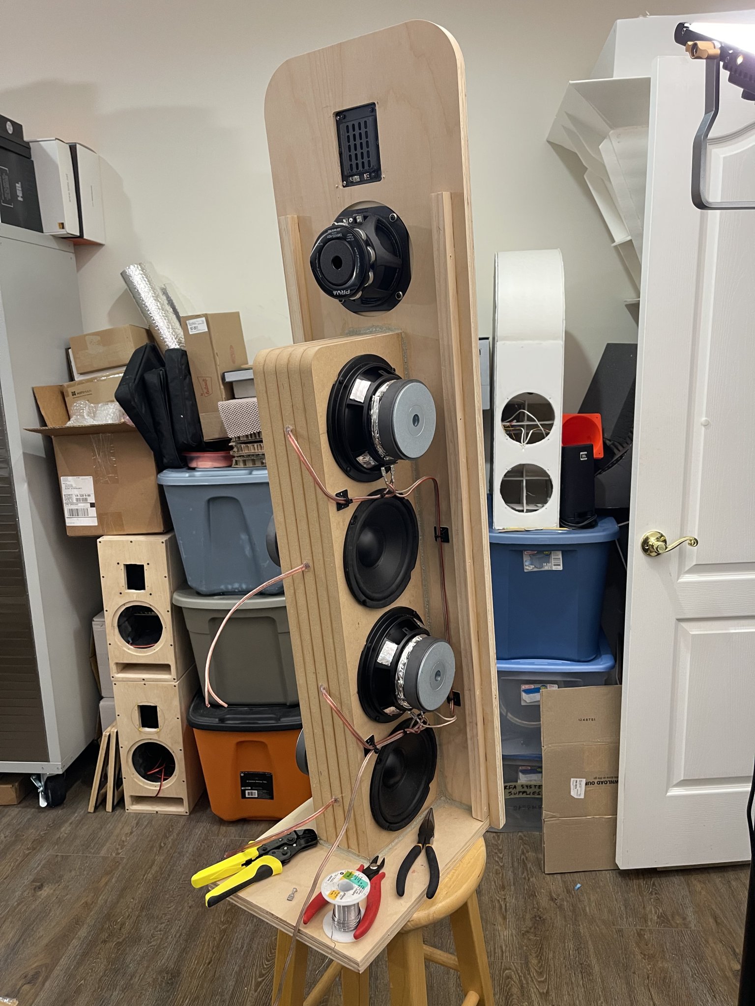

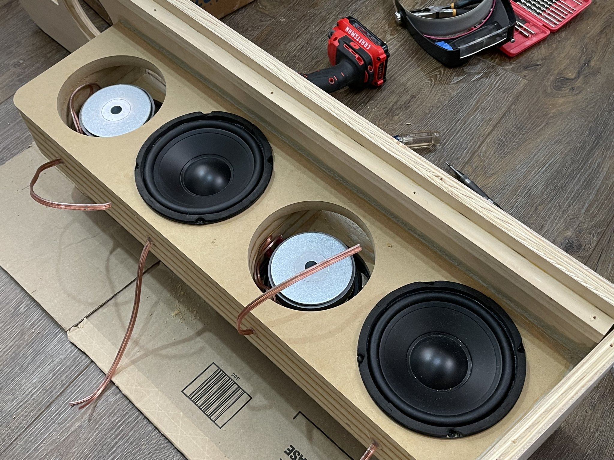

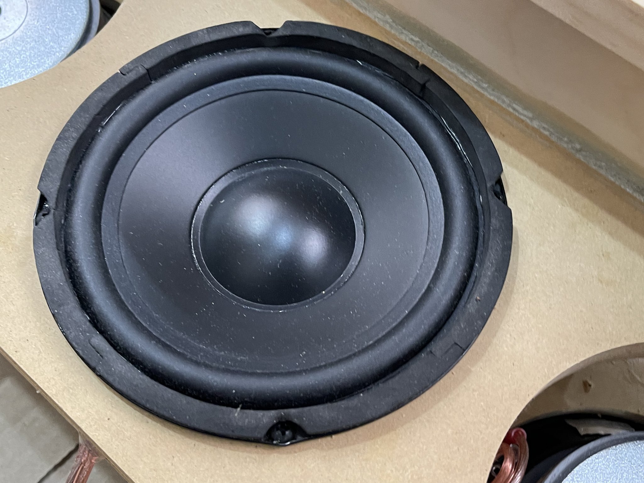

I had some time to start installing the woofers into my XSD.

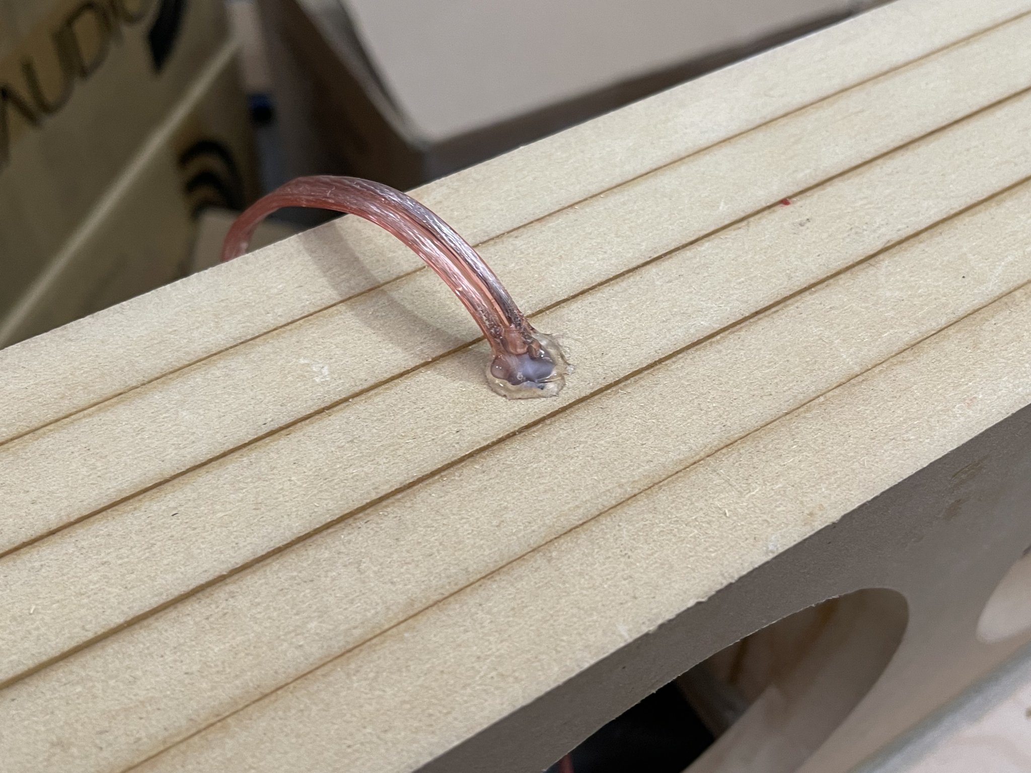

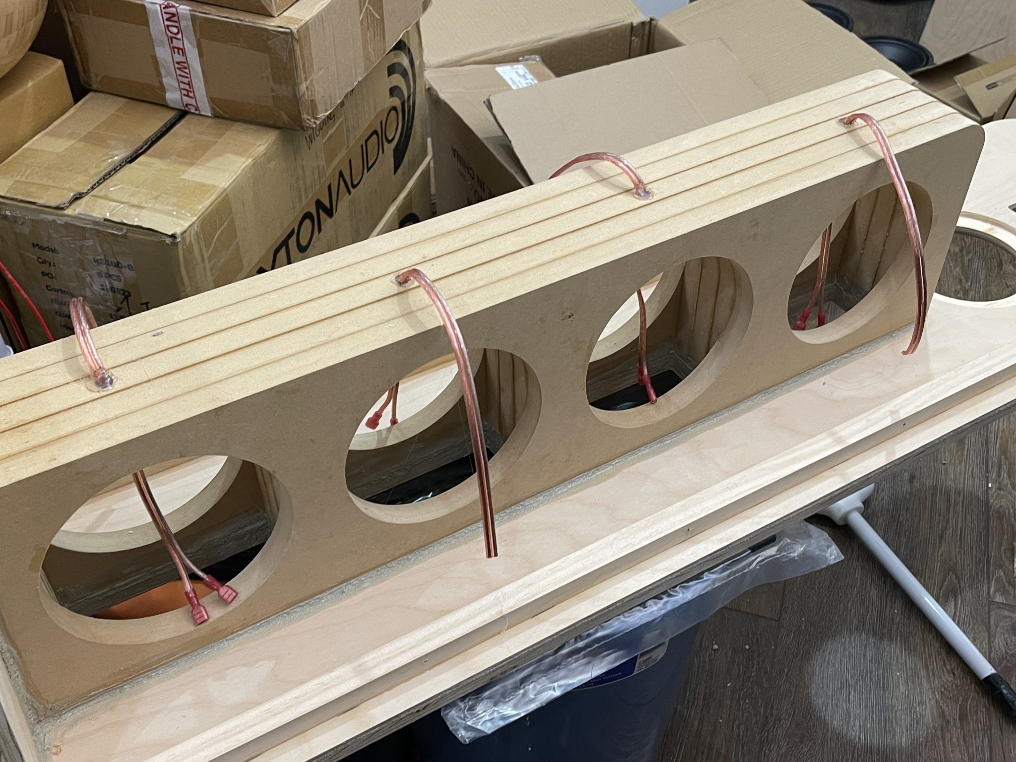

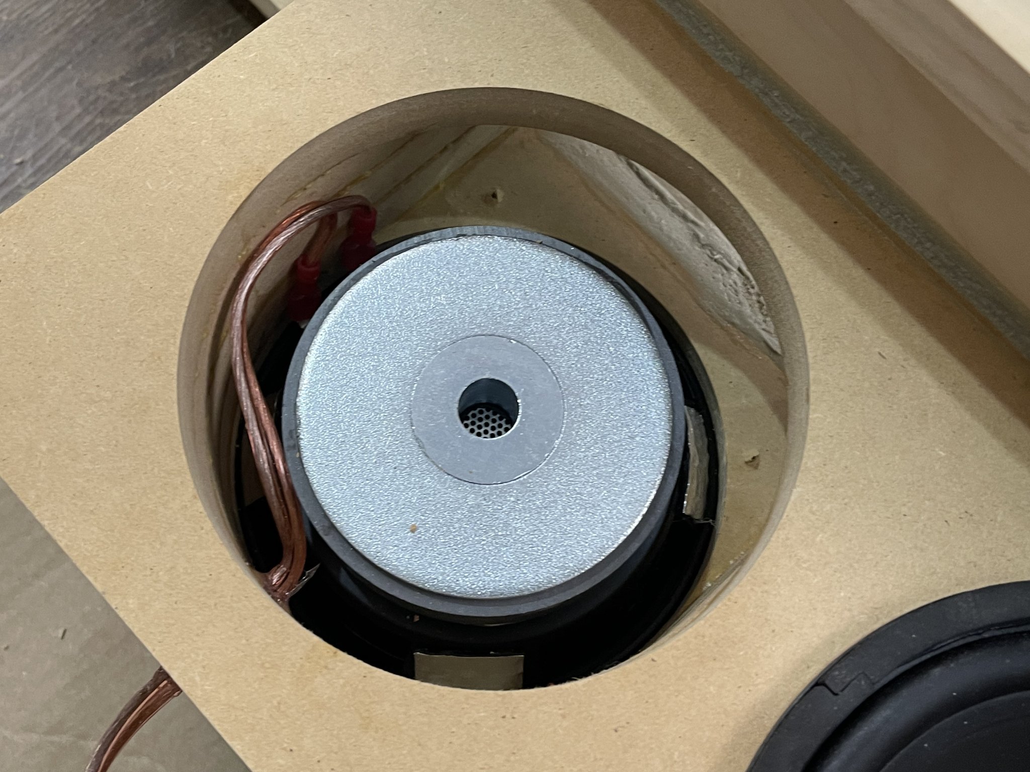

Installing the wires for the in chamber driver:
Hot melt glue seals the wire feed through holes:

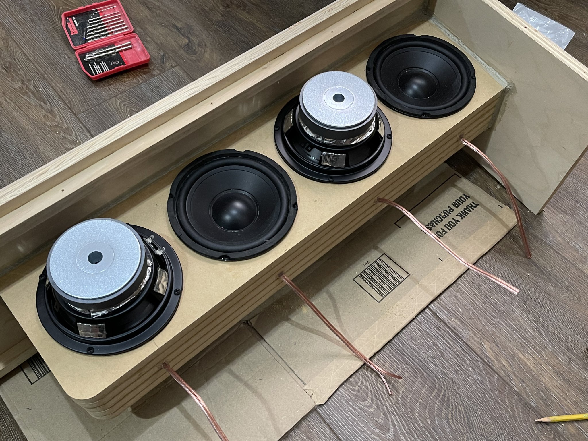

Alternating in and out mounting:
Detail of magnet inside:
Detail of cone face outside. I’m using #8-3/4in black driver mounting wood screws:

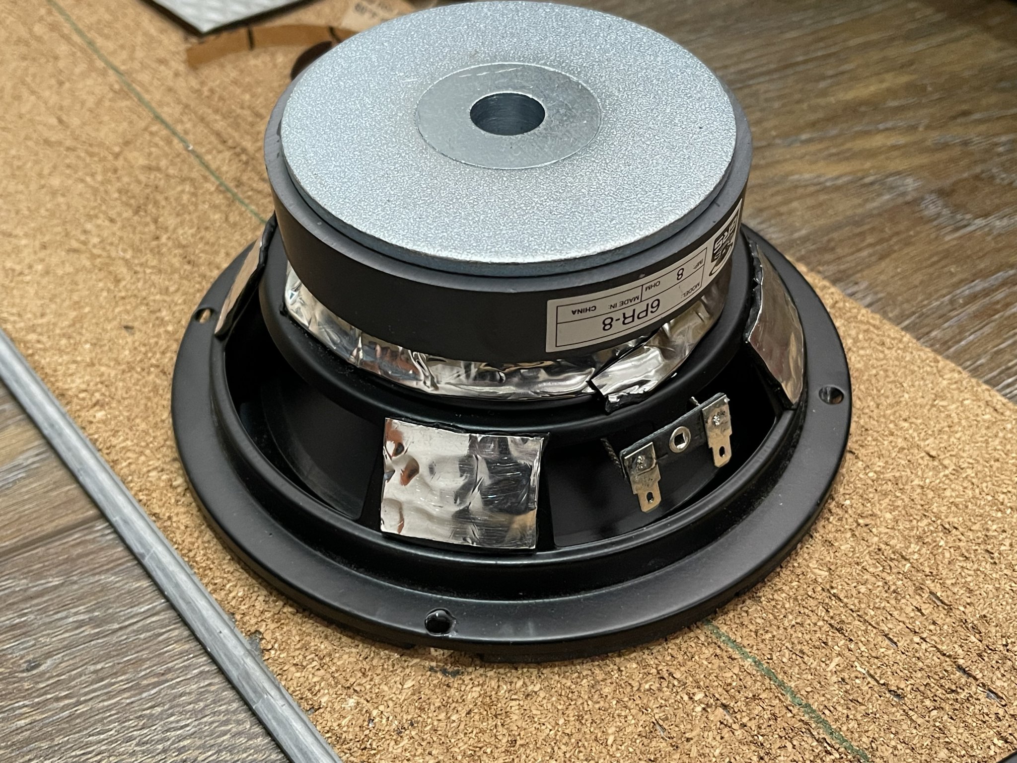

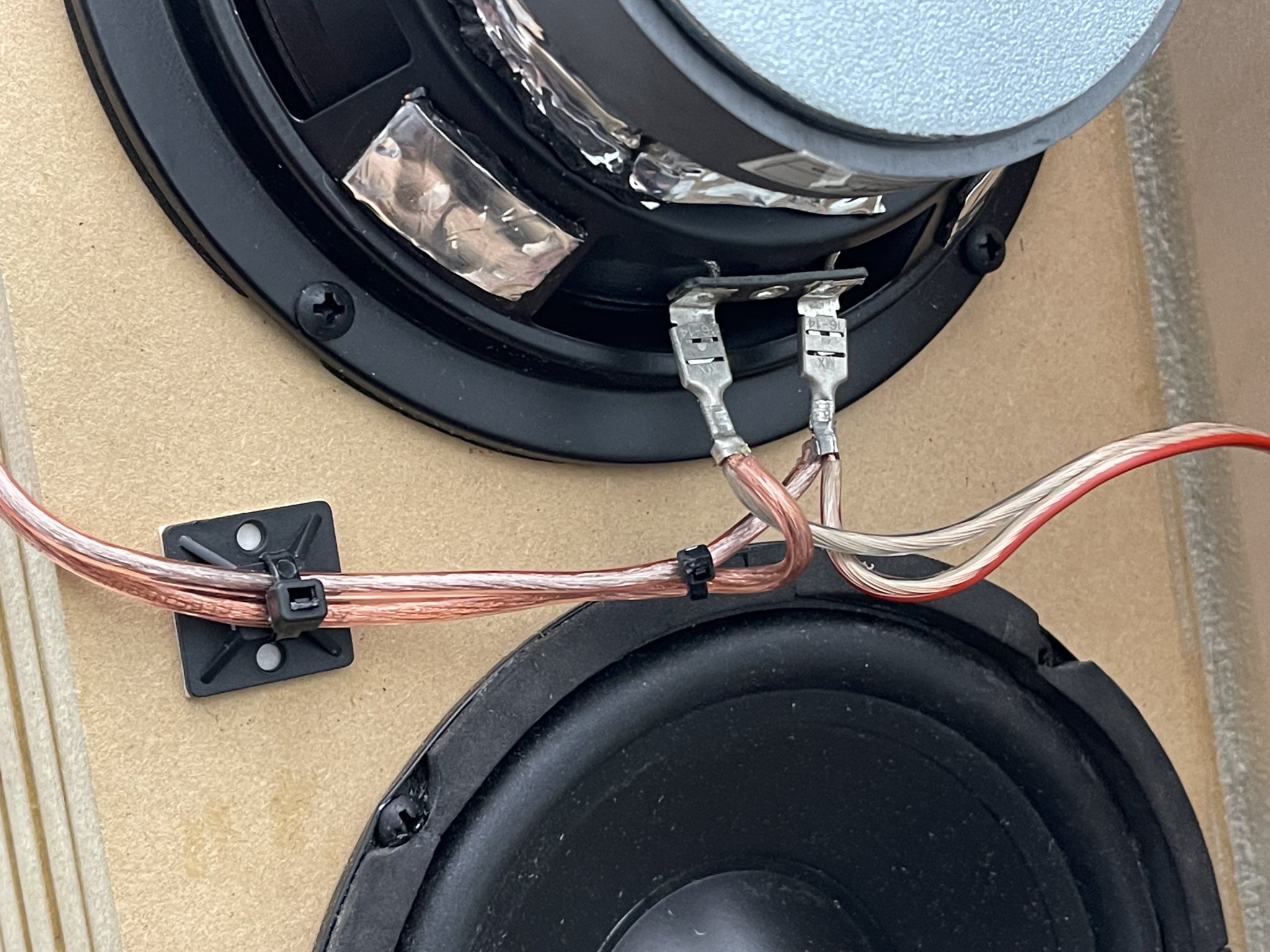

Detail of Noico sound dampening butyl sheets installed on driver frame/basket to reduce resonances:
Video of effect of sound dampening on woofer frame:

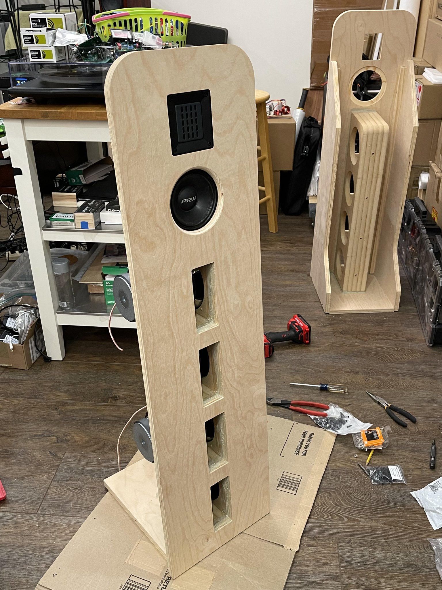

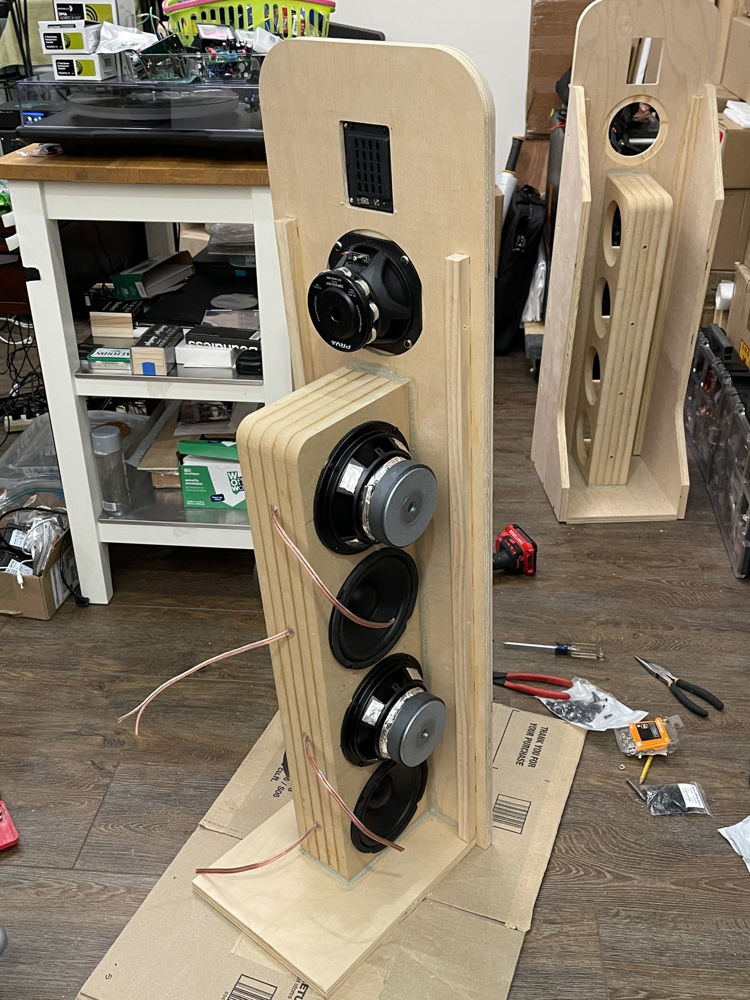

All drivers finally mounted in one XSD. I’ll do the second one tomorrow. This takes a lot longer than one imagines as there are 10 drivers x 4 screws. All needing center punch, pilot hole, then tighten screws.

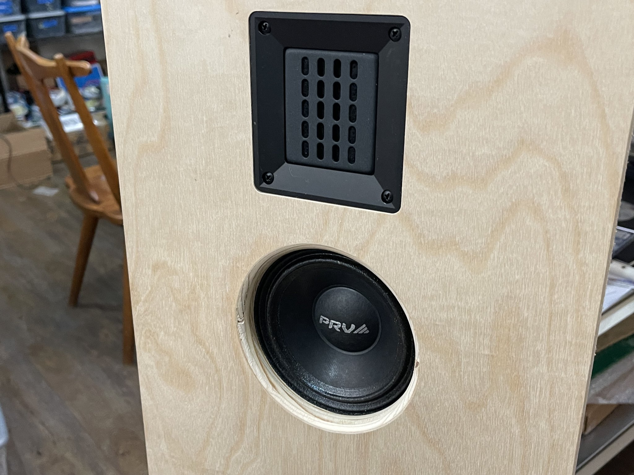

I wish I had some #6 x 0.5in screws for the tweeter. I ended up using pliers to cut them to size to prevent poking through. I used machine screws and nuts last time but this is faster and has nice black finish head.

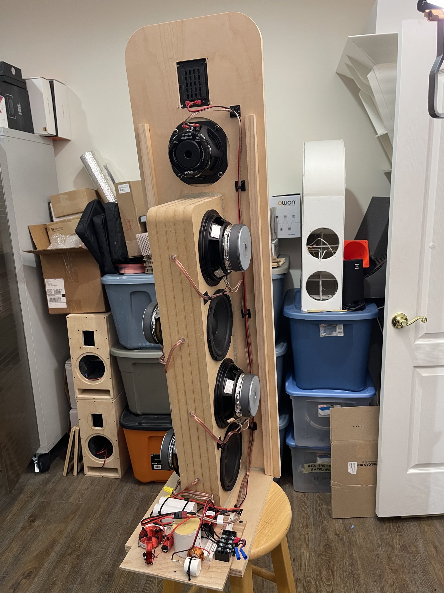

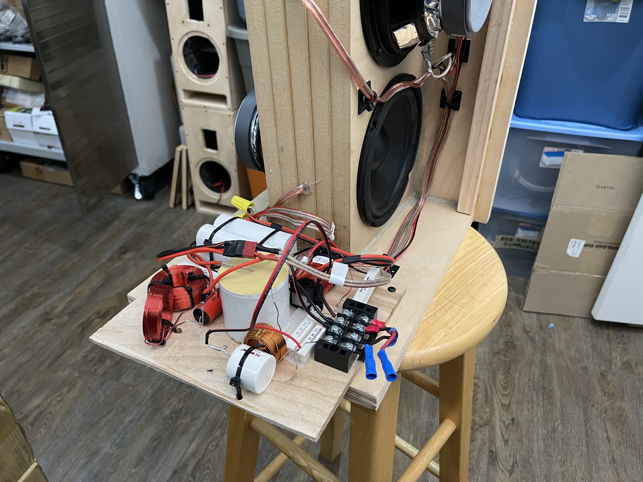

Starting to do the 4 parallel / 2 series / 2 parallel wiring. It’s kind of tricky, definitely needed to use the schematic diagram and then a 1.5v AA battery to check for correct cone motions.
I tend to have poor luck putting 2 wires in a single crimp terminal, so I use these.
https://www.digikey.com/en/products/detail/te-connectivity-amp-connectors/60279-2/297741
Good idea! I’ll have to get some.
For now, I am finished with one speaker.
