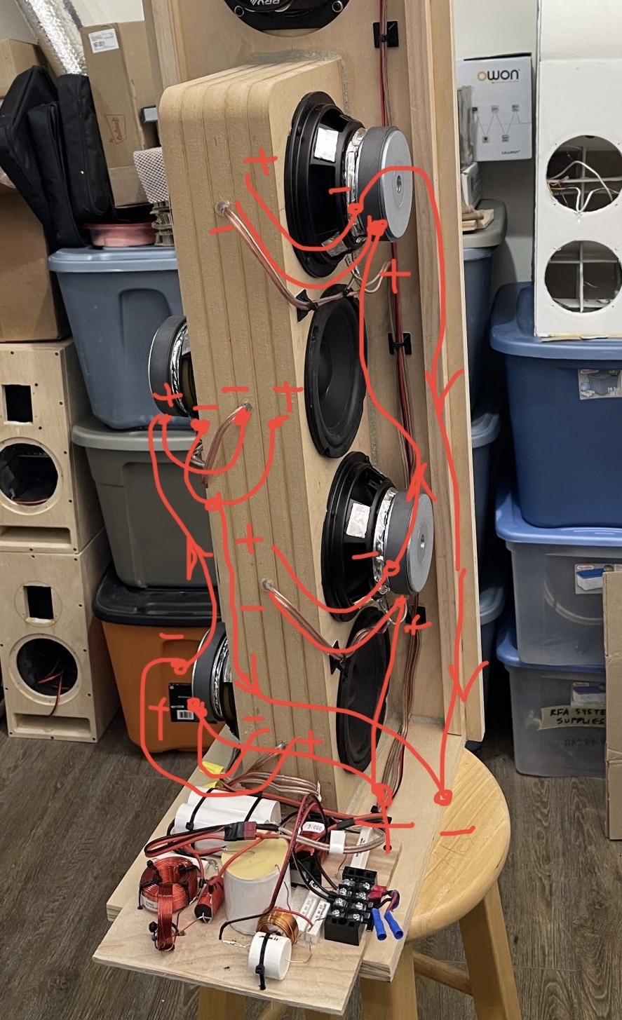

Wiring is now right and all bass drivers are pumping now air out of the slots . Burning them in is ongoing and the sound is getting better now .
I'll give them some more burn in time 😉 . The speakers are still not completely finished , but I wanted to hear them first before I proceed finishing them .

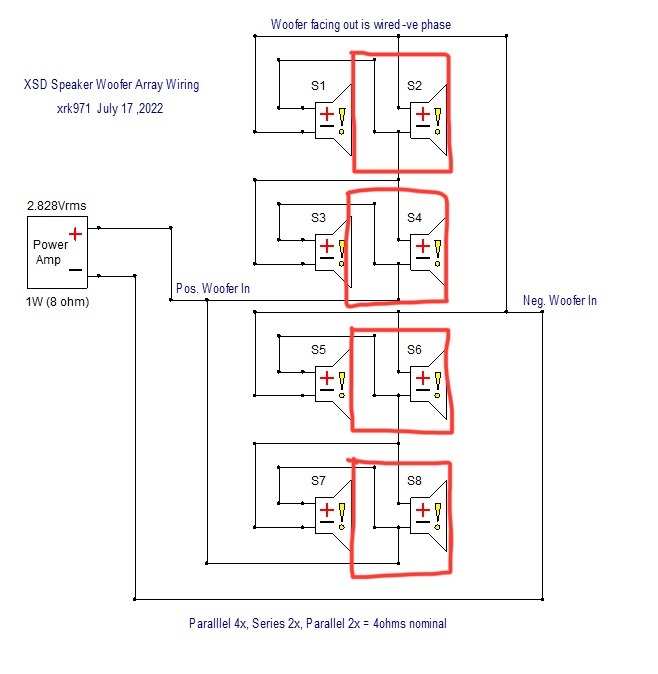

I'm not asking the question correctly, trying figure out how you wired. Let me come at it from another direction. Look at this post's crossover schematic with the red boxes you drew. Look at driver S1. It has only two wires, one to each speaker post. Now look at your post #712, first two pictures, second one an enlargement of same pic. it shows the top driver S1's connection. there are 4 wires there, two to each pole, Two come from its companion woofer with reversed polarity. What does the other pair go to?Please wire it exactly as shown in diagram above. Perhaps this diagram showing the slot loaded vents and how the drivers are mounted face in or out will help you (face out means magnet inside the slot).
Basically if the driver faces out, it needs to be reverse polarity. However, since the drivers are parallel then series speed, the output of the first parallel set (negative) goes to the positive of the second pair. For example, S3 and S4 are the first parallel set so amp +vs goes to S3 +ve and S4 -ve, the output of S3 and S4 then goes in series to S1 and S2 (parallel). The output of S1 and S2 then is the return to amp negative. This is one set of 4 drivers. The same thing for S5/S6 pairs and S7/S8 pairs. Note that I have the S even facing out in the diagram.
Finally, it makes no difference if both drivers orientations are flipped (left to right) as they will still squeeze air out on +ve polarity. That’s the final check. Use a battery to check each pair and then each set of 4 to make sure they all push in to squeeze air out.

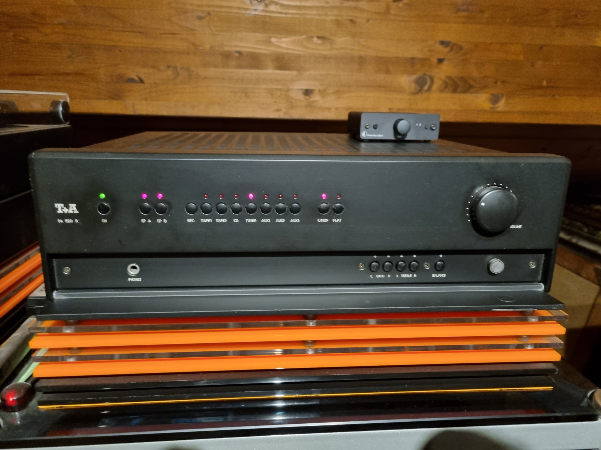

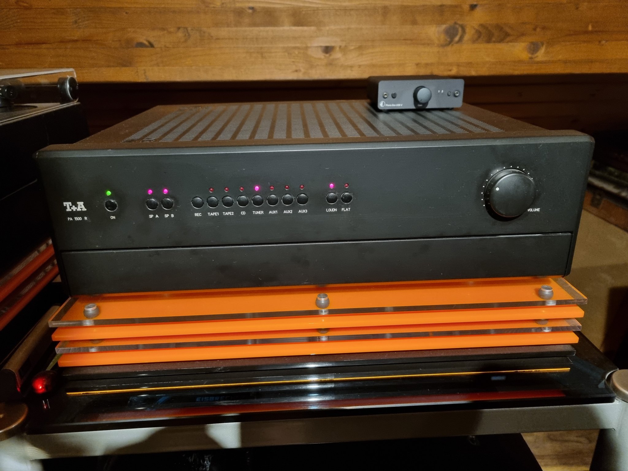

It is the KEF Q900 and T+A Jubilee 25th speakers . As Amp , I'm using a T+A PA1500R amp . 170W at 8Ohm and 310W at 4Ohm . This amp , although 25 years old , has enough juice to run most demanding speakers without a problem . It was running a pair of Infinity Kappa 9 without any issues in the past .Nice system you have there @wagnju ! Is that a KEF Q950?

T+A is a German High End brand and well known here in Europe .
It’s wired just like the diagram. I think what might be confusing is that the external magnet connectors have two connections (1 for the parallel internal driver and 1 for connecting to other pair of crossover).I'm not asking the question correctly, trying figure out how you wired. Let me come at it from another direction. Look at this post's crossover schematic with the red boxes you drew. Look at driver S1. It has only two wires, one to each speaker post. Now look at your post #712, first two pictures, second one an enlargement of same pic. it shows the top driver S1's connection. there are 4 wires there, two to each pole, Two come from its companion woofer with reversed polarity. What does the other pair go to?
The negative of one pair in parallel goes to the positive of second pair in parallel in order to get a series connection.
Yes, when I saw 4 wires, I started looking at the hook up drawing. The drawing shows the connection to the next driver pair, from S2- to S4 +. I already had the connections soldered to S2 and the driver mounted. Looking at the connection, I thought well, just slide it down the line to S1 + post which is exposed. This would explain two wires on that pole. The other would be negative woofer in, slid around to neg post of S1, explaining the other second connection.
Round about as it may be, my grasp is now ready to get to crimping. Had to order some more crimp connectors, for 10-12 gauge too help fit the ones with two wires. I did open up a few by hammering a punch on the open end, spreading it open. Easier to order bigger ones.
I have lengths of wire from the tweeter and midrange connected, going down to floor not yet soldered to board. Wires to connect all the woofer pairs are installed in their respective drilled holes. I also received the "egg crate" foam to line the inside of the wings.
