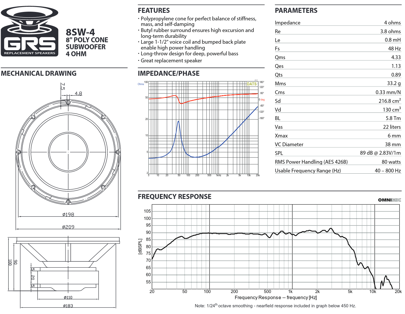

I have a question about the sizing of the SLOB design.
Is there any rule of thumb pertaining to the diameter of the driver hole compared to the diameter of the magnet on the back of the driver and how close the magnet can be to the adjacent driver's hole ? Moving he magnet closer to the adjacent driver's mounting hole will increasingly block the flow from the adjacent driver (Inside cutout diameter minus outside magnet diameter).
I am considering this arrangement for a sub cabinet.
Thanks in advance.
Thanks in advance.

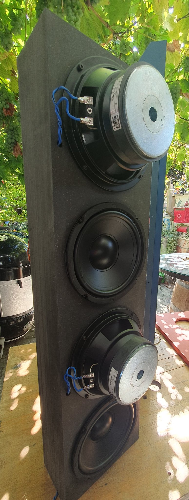

A smaller volume gives you a wider bandwidth (upper reach). But it is dominated by the depth slot aperture to back of chamber. Make sure there is enough room for cone to move without bumping. Sim for smaller than larger. Set the exit aperture to circa 20% to 40% of Sd of two drivers. It is mostly a case of making it fit practically. Ideally you want to run a simulation.

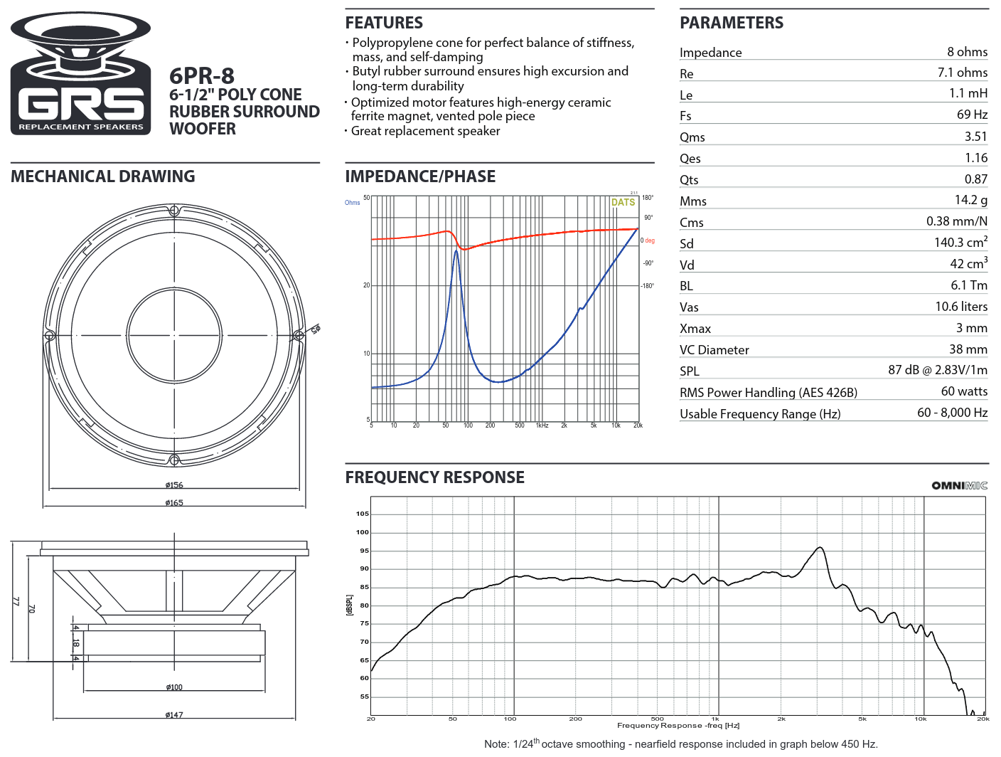

Parts Express just provided a new data sheet for the GRS 6PR-8 woofer that shows the cutout needs to be 147mm dia not 5.625in (143mm) as shown in their text description of the driver.
No wonder why the holes were tight and had to be enlarged. Sheet shows TS parameters and frequency response. This is nice and shows the broad and fairly smooth response. Since we use the slot to force the low pass falloff at 470Hz, the breakup peak near 3kHz is not an issue at all.
https://www.parts-express.com/pedocs/specs/GRS Spec Sheets/292-426--grs-6pr-8-spec-sheet.pdf
PartsExpress has 2 versions of the GRS PR woofer (6" and 8"). They also have a 8" SW subwoofer version with similar parameters, but a flatter response curve and 8 mounting holes vs 4. The 8SW-4 subwoofer version does not appear to have the peak at [2-3]kHz, has twice the XMAS and lower FS. QTS are all at 0.87 or above for open air. They all appear to be a variation on a theme so the basket dampening probably applies to all.
VAS is 2X and SD is 50% higher so the higher unit price should be offset by the reduction in driver count for the same amount of air (@ 3:2 reduction).
Is there any reason why the 8" 8SW-4 subwoofer version would not work in place of the 6.5" version.
Also, is there a way to determine distortion from the TS values (e.g. Qms and Qes) ? All 3 have the same 38mm VC Diameter so probably the same motor.
(DIY Tip: Big Box building stores carry peel-and-stick foil/metalic backed vinyl rubber "Fire and Ice" roofing rolls in multiple widths under different brand names that are much cheaper than buying dampening products like Dynamat Extreme. I have used both on various projects with similar results.)
https://www.parts-express.com/pedocs/specs/GRS Spec Sheets/292-480--grs-8sw-4-spec-sheet.pdf

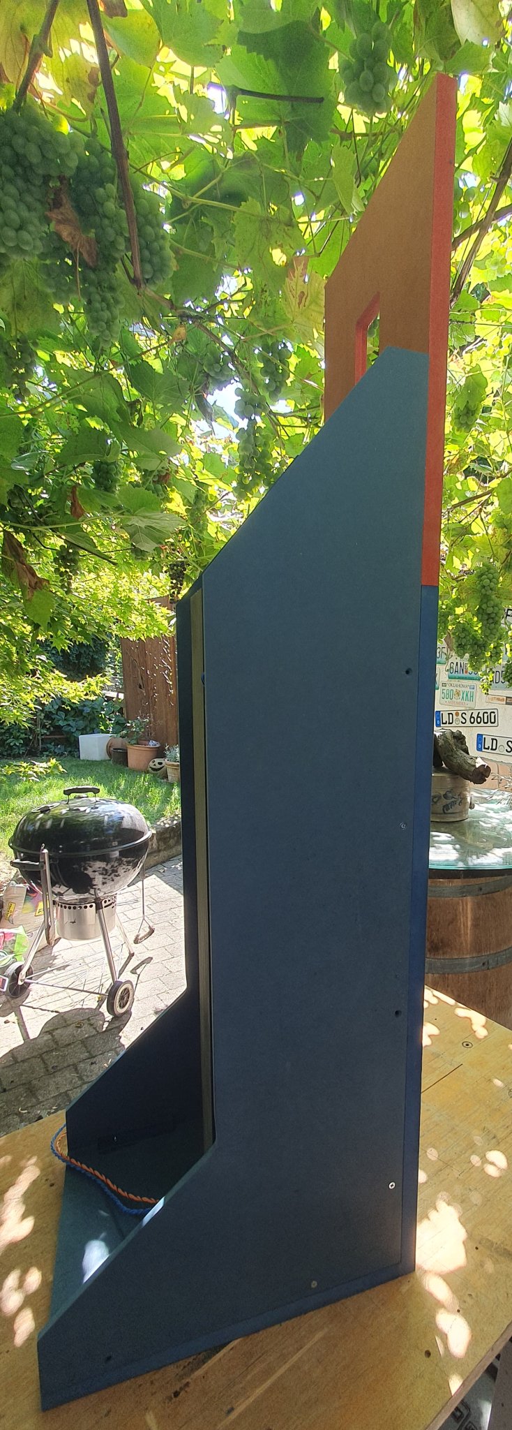

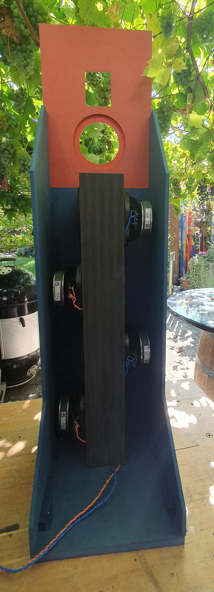

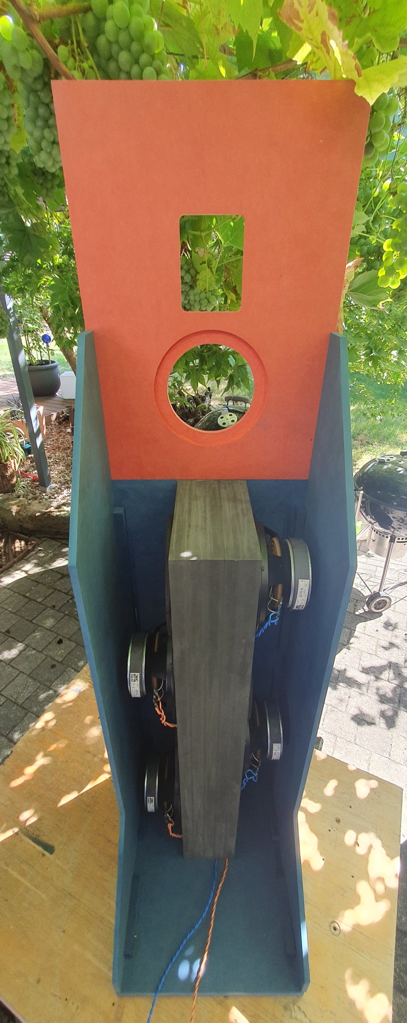

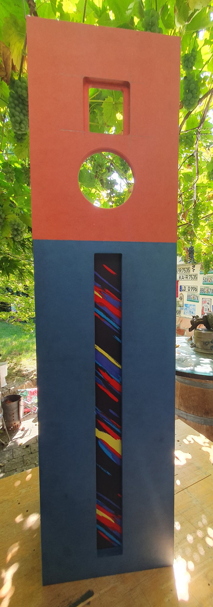

Hi Guys
Just a short update on my build .
FInally I got some time to work on my XSD speakers . I could get my hands on some colored MDF sheets . Not sure if its the final solution but minimum it shows some progress .
Drivers and crossover will be installed soon .
Just wanted to give you a teaser as I'm interested to see other designs or build updates .
Juergen
