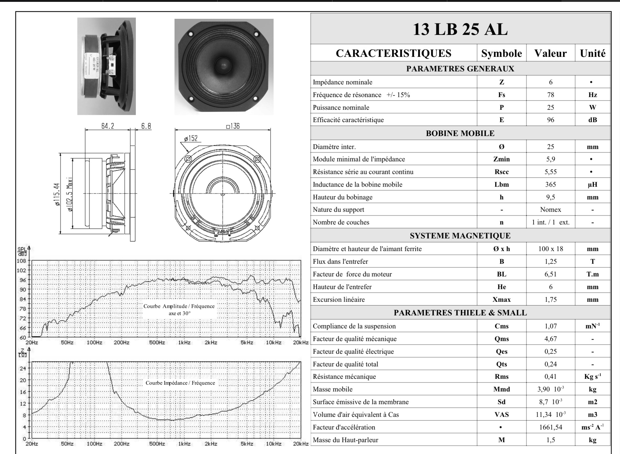

That is great info radian. I had come to this conclusion, but with less specificity. My conclusion was reached, of course, not experimentally, but by lurking and reading stuff online hahaIf one wants the nice form factor combined with top performance the two octaves from about 120hz to 480hz calls for a low q mid xmax driver. The control such a driver has over it's cone is key in this critcal range.
Active or digital xovers are mandatory though to limit excursion of the high spl low q Driver.
Someday, I'd like to make a speaker that uses SB racetrack drivers in a SLOB configuration driven actively by Hypex Fa123 plate amps. The mid and high frequency drivers will use passive filters. This makes me even more eager at the prospect

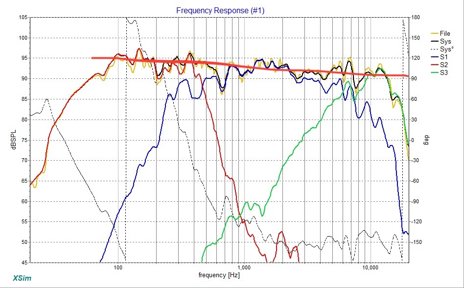

Looks like an awesome speaker. Im a noob but, for me the frequency response looks far from the Harman kurve. Am I correct and how are peoples fealings about that?
Cheers!
Cheers!
I aim for -5dB down tilt from 100Hz to 20kHz. That’s my version of the Harman curve. In listening to it, it never feels fatiguing yet full of detail and life.

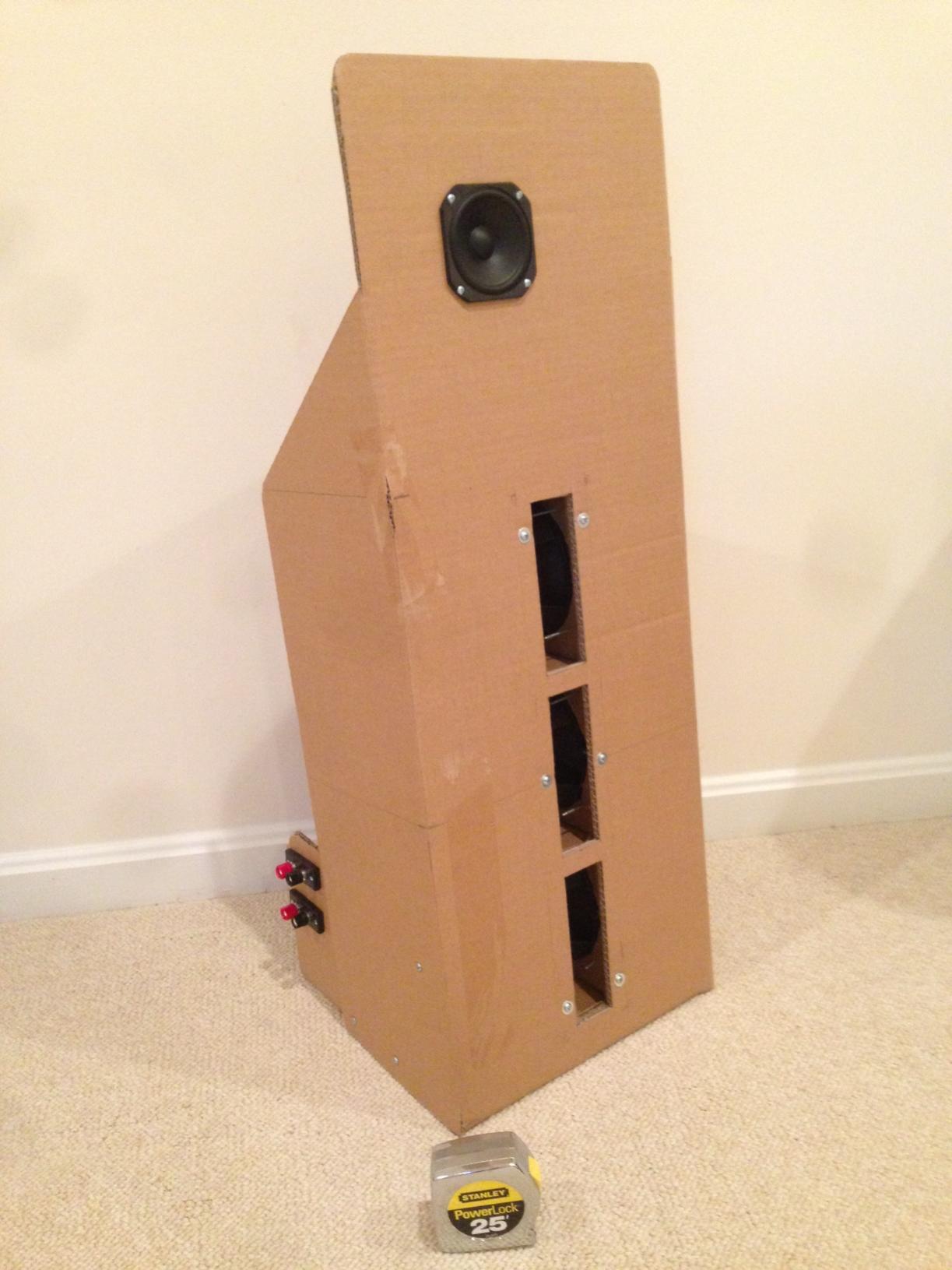

The first prototype 8 years ago was made of cardboard and about the same dimensions so I had a good feeling it would work based on that experiment and Akabak simulation of the box. The width was close enough to 3 sheets of 3/4in MDF plus I needed room for the driver magnet and basket mounted inside.
No, I did not try another aperture size. The vertical spacing was based on how close together they could be installed with practical considerations.
