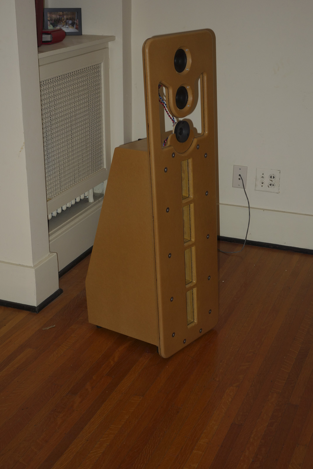

Your 5.5" x 2.25" slots seem to be larger in area than 1/3 the cone area of one driver but less than 1/3 the area of 2 drivers...I think I read Pass recommending 1/3 the cone area. Did you come up with your slot size based on measurements, trial and error, or am I mistaken (good likelihood)...
one driver (140cm2/21.7sq in) X .33 = 7.161 sq in
two drivers at .33 = 14.322 sq in
slot size:5.5 in X 2.25 in = 12.375 sq in
So it seems that if you are calculating for 1 driver, your slot is quite a bit larger than .33 and if you are calculating based on 2 drivers per slot, you are quite a bit less than .33 at roughly .28....
I am assuming you used the area of two drivers...

My memory may be off. It might have been aiming for 0.25 for two drivers. It doesn’t make sense to compare slot area to one driver. They work in unison.

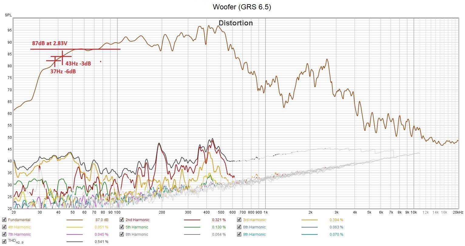

80cm2/280cm2 = 0.29
Somewhere between 1/4 and 1/3rd. It’s not a big deal and not a super important parameter as far as the slob performance goes as long as you can achieve the upper and lower bass extension you need in a flat as possible response.
Here was the raw full range response no electrical filter. This is not a bad woofer response to work with for a XO development. The higher distortion peaks shown here were eventually eliminated using Noico butyl sheets in the woofer basket spider arms. -3dB was 44Hz and -6dB was 37Hz assuming a nominal SPL of 87dB but -6dB of 44Hz for 92.5dB as the baseline sensitivity for working the rest of the XO.
80cm2/280cm2 = 0.29

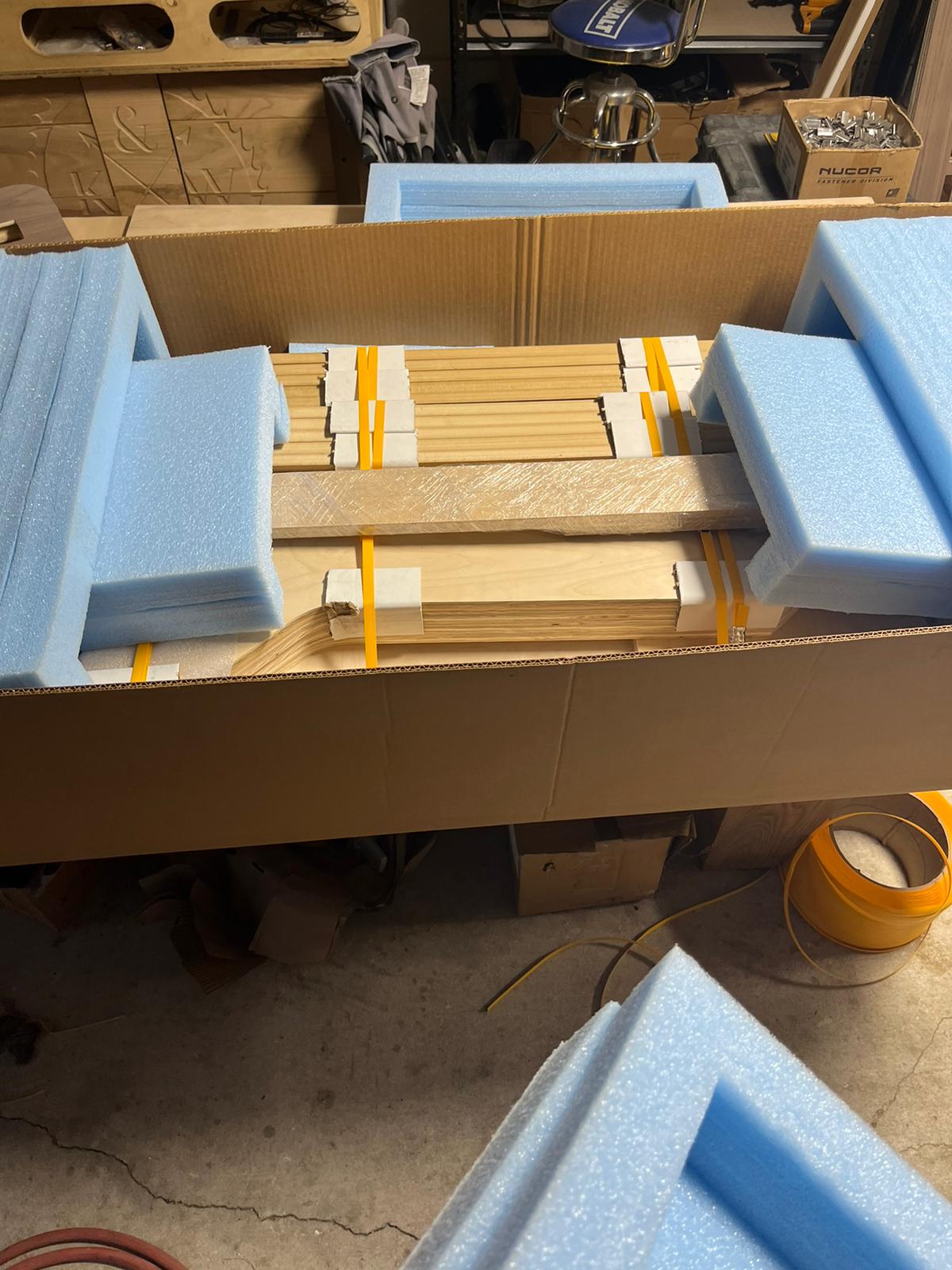

I recall reading earlier in this thread that you were looking into selling flat packs of just the woofer cage. Did you ever make a decision on that?

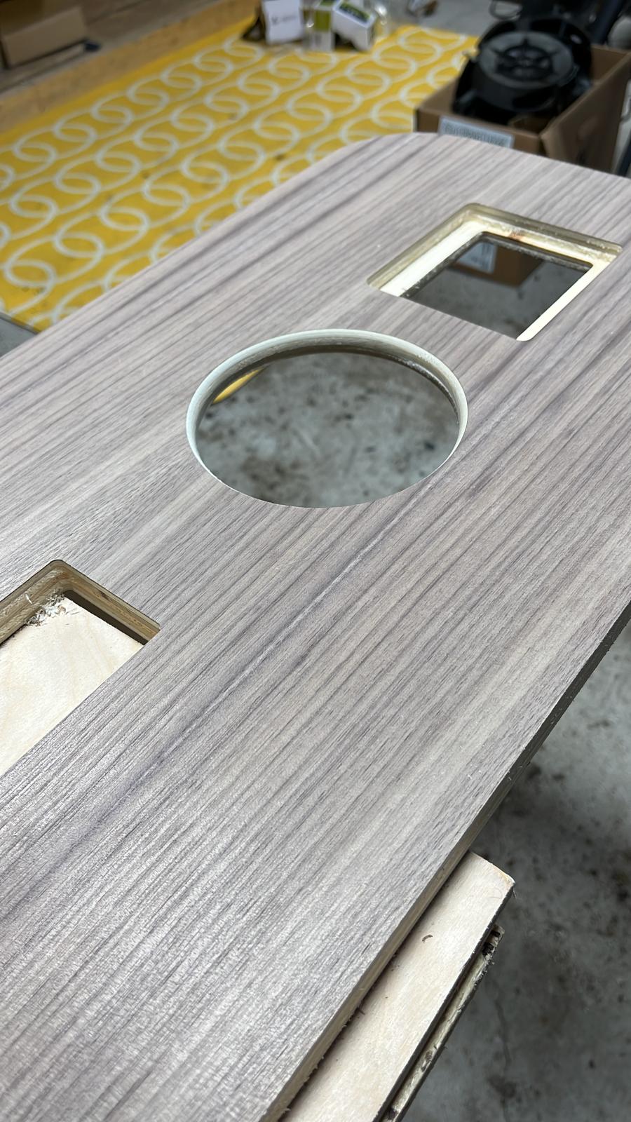

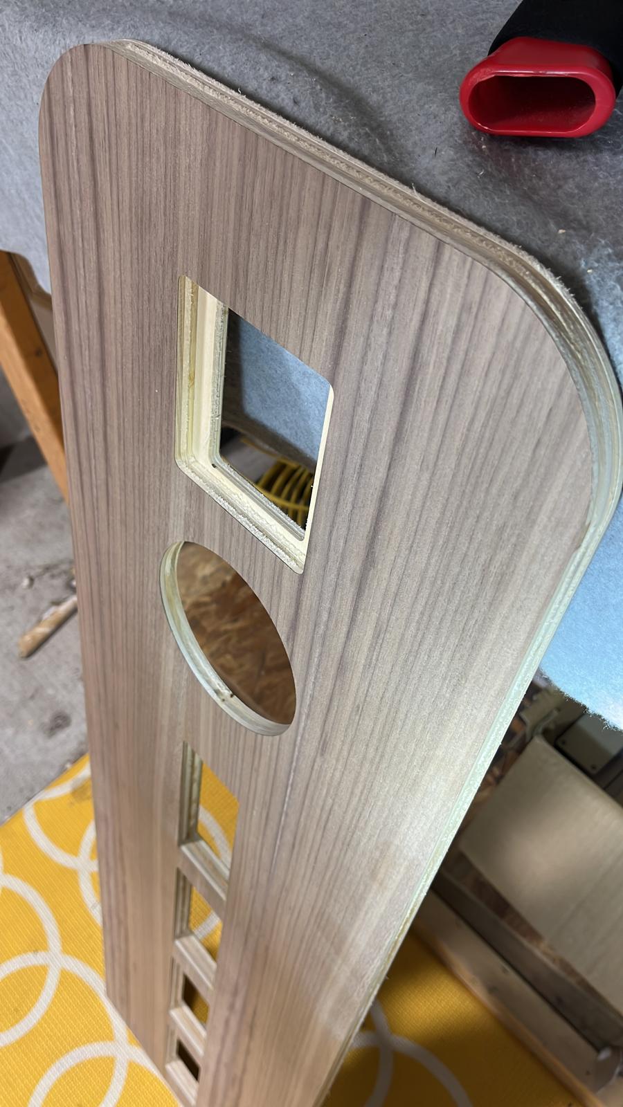

Having spent quite a bit of time attempting to do this all myself, I can tell you that $750 for birch or $1050 (both include shipping @ $150) is looking better all the time. I have made so many mistakes. I think I will have a working pair in the next month or two, but suspect that I will need to paint them a flat black hoping to have them disappear visibly as well as acoustically - LOL

You don't need to paint them black.Having spent quite a bit of time attempting to do this all myself, I can tell you that $750 for birch or $1050 (both include shipping @ $150) is looking better all the time. I have made so many mistakes. I think I will have a working pair in the next month or two, but suspect that I will need to paint them a flat black hoping to have them disappear visibly as well as acoustically - LOL

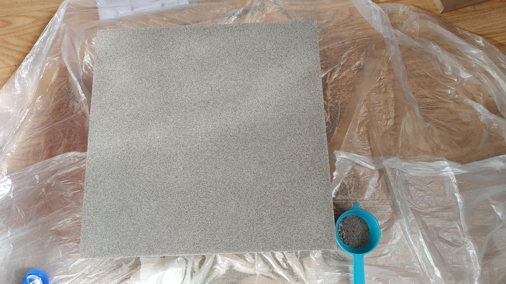

Look at my ripoles. I rolled on some pva glue and used a little sieve to sprinkle fine sand on.
They are about 2 years old and do not let go of the sand.
In art shops you can find a variety of fine sand colours.
One side at a time of course.
If any imperfections are bothering you you can always dip a toothpick in pva and apply to vacant area and then put sand on it.
Greets Klaus

Answers inline below
Been studying this design & reading this thread off/on for months, maybe years. 😉 Obviously a very successful design, judging by the documentation & user comments. 👍
A few questions for xrk971 or any user who has answers:
1. To simplify construction & lower the total weight, can the 4 separate slots be replaced with a single long slot or 2 slots for 4 drivers each?
Yes, but the chamber volume grows and the distortion cancellation of each pair is not as effective. Volume will reduce immediacy.
2. Why isn't the top of the back portion of the bass array closed? That seems incomplete compared to John K, Pass or Linkwitz implementations of slot (or W) OB configs.
To allow mid and tweeter to blend with bass dipole on back. But probably would give better bass I don’t know.
3. Has anyone used alternatives for the PRV Audio 5MR450-NDY mid driver? I ask partly because I think I've seen better drivers of the same size, and I also happen to have some Satori 5" drivers that are at least the same size.
There are of course other drivers but my passive Xo is for this one. Satori isn’t 93dB sensitive so woofers would overpower it. I tried 6.5in 6FE100 and it sounded pretty good. But that driver isn’t as low distortion.
4. Will minimizing the baffle around the mid & tweeter help the overall sound by reducing diffraction?
Yes, this was done by earlier design by member Z transform.
https://www.diyaudio.com/community/threads/cheap-and-fast-ob-literally.249984/post-3842488

Flocking looks to coarse for me. The finer the particles the better it looks.a variation of flocking....I have thought of flocking around the speakers on the baffle....
Key is to put much more sand on than will be necessary. Once it's dry you turn it over and the excess sand falls of leaving a very even look.
A few tests with skrap material helps to determine the right amount of pva glue.
