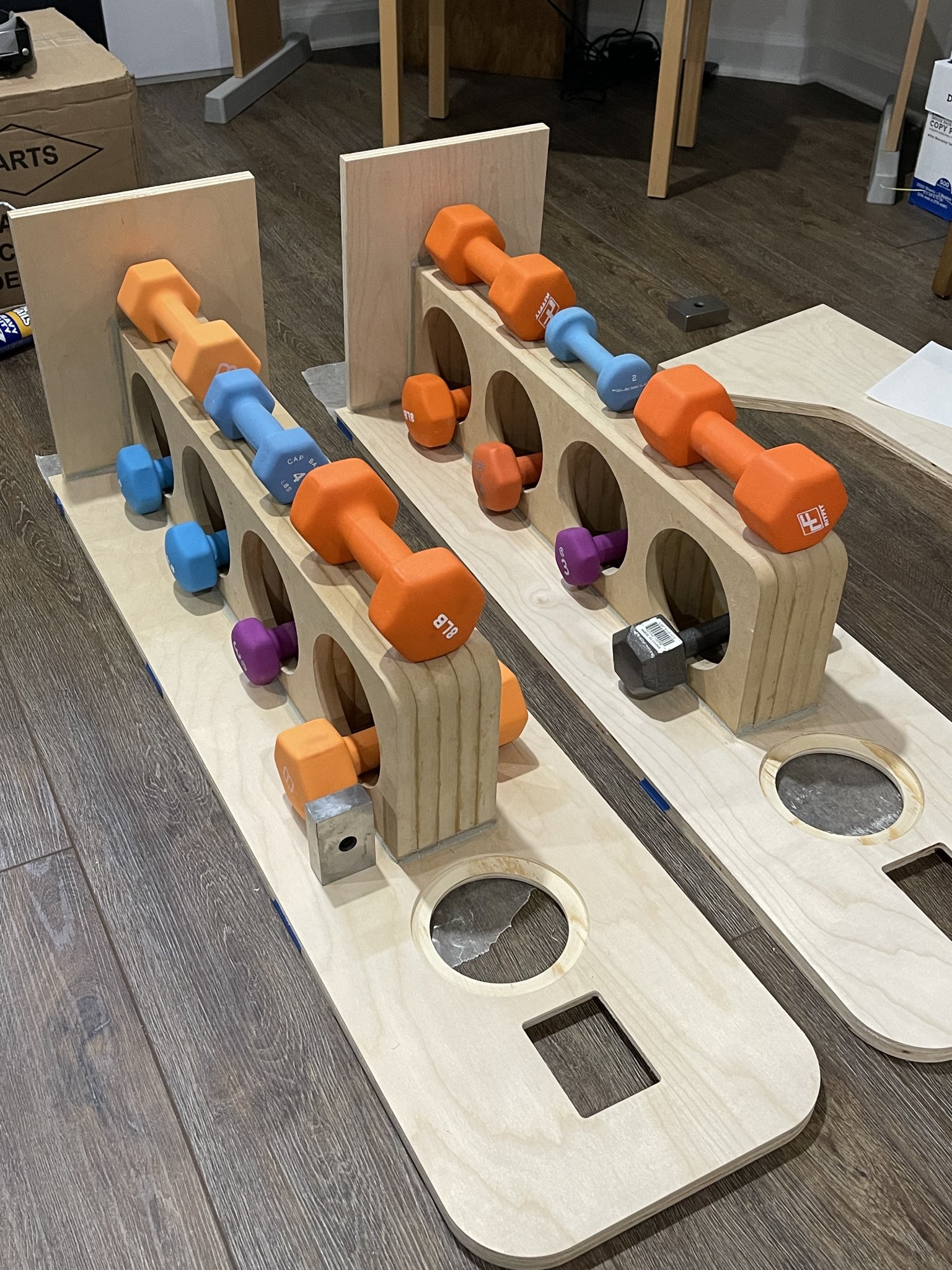

I just spent almost an hour in the sun on my front steps (don't want to make all that dust in the house) enlarging the woofer cutout holes by a couple mm with a Dremel tool and sanding wheel. Not too hard but exactly the reason I build a verification unit from the flatpack to catch these sorts of things.
Ready to glue the woofer array box to the baffle and base now with PL Premium polyurethane glue that will fill gaps and voids.

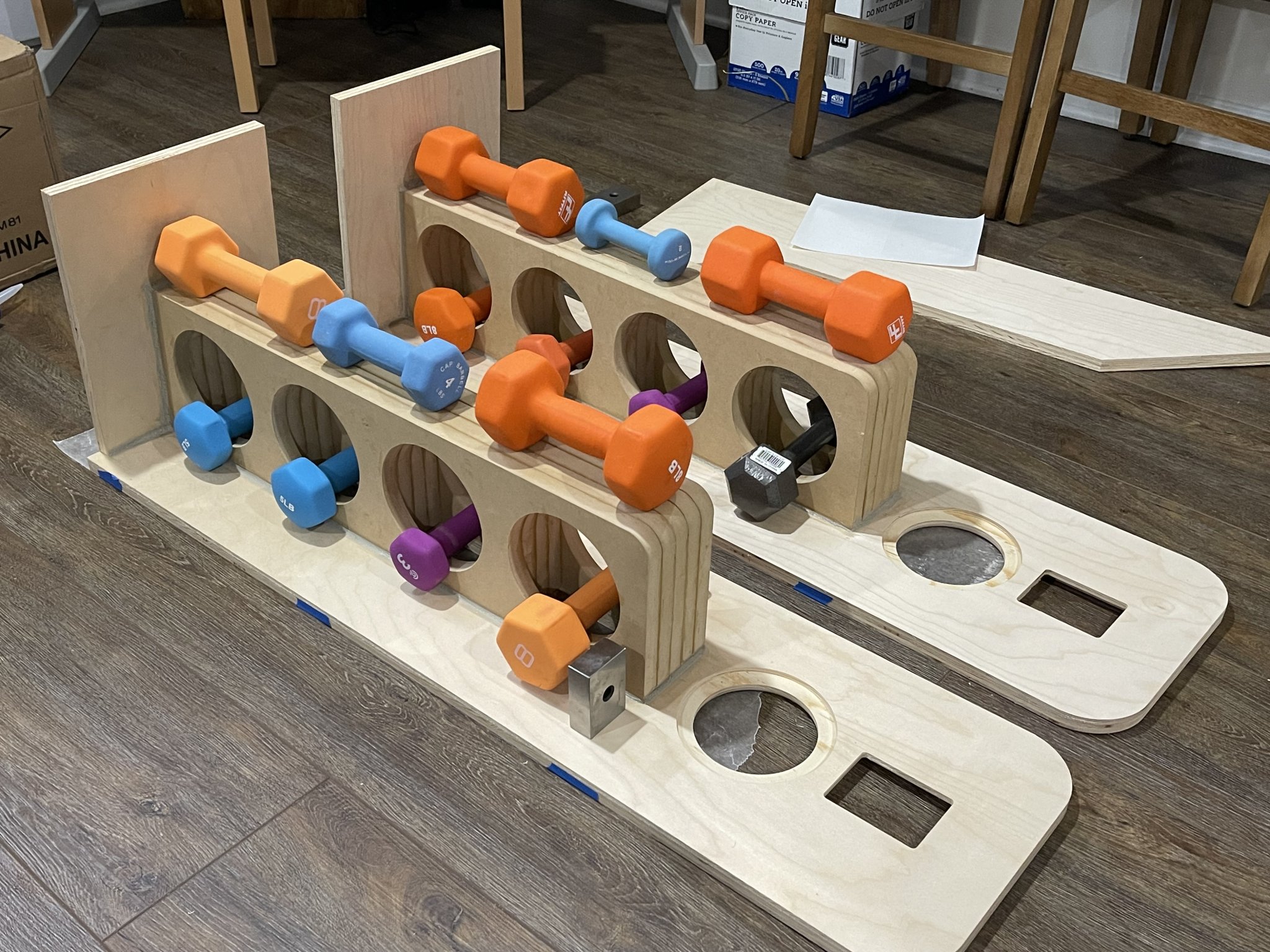

I am behind on assembly. Need to glue woofer box to baffle and base still - I think I need to keep alignment with some screws so stuff doesn’t shift when clamped.I wish I could have built mine myself, but wood working skills are not my best side! I want to get going so bad its ridiculous! How are they breaking in?
Russellc
Funny, it looks easier than your typical box speaker but it is different enough to make it more difficult. Indexing the parts is mandatory, glue just acts like a lubricant under pressure. You also will have to commit to at least 6 big clamps to assemble the bass box.
Progress finally. Glue applied and now waiting to set. I had an old unopened tube of PL Premium 8x. It was probably expired because very viscous and took all my strength to squeeze out of the applicator gun. OTOH, the stuff doesn’t run and fill big gaps well. It’s very humid here in DC area so this should cure easily without application of external water mist.
Let’s wait a day and see what it looks like and how strong it is.

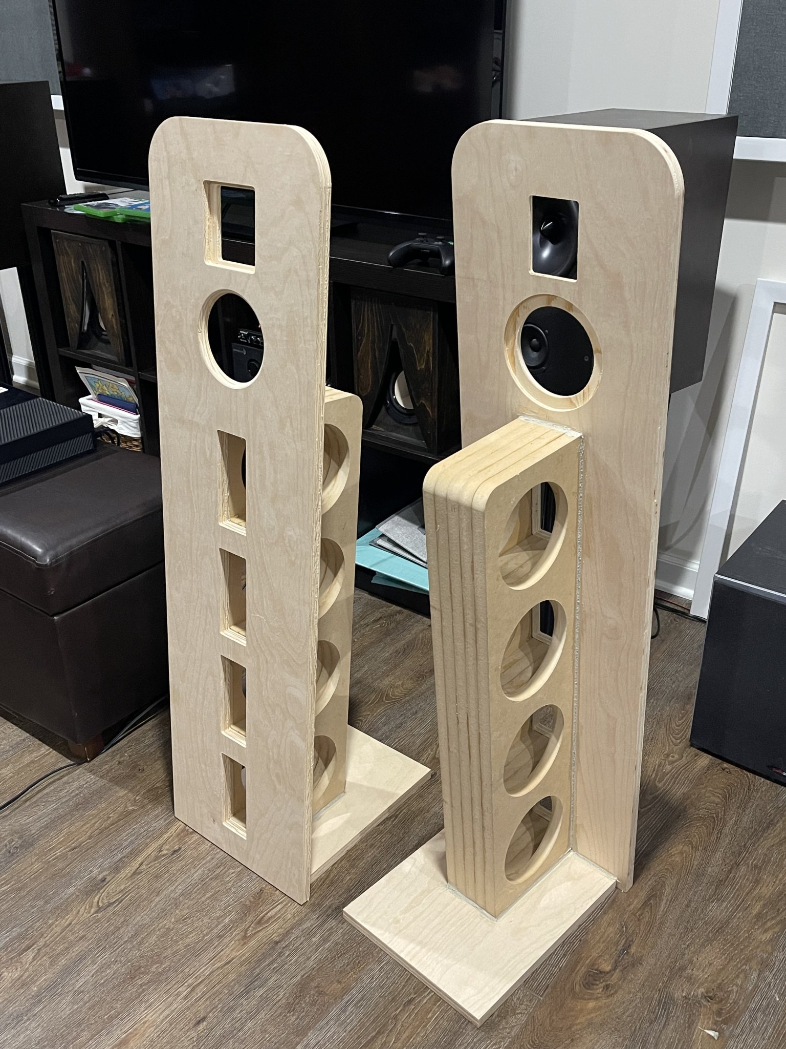

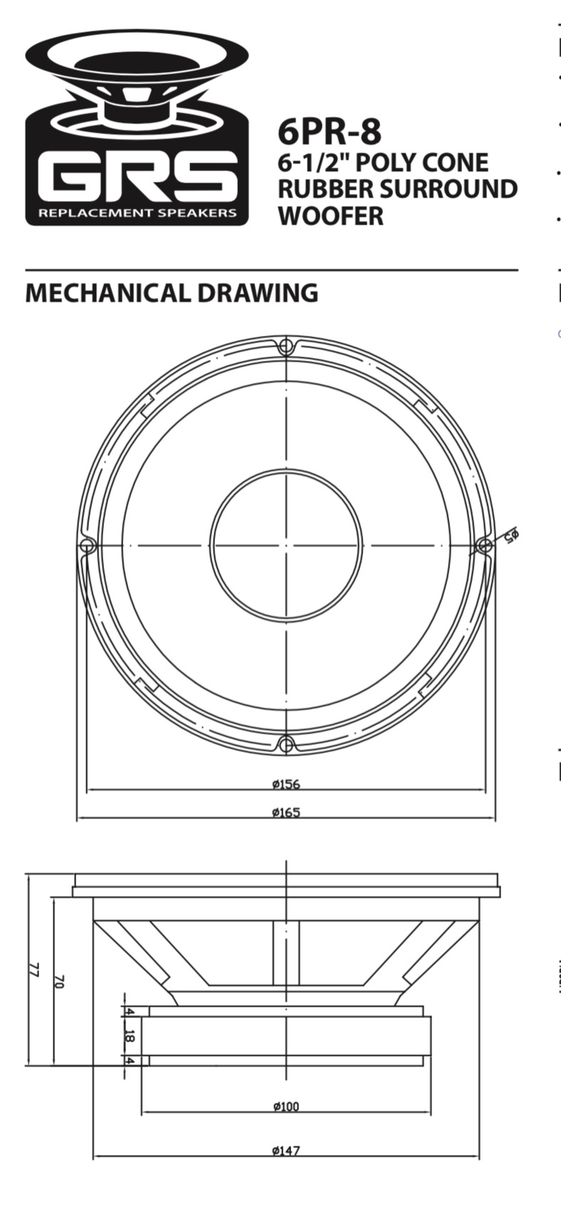

Woofer box and baffle/base all glued up now. Parts Express just provided a new data sheet for the GRS 6PR-8 woofer that shows the cutout needs to be 147mm dia not 5.625in (143mm) as shown in their text description of the driver.
No wonder why the holes were tight and had to be enlarged. Sheet shows TS parameters and frequency response. This is nice and shows the broad and fairly smooth response. Since we use the slot to force the low pass falloff at 470Hz, the breakup peak near 3kHz is not an issue at all.
https://www.parts-express.com/pedocs/specs/GRS Spec Sheets/292-426--grs-6pr-8-spec-sheet.pdf
