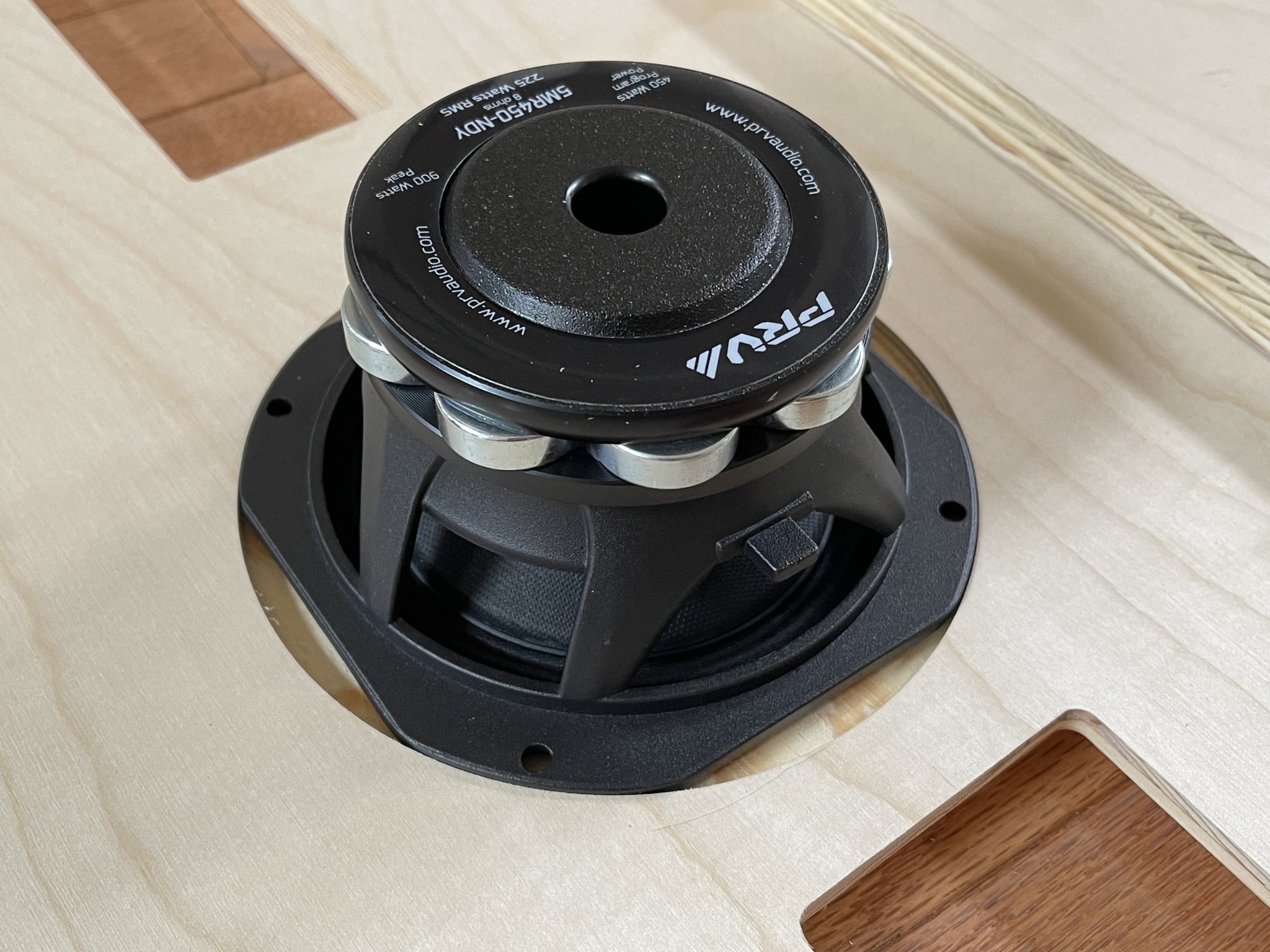

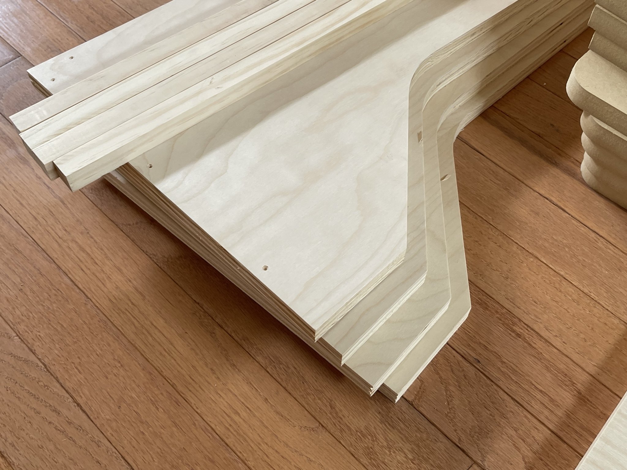

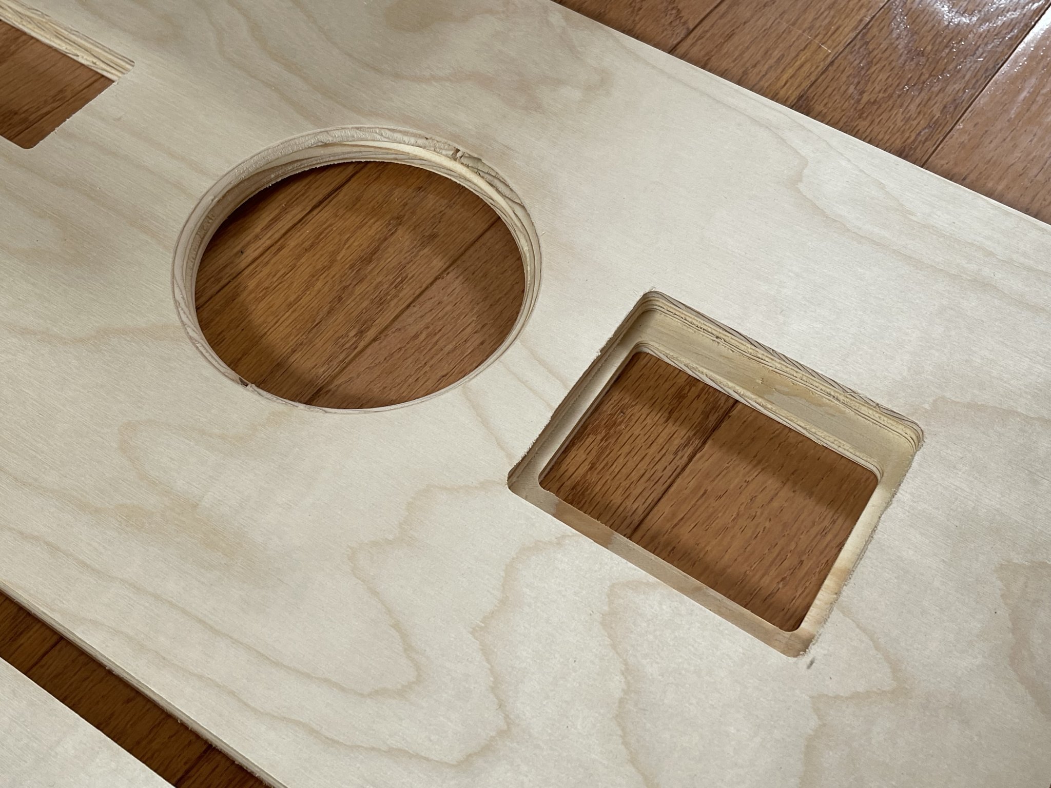

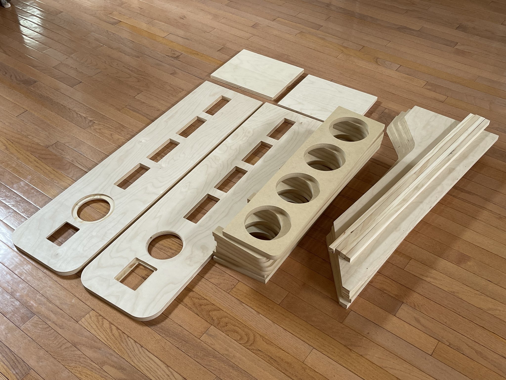

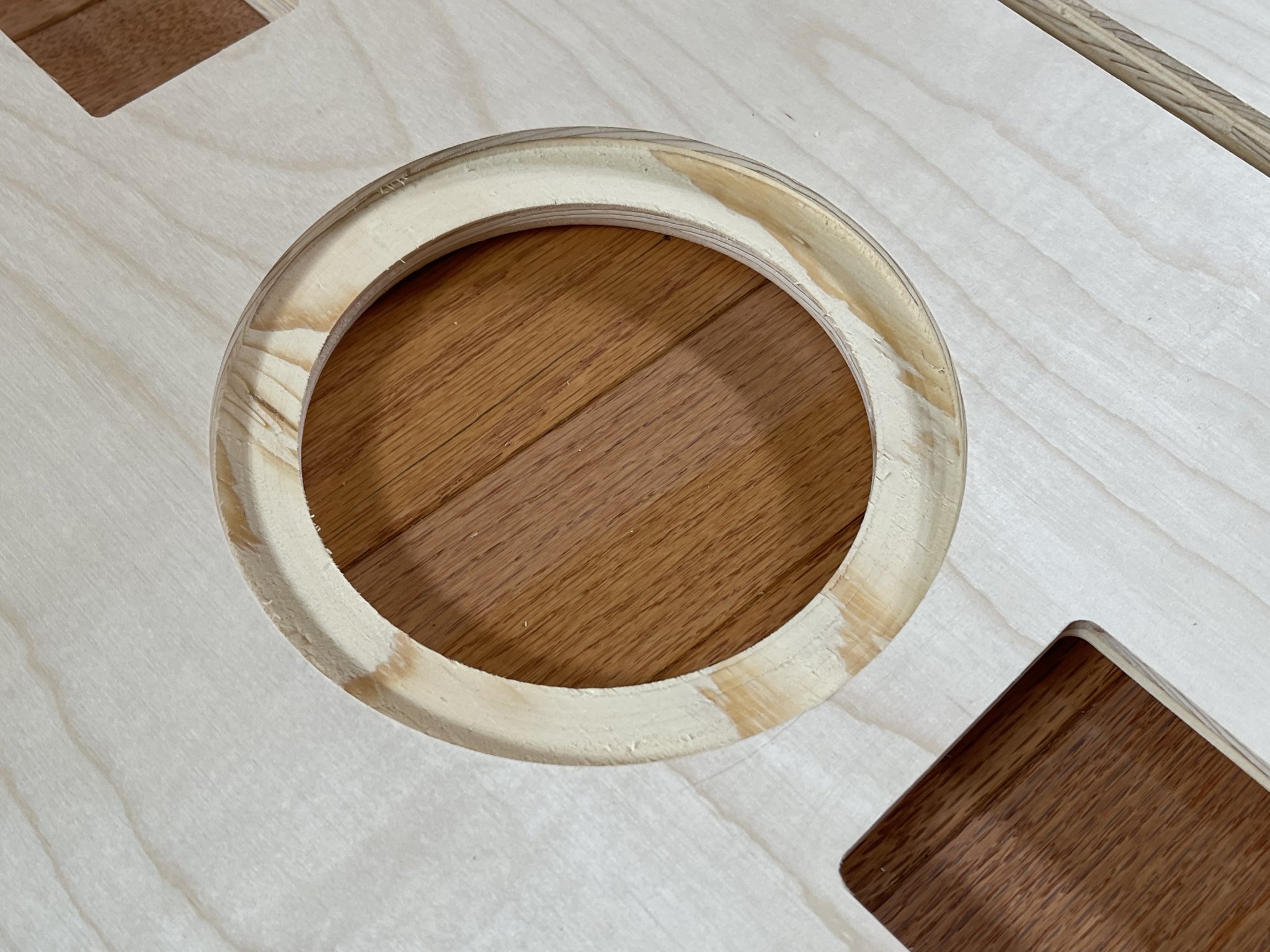

The new Tru-Ply birch veneer plywood flatpack arrived. I think this wood looks great. I didn’t have any issues with voids. The exterior birch is smooth and clean. The midrange cutout fits perfectly. The woofer could still use +2mm more on diameter. I’ll fix with a Dremel later but production ones will be bigger.
Wings and ledgers:

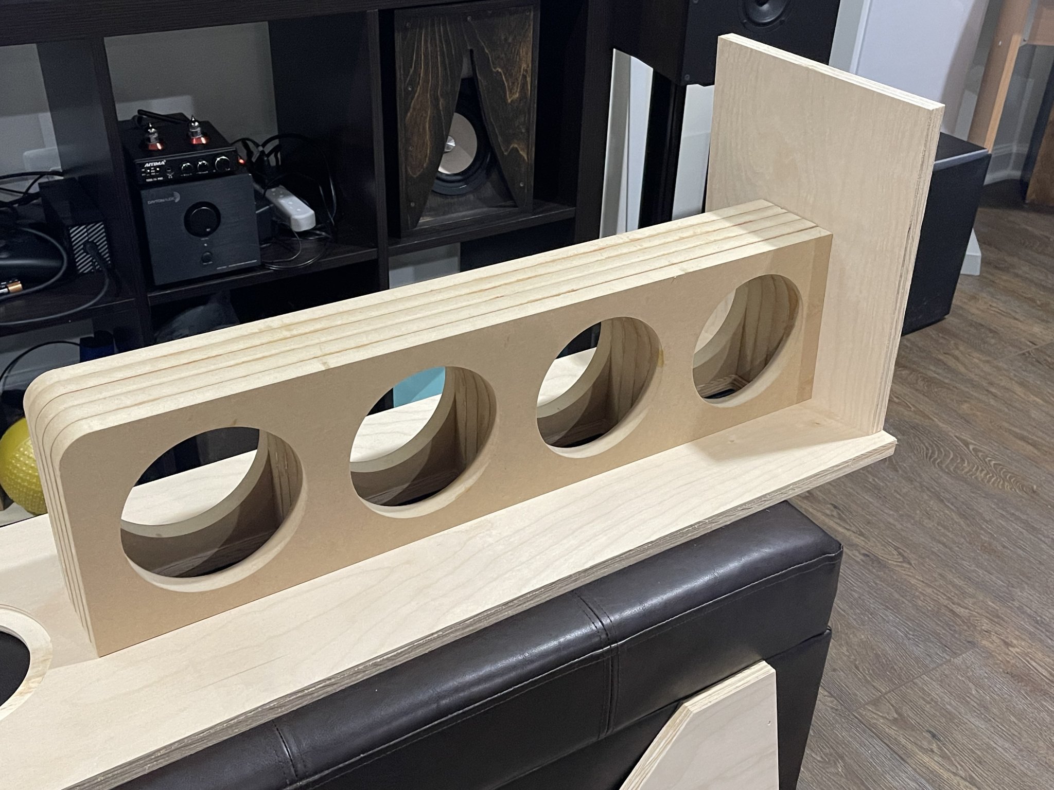

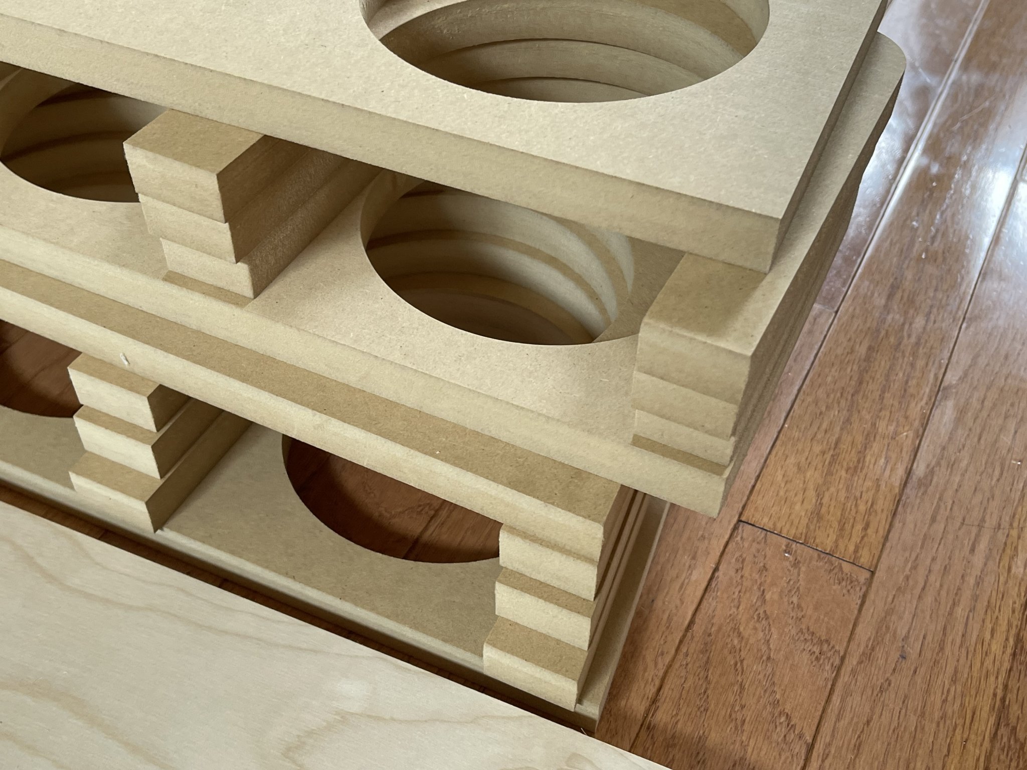

Woofer arrays:
Midrange rebate on back:
Midrange roundover on front:
Tweeter waveguide fit check:
Midrange fit check:

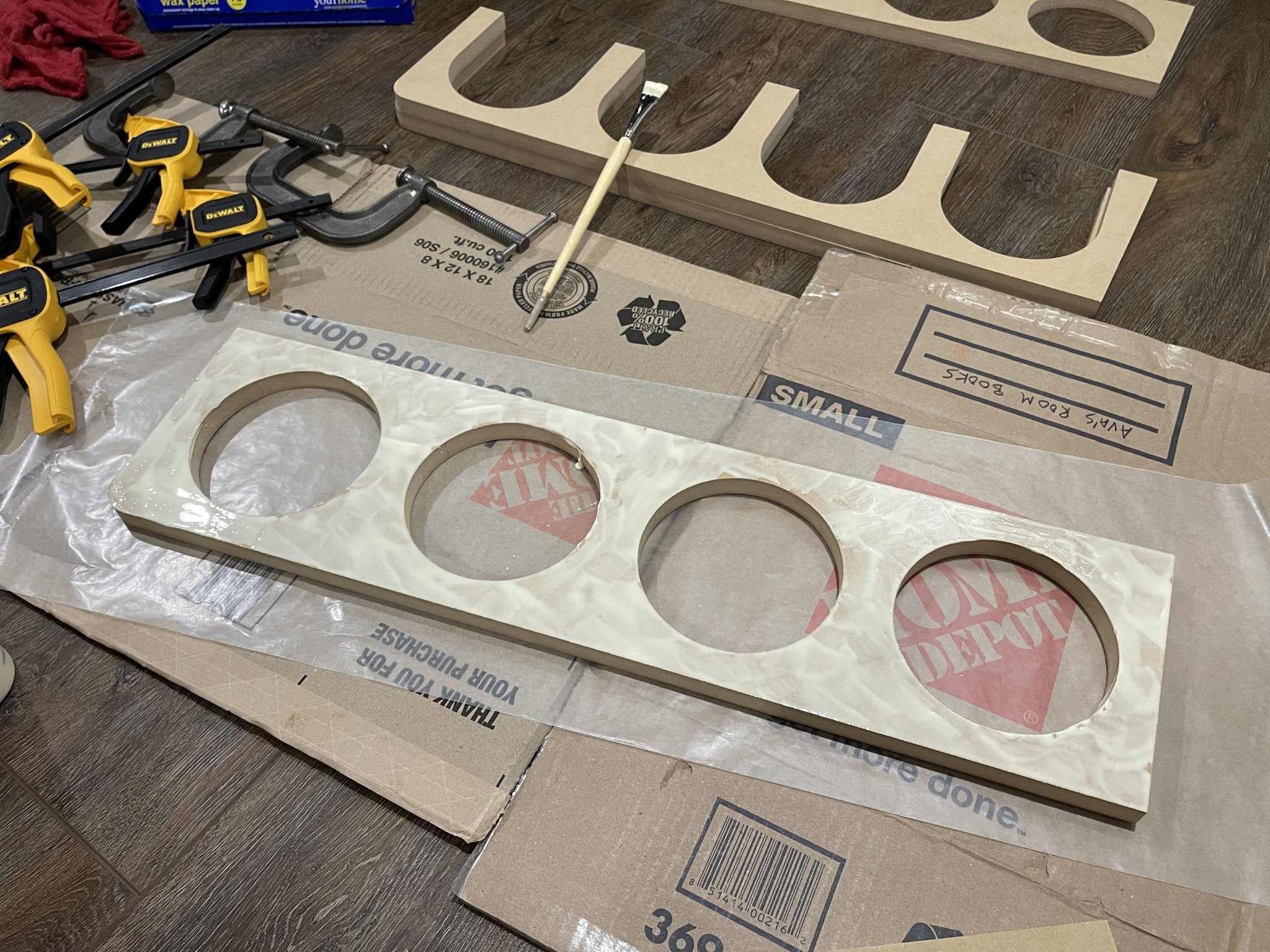

Starting to glue:
It would have helped to have alignment peg holes:
Wings and ledgers:
Woofer arrays:

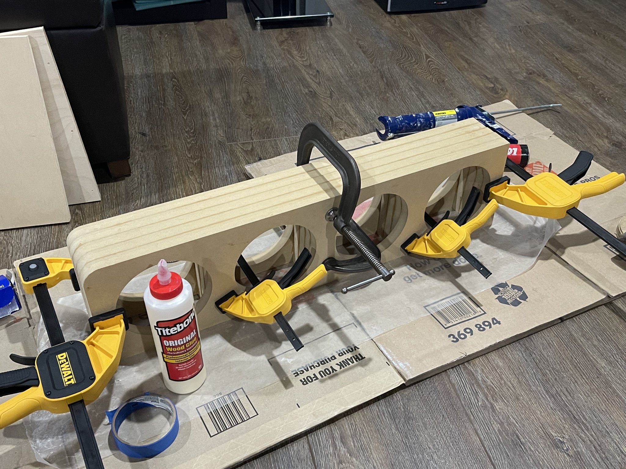

Starting to glue:
Looking good, buy yourself a glue roller you get a much more consistent layer of glue. I also like the silicone brushes used for basting, buy an extra for your wife or it will disappear. The people at Veneer Supplies are very nice to deal with for different supplies, pre-glued banding makes edge banding a snap and buy the veneer trimmer it will make life simpler. Nice flooring our house had tile in it when we bought it, went vInyl threw out so much easier to keep clean.
Thanks WW. I used a small flat paintbrush. The boards wiggle when clamped and that’s my bigger problem. So on next Rev I will definitely have 3 to 4 dowel alignment holes. Should make assembly a snap.

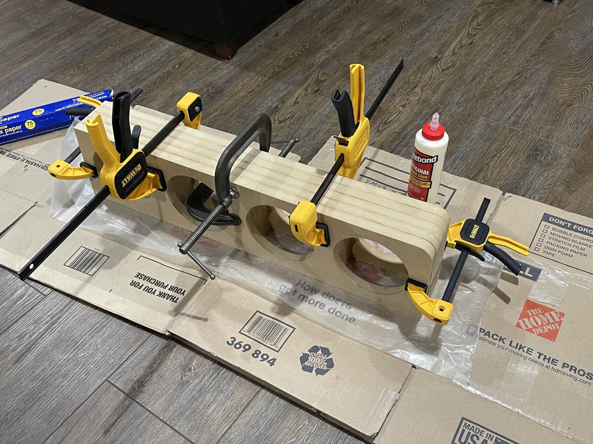

Once you have a solid woofer array block it serves as the backbone of the speaker and holds the baffle and base together. I’m going to use PL Premium glue to fill gaps and make an incredible bond. It’s looking good though. The CAD and CNC cuts are all perfect and angles coming out right.
Second bass array being glued. Experience has given me slightly better alignment but still not perfect. Dowel locator pins will make this a snap.

I did put dowel holes in mine, definitely stabilized glue up. Using glue roller made for no gaps as well, not such a thing as to many clamps. Be sure to dry fit woofers before glue up, saves fussing with them when assembled ( would have saved me a few hours). We grill outside 99 % of the time keeps kitchen cleaner. Since we only eat beef once a week we pay a little more for the good stuff and usually split a steak.

This is the first time I have glued up some thing that took this many clamps. I actually just bought these. I have only had the two C clamps up to now. But yes, one can never have too many clamps.
I only have 2 clamps as well. Also have some c clamps, but not large enough for this, so I need to go clamp shopping.
