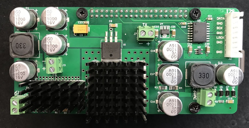

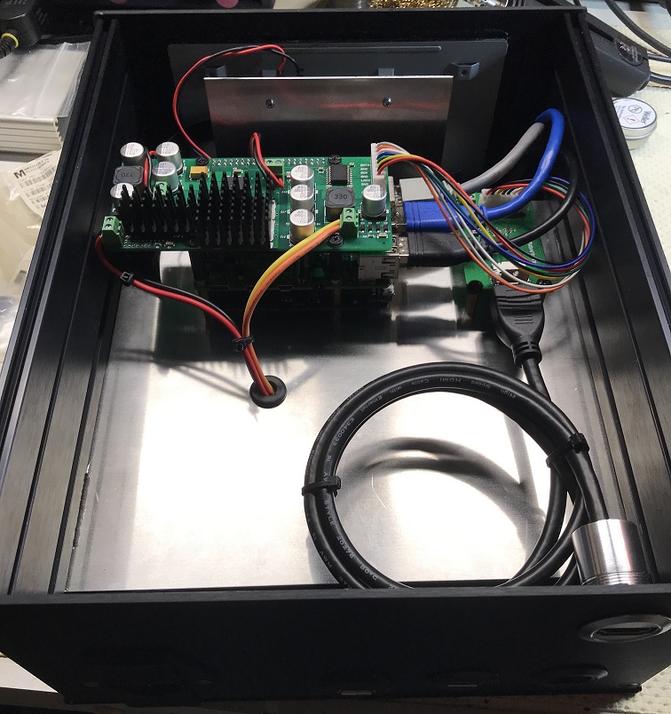

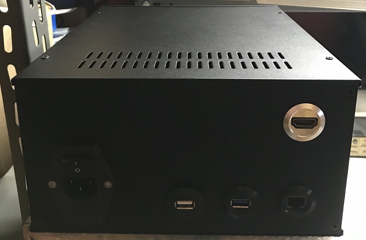

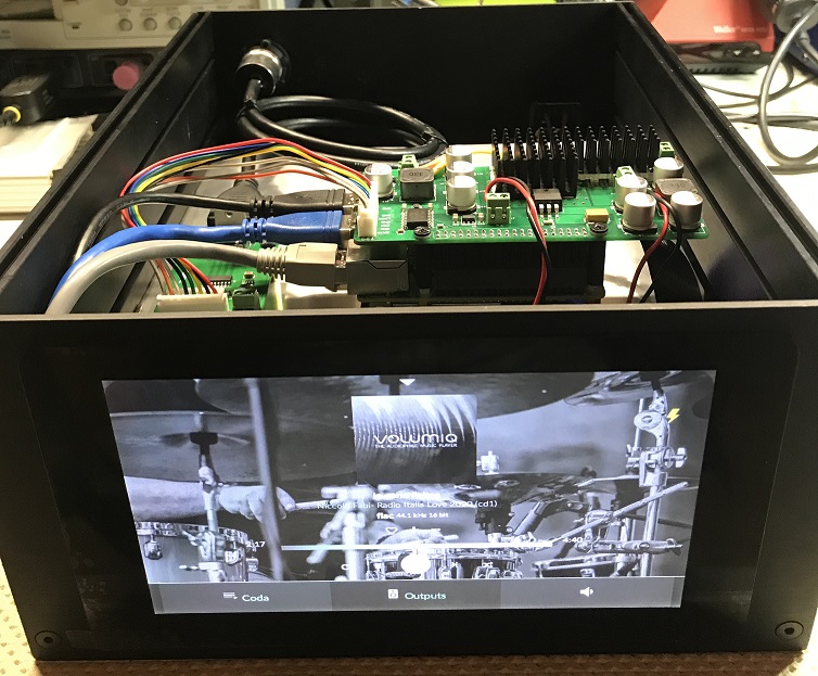

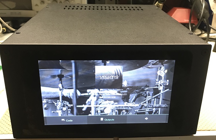

Raspberry PI standalone source
I attach some pictures of the RPI standalone source, it implements the TWSAFB-RPI power supply and I2S isolated output and the TWSAFB-TX I2S over HDMI LVDS transmitter.
The source is controlled by the touch screen, 1TB SSD has been installed to store the music.
