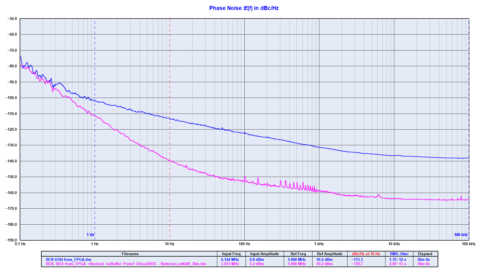

I attach some phase noise plots of the FIFO Lite:
- MCLK output
- BCK output (FIFO Lite + Reclocker)
- LRCK output
- Comparison (including the base DRIXO 24.576 MHz oscillator)

Theoretically yes, the DDDAC use the BCK as the crucial signal and if you look at the BCK phase noise plot you see -140dBc at 10 Hz and less than -110 dBc at 1 Hz from the carrier.
These are very good results, the best we have mesured until now.
Just a comparison between the BCK coming from the FPGA and the BCK after the reclocker.
The phase noise of the BCK signal directly from the FPGA is very poor, while after the recloker it's fine.

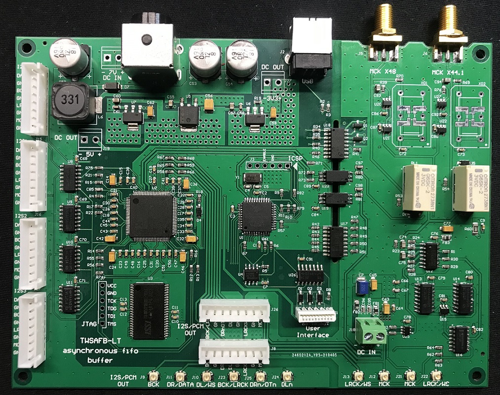

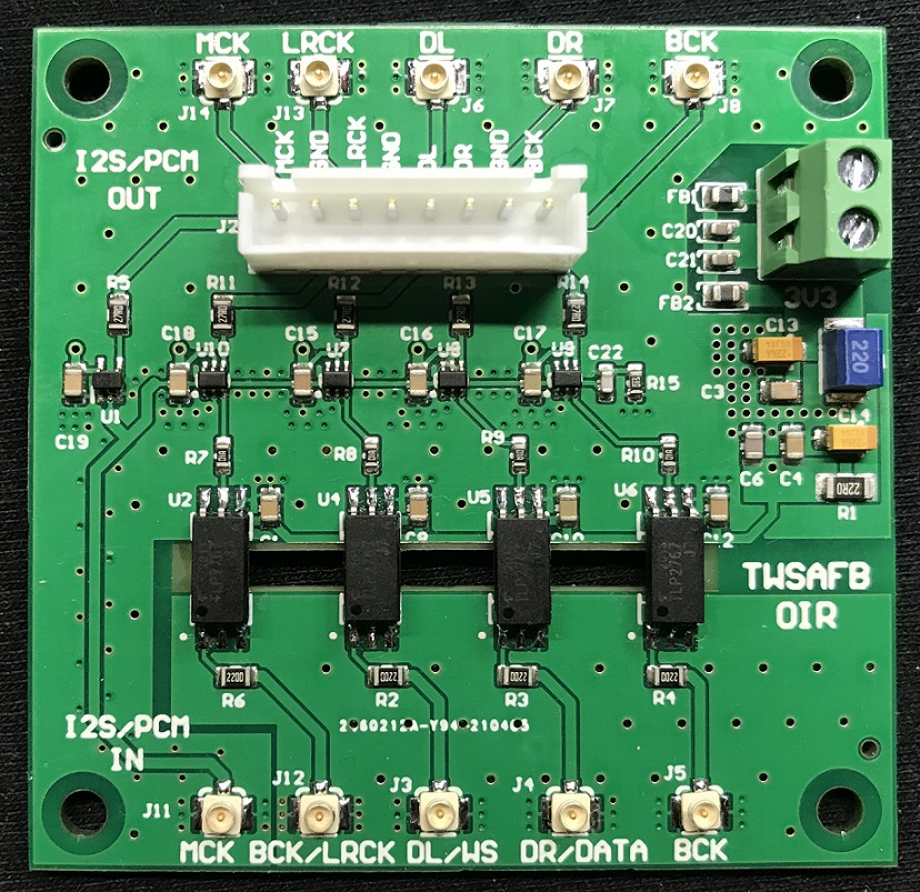

Latest revision, from left to right:
- TWSAFB-LT Fifo buffer Lite
- TWSAFB-OI optical output interface
- TWSAFB-OIR optical output interface & reclocker
We are testing the software, then we will test several DAC.
Great. TWSAFB-OIR is what I'm looking for. That is independent flip-flop for each signal. Did you add ferrite beads for each flip-flops? I wish they are at the bottom side.
There are no ferrite beads, only resistors at the input and at the output of the flip-flops to avoid reflection.

The TWSAFB-OIR is not not really an optical output, it's an optical isolation interface.
All the signals from the FIFO Lite come via copper and also the output connectors provided by the OIR have to be connected to coaxial cables.
Optical interface is very jittery.
The optical isolator are used to isolate the clean part which comes directly from the master clock from the dirty signals coming from the FPGA, to avoid any interference between the two domains.
Finally, the dirty signals are reclocked by the master clock after the isolators.
The TWSAFB-OIR has to be used only with DAC switching on the BCK, like the PCM1704 and the PCM1794.
The other DAC, where the most crucial signals are the LRCK or the MCK, don't need the OIR.
In these case you can use the TWSAFB-OI which isolates from the FPGA but it does not perform the reclock (not needed since the MCK and the LRCK come directly from the clean clock domain).
