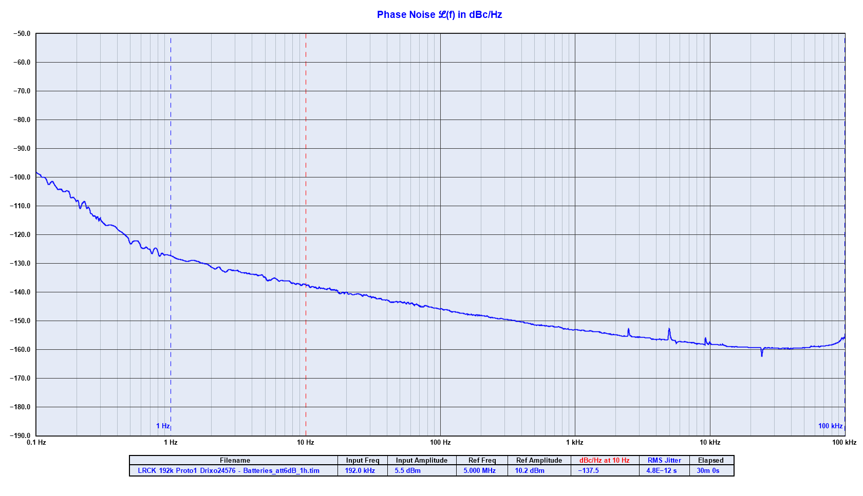

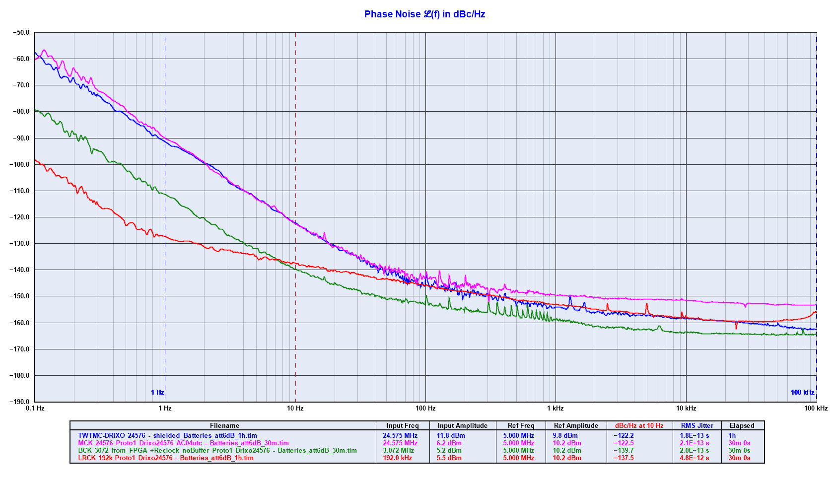

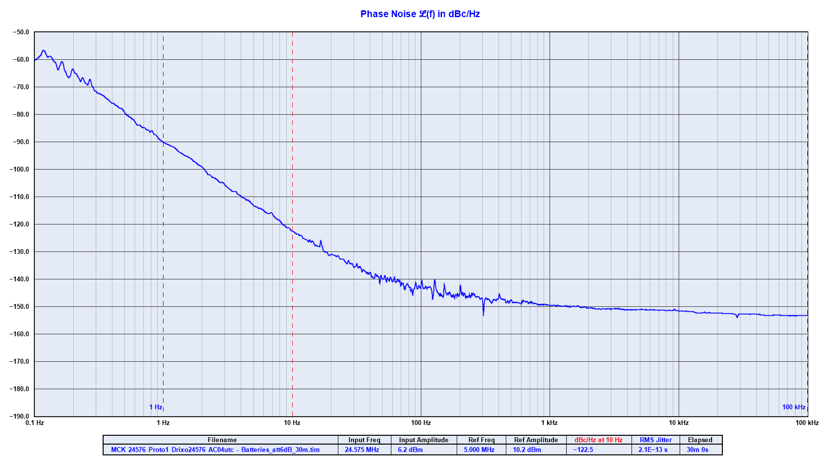

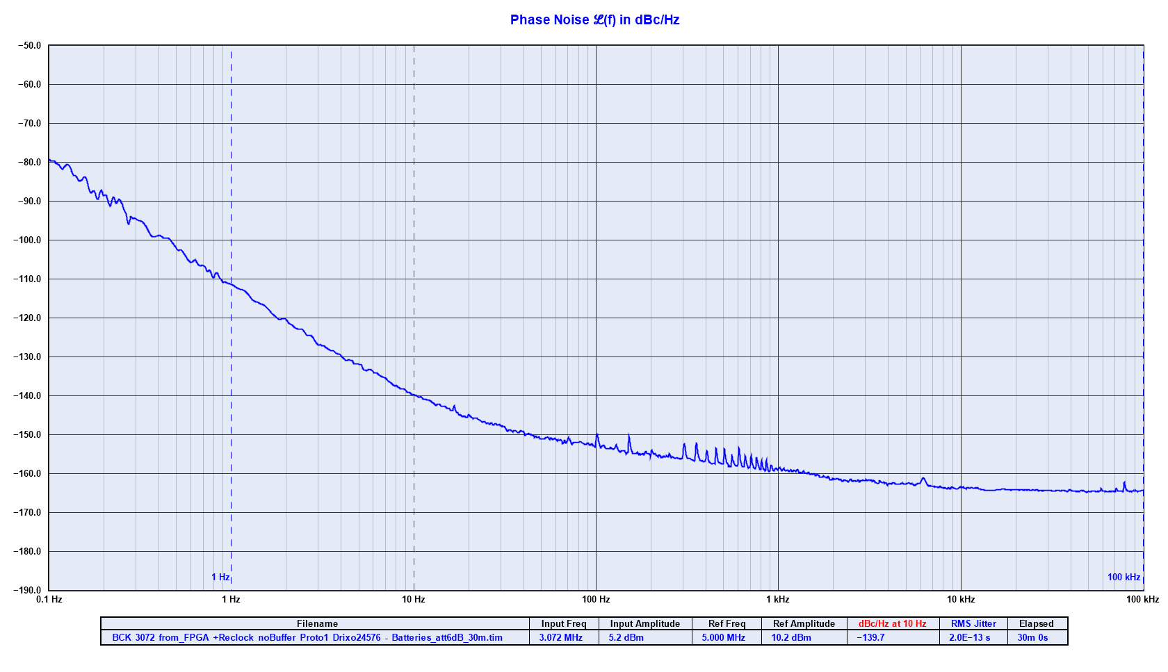

Preliminary measurements
I attach some phase noise plots of the FIFO Lite:
- MCLK output
- BCK output (FIFO Lite + Reclocker)
- LRCK output
- Comparison (including the base DRIXO 24.576 MHz oscillator)
