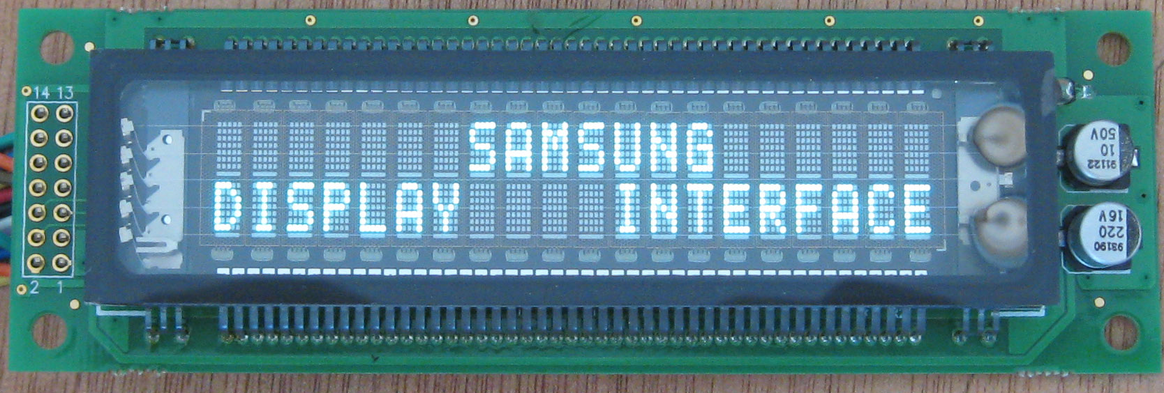

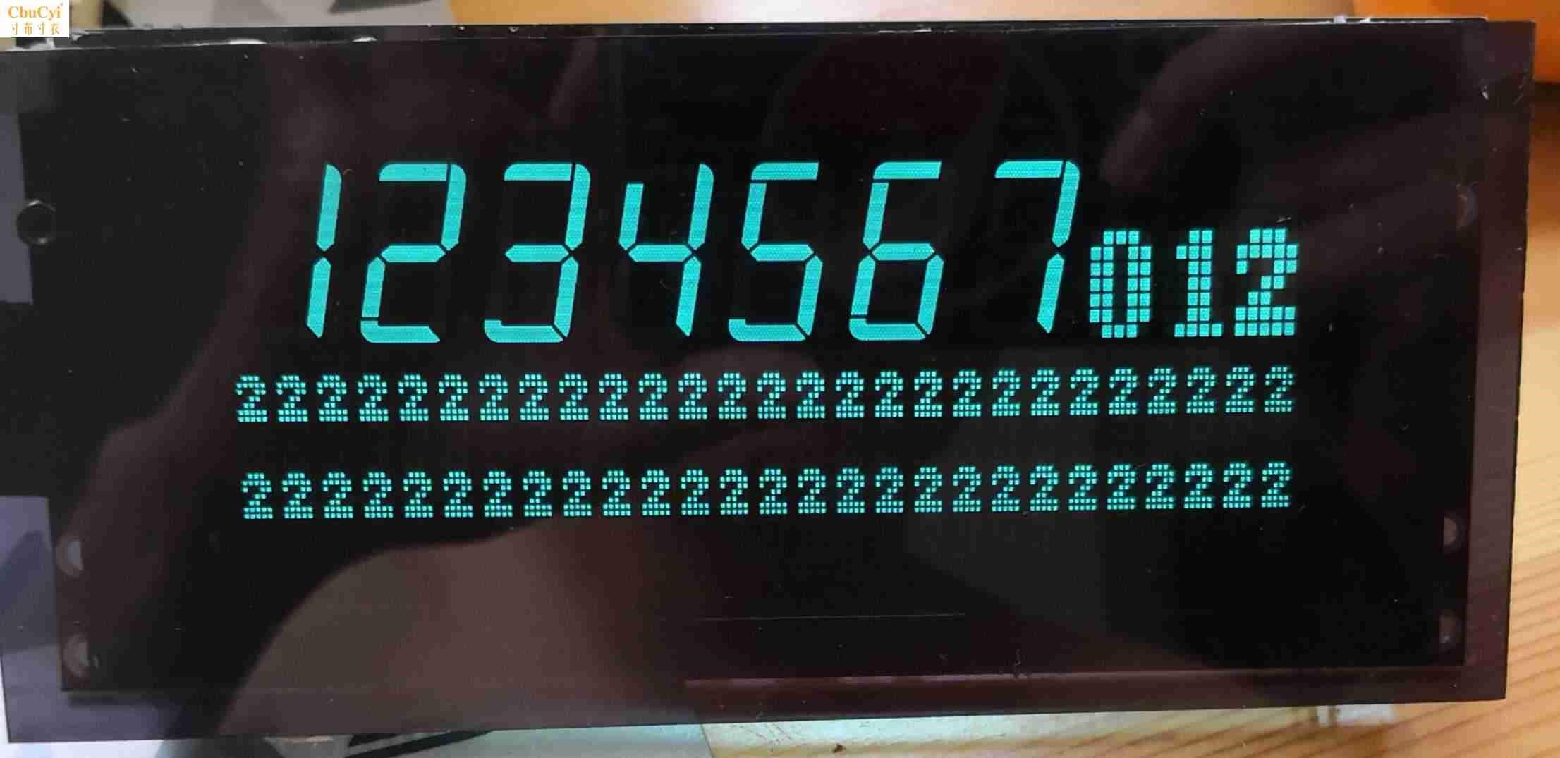

Forgot to say.
About the display. Can you consider OLED or LCD?
2 reasons.
1. A OLED display module can provide more information, makes UI more friendly. Sample rate, Input Source, Word Clock, etc. can be shown on the screen at the same time.
2. More importantly, a long square monitor like OLED is easier for DIYer to drill the hole and fixation is easier to.
For LED block, DIYer have to locate them precisely and make MORE square holes to fix the LED.
I would sincerely and strongly suggest you to consider OLED or even VFD module. OLED is not expensive, and provides much more advantages; Color TFT is also good, it can display information on differed colors.
Please, Please, think about OLED!!! Thank you 🙂

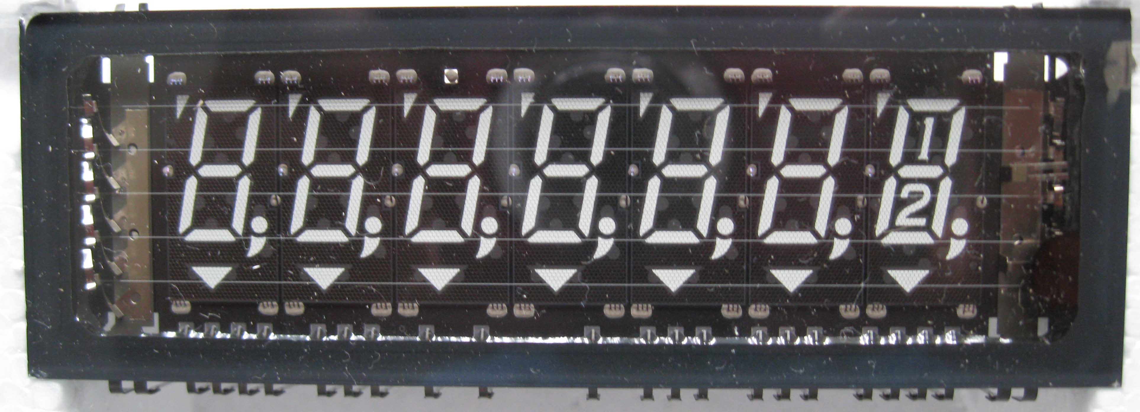

There are many inexpensive and good quality VFD ore OLED monitor on market.
Samsung and Japanese Noritake have quite nice VFD, using SPI or serial protocol.
It would really really be awesome if the monitor is OLED/VFD.

Sorry but an OLED display needs RF to work and we would avoid any interference from other devices, so we cannot implement such user interface.
During the listening the MCU is in stand by mode to avoid any RF generation, the display are refreshed only if a parameter changes (sample rate, dithering).
This way doesn't work with OLED display.

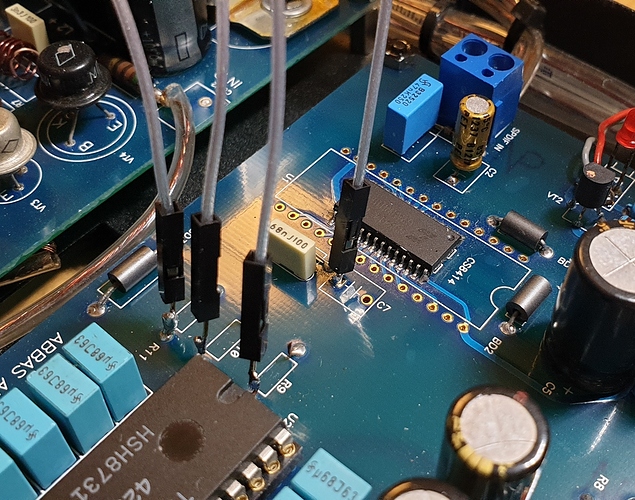

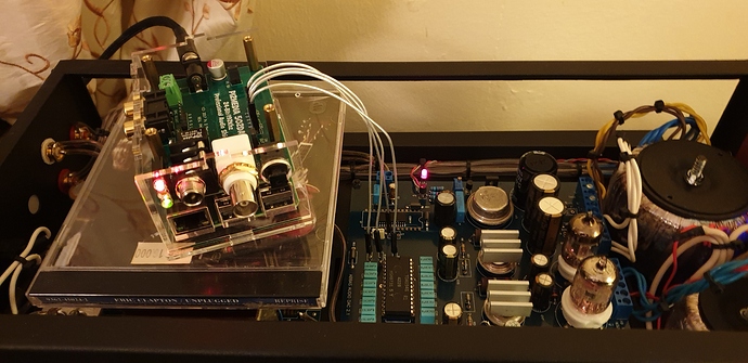

Hi Andrea and Zoran!,
Since my last post I have been investigating about Andrea´s suggestion.
Actually these 3 jumpers next to the TDA socket (R9, R10, R11) are the incoming I2S signals from the CS8414 (fantastic intuition Andrea!!). I have found a diyer at dastereo.ru who has already carried out this mod. Just look at the first attached picture.
What can be seen in the picture are the I2S output lines coming from Pi2Design 502DAC as well as Allo Kali reclocker (pictures 2 and 3). I have compared the photos with the kali pinout and 3 front lines pin connections corresponds to BCLK (pin12) + LRCLK (pin 35) + DATA (pin40) and GND(pin39) is the back line. MCLK is not used.
As no further tweaks are performed, I assume that input data format must be I2S – MUX TWC and not OB, am I right? If that´s the case, one first mod could be, as Andrea suggested, just cutting these the jumpers and connect the direct I2S signals as in the first photo.
What I have thought is installing Andrea´s FIFO inside Abbas DAC and connecting:
1. FIFO output to the right side of the jumper (soldered).
2. Left side of the jumper (CS8414 I2S output) to a free FIFO input. Input #4 would be better as I should need a shorter connection. Doing so, I could keep full DAC functionality!
3. External I2S signal coming from my digital audio transport to a free FIFO input. Input #1.
4. FIFO psu would be probably installed inside Abbas DAC as well.
5. FIFO Master Clocks (Driscolls 5/6) and FDs would be in a separate box, connected via SMA cable.
However, I have many doubts that makes me feel unsure about final result. For example. Abbas DAC implements a quite unique tube DEM clock for the TDA and I don´t know if this could affect to the mod or DEM performance. I think that it does not but I am not sure.
As Zoran suggests, going to simultaneous mode would double the max SR, and I could get 384kbps but I am not sure wether the whole DAC design would benefit from this SR. Actually, there is no jumper for pin4 and I should probably mod pin27 as well. My “high-SR days” passed away and I really think that “going slow” can be the way to get best SQ. DAC sounds so beautifully now that I am really scared to ruin its magic lifeness. I would never consider modding it If I didn´t think that the Andrea´s products line is truly SOTA and could take the most out of my DAC. Probably Zoran mod would be the way even keeping 96khz SR, but it is more complicated and uncertain, so I am not at all sure of what to do. I have attached a photo of my beloved DAC (ugraded v3.1: pic #4).
Although it seems feasible, it is probably beyond my hand soldering skills, but I could ask for help and do the trick. I will contact Mr. Abbas as well before doing anything.
What do you think guys?? Thank you very much in advance!!!

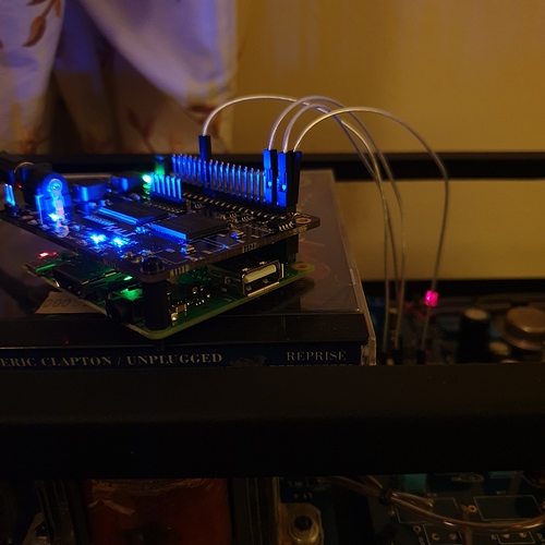

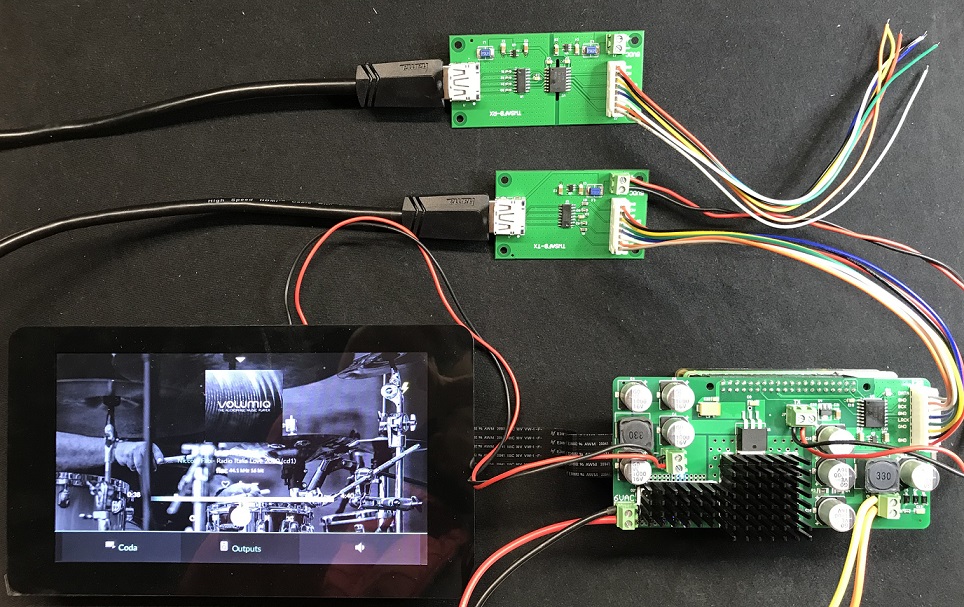

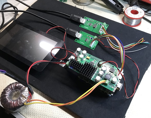

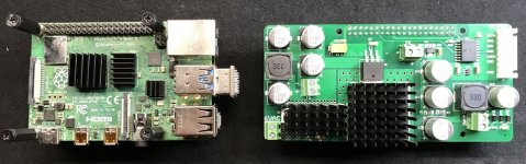

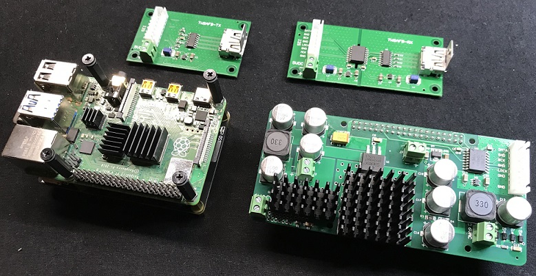

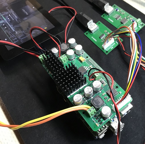

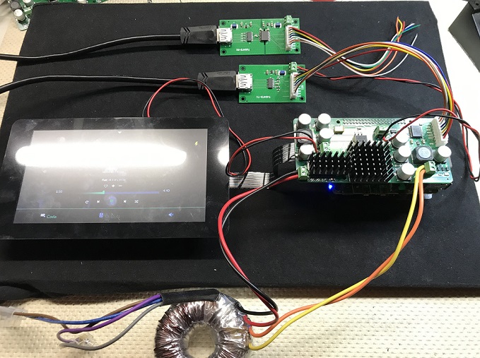

Since we are planning to implement a Raspberry as a standalone source for our audio system, we have developed a few boards to interface it with our new FIFO.
The source includes the Raspberry PI, the 7" touch screen and an expansion boards to connect a SSD.

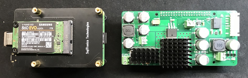

The SSD expansion board is stacked under the RPI.

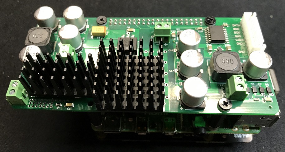

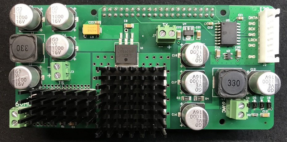

The first board (TWSAFB-RPI) is an interface to the Raspberry and it's stacked onto the RPI. It provides power supply for the RPI and the Touch screen, and also a rail to supply the I2S transmitter. The I2S output is isolated from the Raspberry.

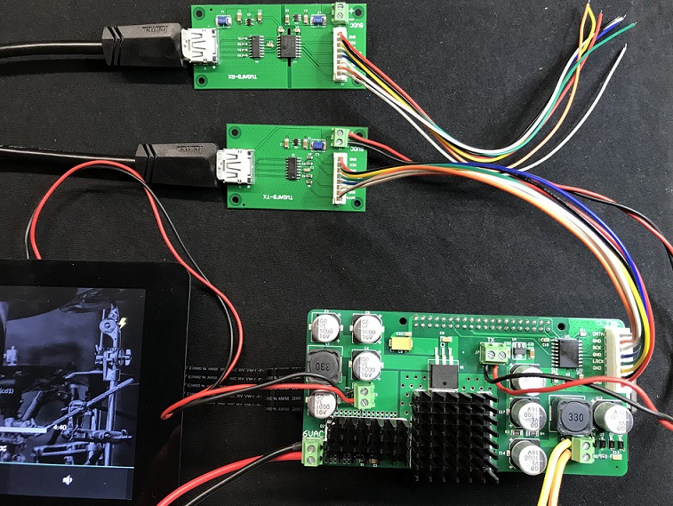

The second board (TWSAFB-TX) is the I2S LVDS transmitter powered by the TWSAFB-RPI.
The third board (TWSAFB-RX) is the I2S LVDS receiver to be placed far from the Raspberry and close to the FIFO. Its I2S output is isolated from the trasmitter to avoid any EMI/RFI interference. The input part of the receiver is powered by the transmitter, while the isolated output has to be powered by the FIFO.
An ordinary HDMI cable is used to connect the transmitter to the receiver.
The Raspberry power supply and interface board TWSAFB-RPI is ready and tested succesfully.
I attach a few pictures with the whole parts of the standalone RPI source.
